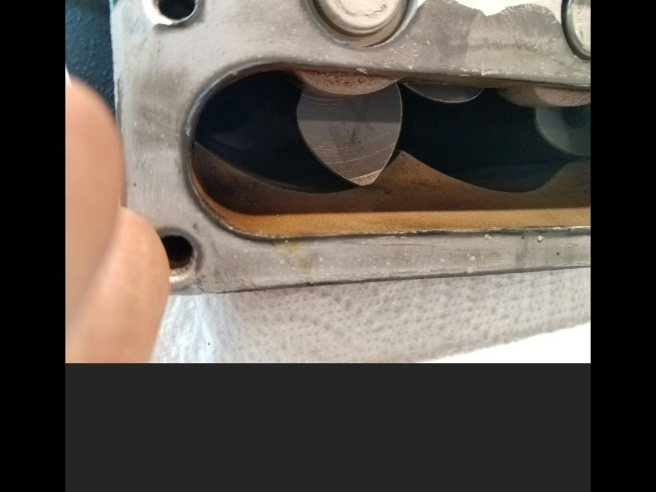

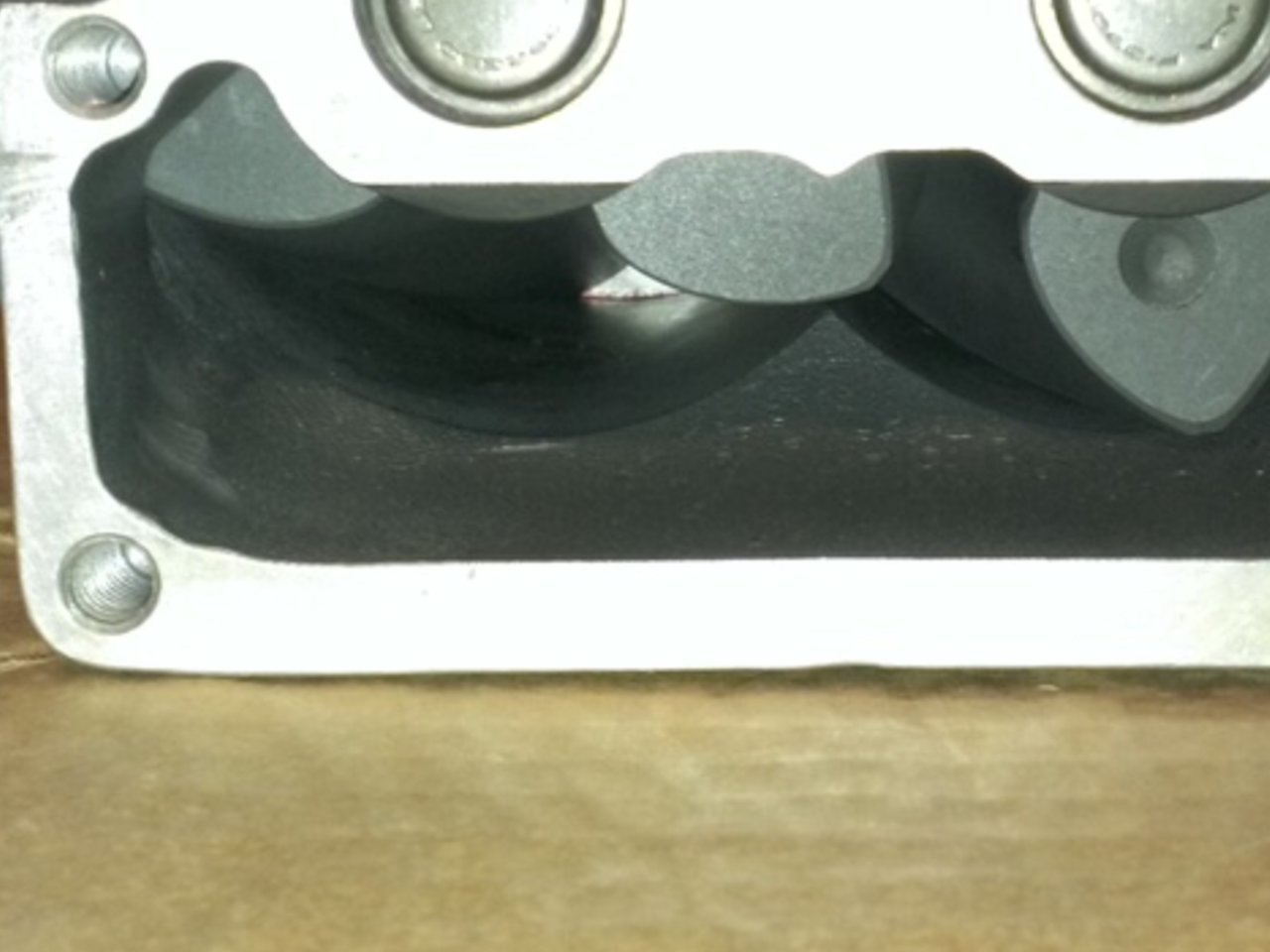

    Holy cow he really opened that sucker up.

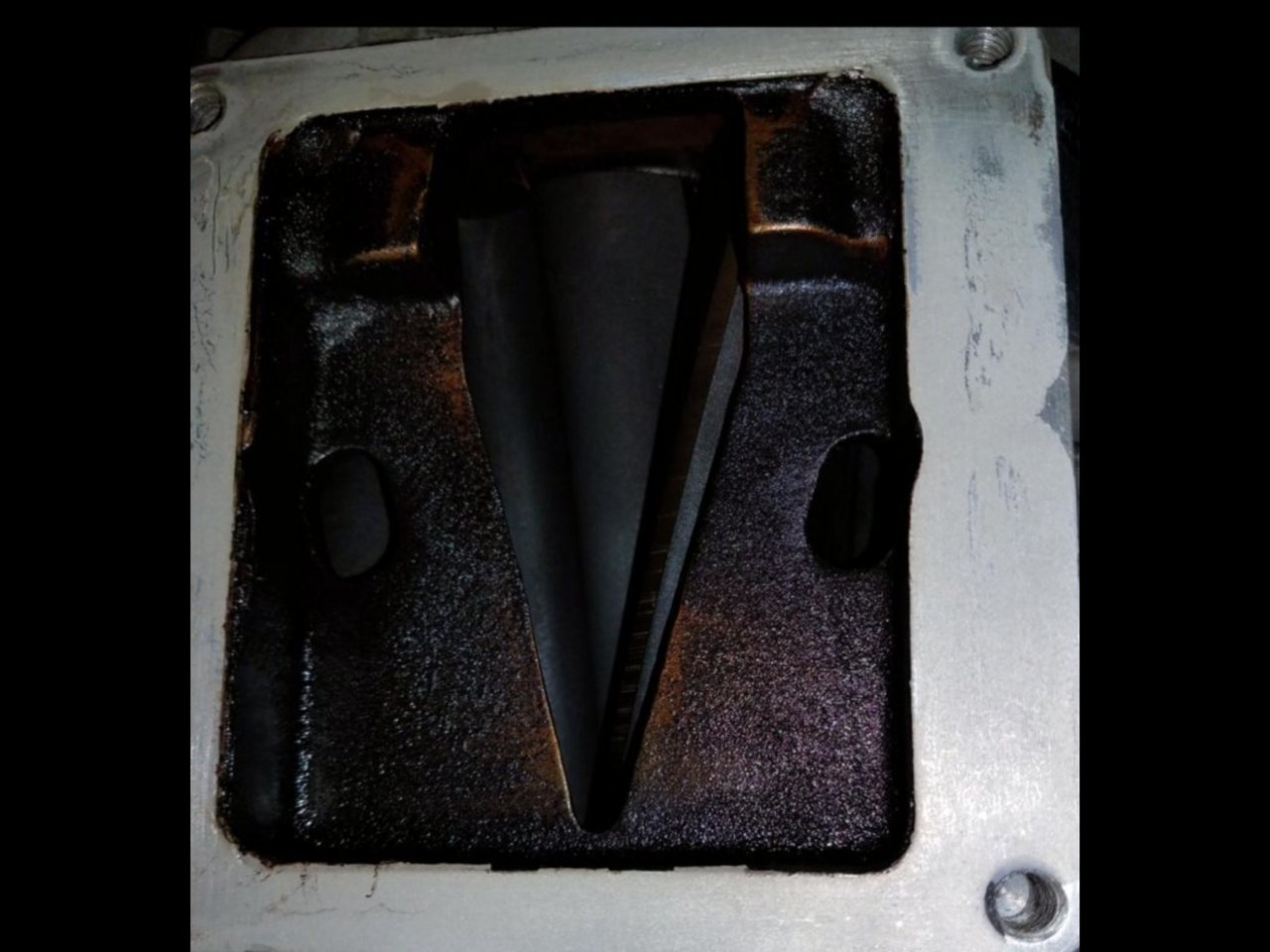

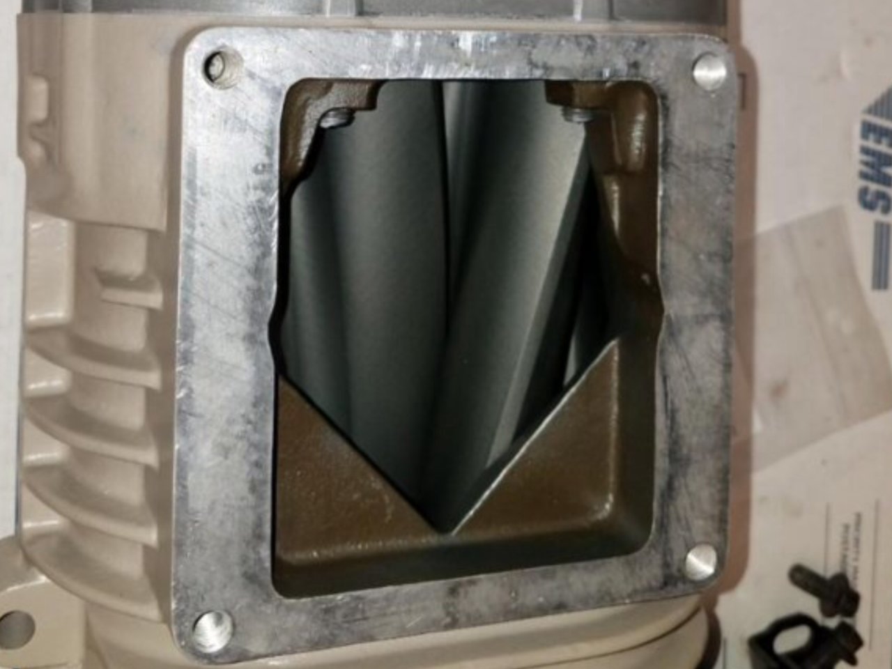

    The other side the same.
    Before and after

    Yes, he did alright. Any hp gain estimates they give?

    There are lots of factors to consider. Altitude, engine size, pulley size, if you have an inner cooler etc.
    I will have a dyno to see for myself next week to know exactly.
    It’s not huge but definitely a big difference for me I can feel. Like I said if you can get more timing and
    less heat you are ahead of the game and less air restriction with more air.
    The top end definitely is a big game changer in more power for me. That’s were I feel the biggest difference.
    I run neck and neck with a ford raptor and now I can pull away from one easily going up a long 8 degrees mountain highway at 8000 feet here in Colorado
    For whatever that’s worth:)

    Those are impressive porting results. Noted- on my list.

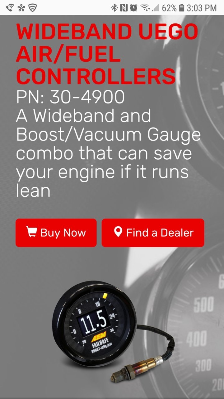

    You also can get a combo guage for AFR and BOOST, VACUUM. This way you always will know your
    air fuel ratios.
    If you run too rich or too lean your cats WILL DEFINITELY
    burn up. FYI AND THAT will be expensive, especially if your truck has 2 cats as mine has 1 and it’s the original cat still
