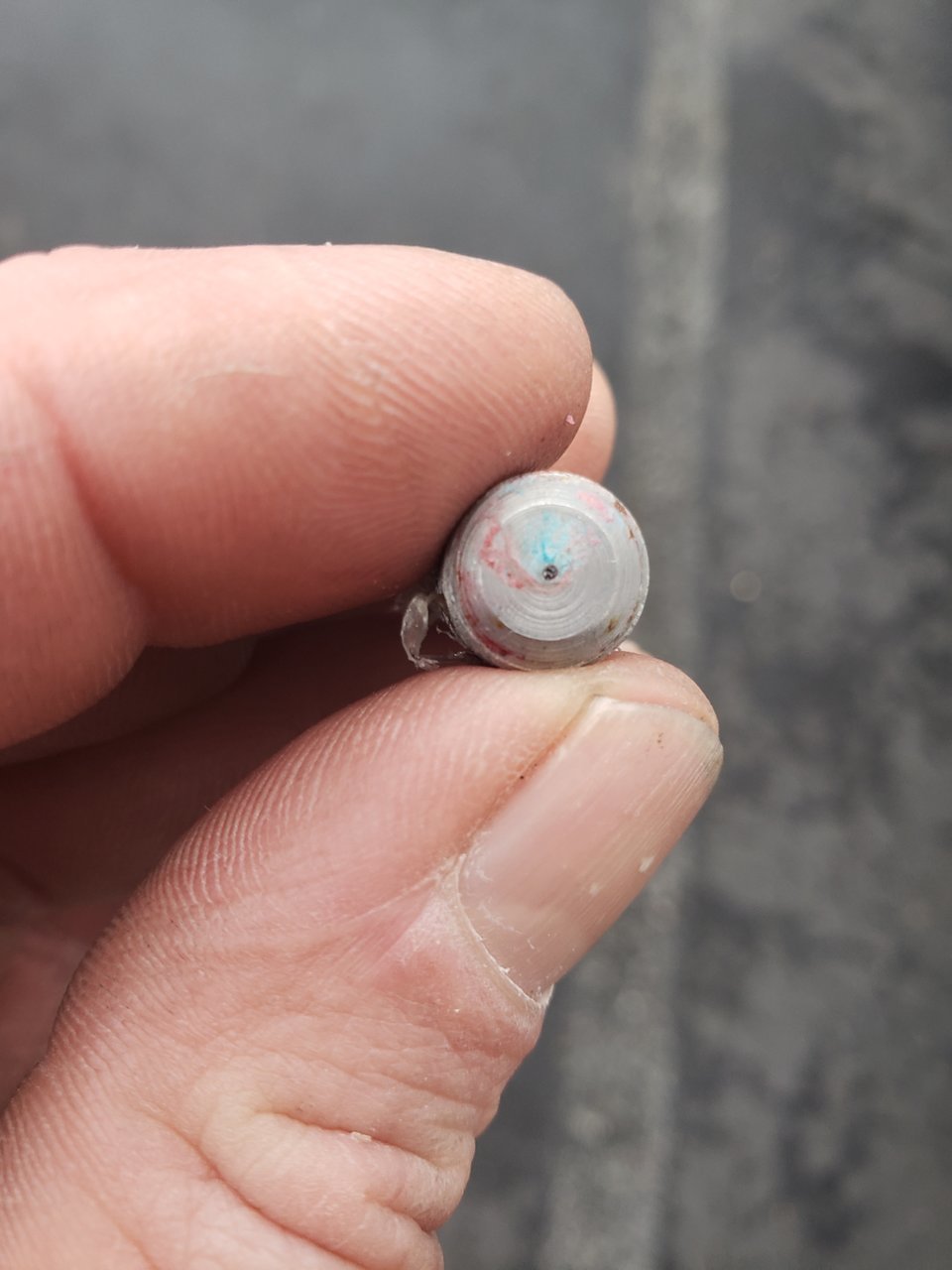

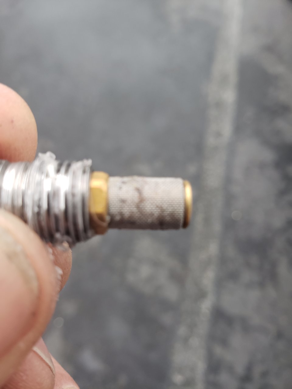

    This is 8 months of use. I'm going to clean mine every 6 months. 20181219_141434.jpg

    Have an approximation on mileage?

    Lift, pedal commander, led foglights, led interior lights, led back ups, led under lighting, urd tcai, led headlights, methanol injection, 76mm tb, hood struts, dif breather mod, ratiotek trans kit, x-series gauges, true cool trans cooler, belt wrap mod, 2.8 pulley
    10k I drive a lot.
