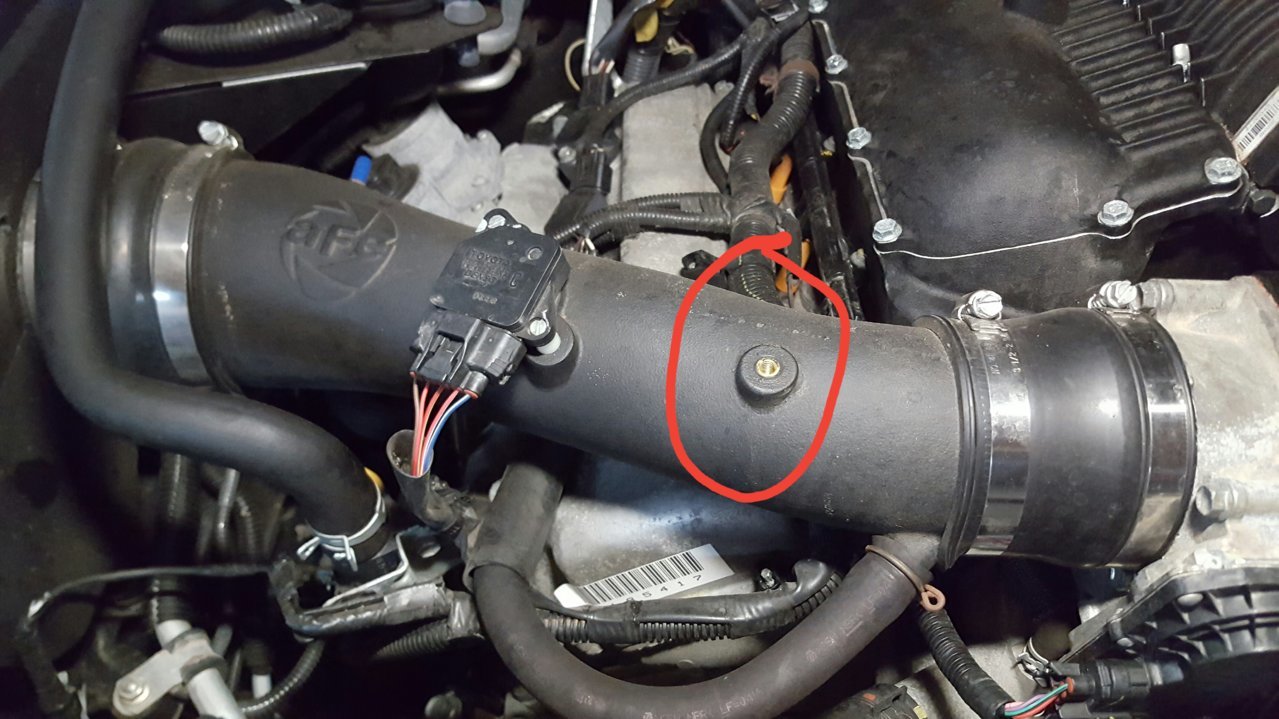

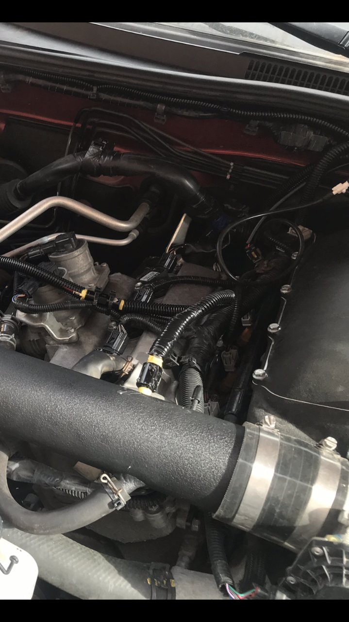

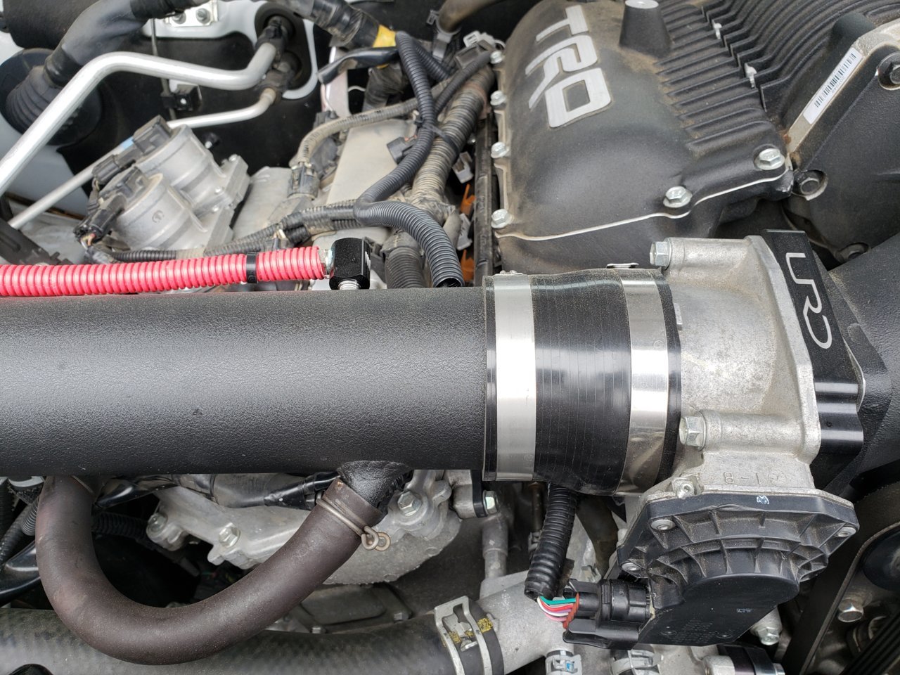

    @rjbiii what intake do you have and where did you mount the nozzle?

    Urd for now. May get the afe to see if that's the culprit for the glitches. Part of the reason I switched to the washer reservoir. I'm a little nervous about how flimsy the tank is where we tapped it. I used a lot of glue. Cut the hole perfectly, probably wouldn't leak without it. I just changed to a #5 nozzle too.

    Sorry. Just saw this question wasn't directed at me.

    thanks for the pics anyway. I knew you had URD intake.
    I have AFE and there's an unused mounting location for a bracket or something. I'll get a pic.

    This fitting could be removed and made into nozzle location if they can be mounted from this position

    I saw that! My reason for wanting it! Great spot for a meth nozzle!

    Its probably for the now useless engine cover.

    Do I need to get an aluminum bung to weld to urd intake for nozzle?

    I just tapped the pipe. Seems to work fine. Call me cheap but I thought 30$ for a bung was too much.

    If I wanted I could get an aluminum washer and tap it. Then tack weld it in.

    Yeah I’ll try that first.

    -27 1/8" npt thread if you tap it.

    Urd intake and i mounted the nozzle right by the fuel pressure regulator vacuum hose fitting thats on the intake piping
    I also tapped mine. 1/8" NPT like @White lightning boosted mentioned.
