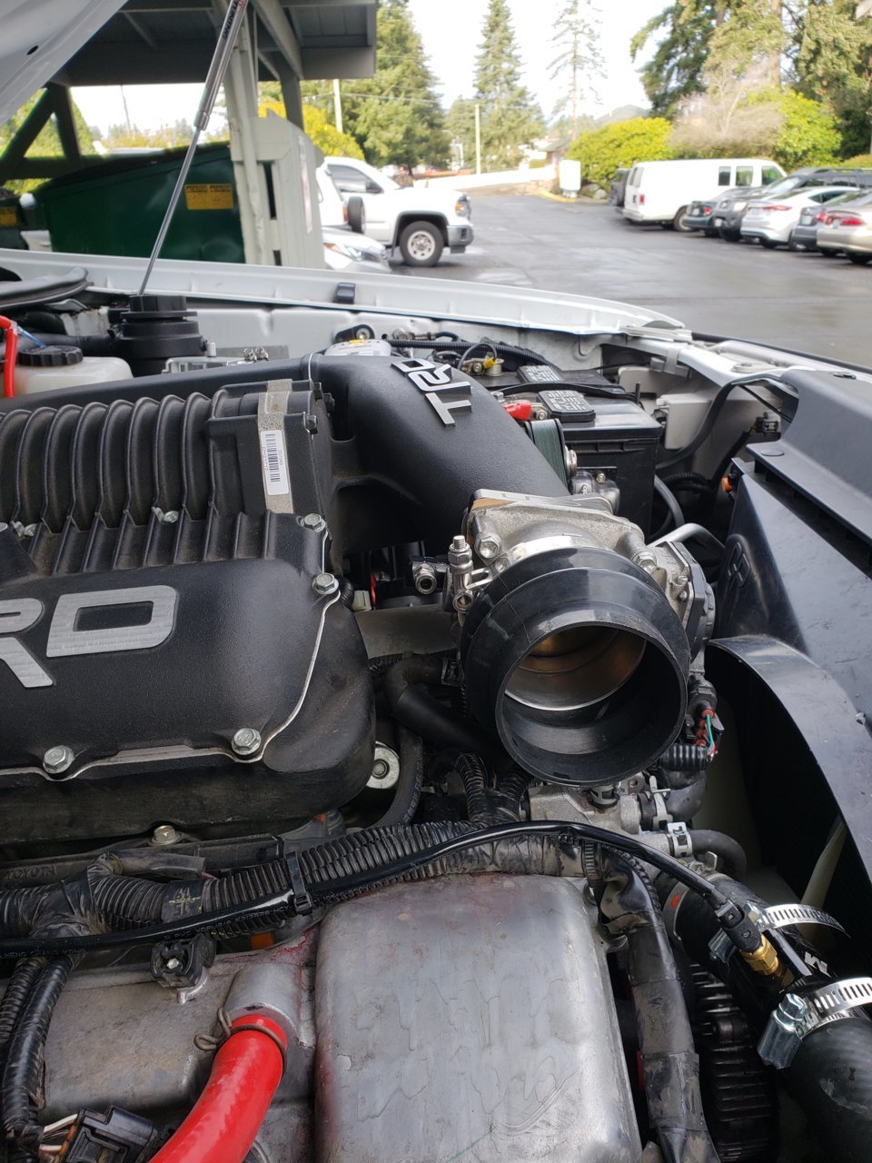

    It can be done folks. Used my urd adapter for a meth nozzle plate. Yes, I used my kitchen countertop as a work station. 20190104_210954.jpg

    Nice job. Looks like a clean install. Any pros or cons for moving the nozzle after the TB and farther downstream?

    Well, I think it looks cleaner. Should atomize just fine in either place. I did have some residue to clean out of the tb. Nothing ghastly but I figured this will be less maintenance. I was going to tap the afe at the engine cover stud location but didnt like how it looked inside. Opted not to. I think it's fine either way. Methanol companies would insist on selling you a meth plate if it was necessary.

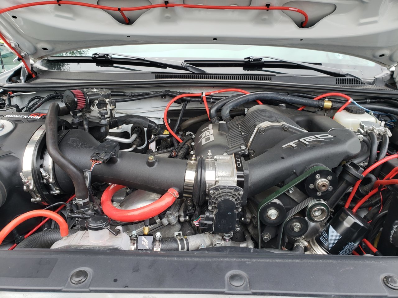

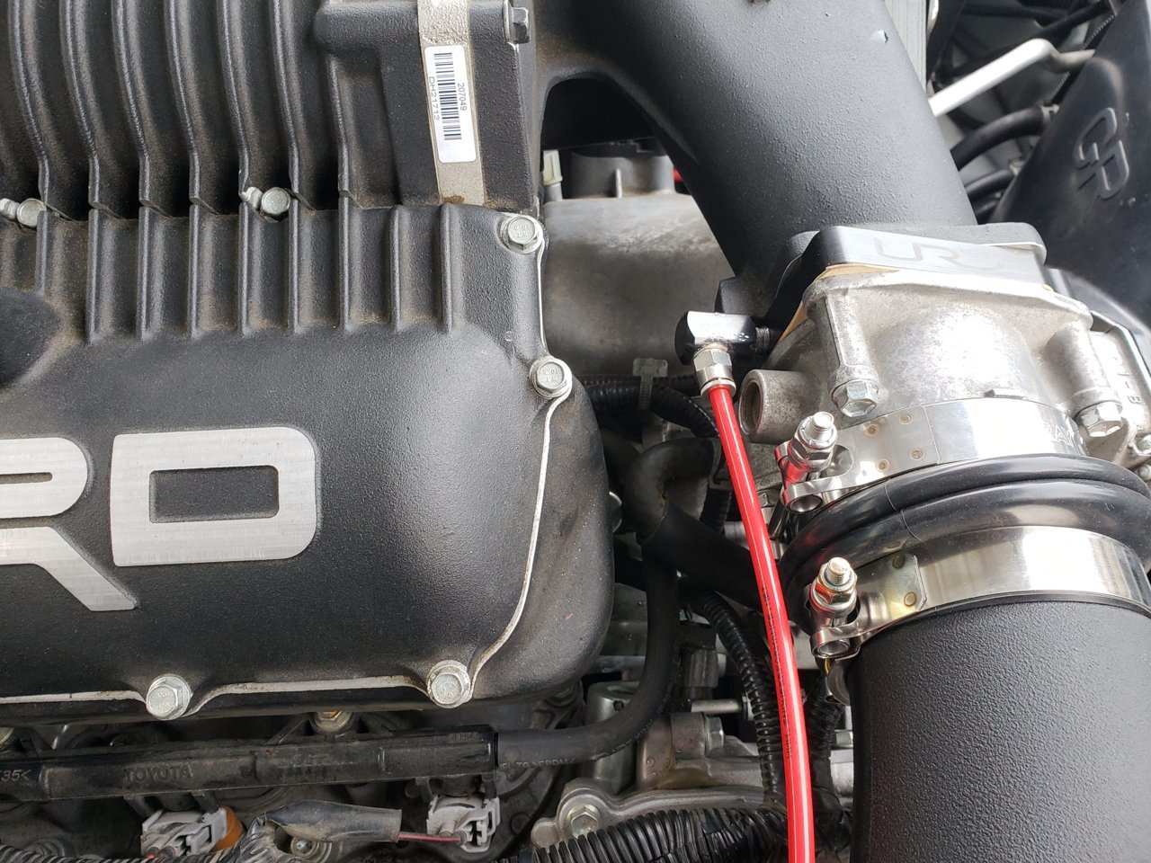

    Just a short neighborhood test. #s look a little richer, which I dont mind. 2.5 pulley at almost sea level is pushing it. Quieter. I'll know more with some harder runs and when the rain returns tmrw. See if the wet weather hiccups go away.

    Oh. And a leak at my nozzle mount. I broke the seal where the nozzle meets the 90* I should have known better and re-glued it.
