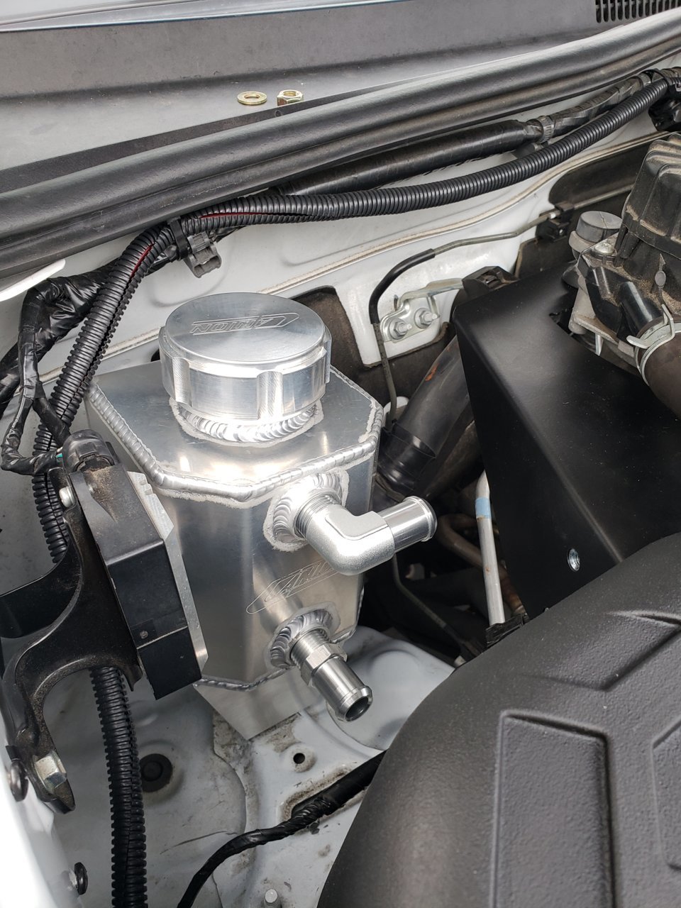

    I screwed up. Didnt check clearance on the meth housing. Its binding on the s/c housing. Hope just a partial rotation clears it.i chose the thinnest spot on the adapter to drill. Should have checked this too. Oops. Probably why my native name is Does three tries.20190105_145652.jpg

    Oh. That. Easy. Just take the intake tube off. Not the best set up. You can get to it with it in place but it sucks.

    Um..... shit. Better look into that.

    Due to being post-throttle body?

    Correct.

    Um yeah. I'll have to look into that. Hope I'm not screwed. Might have to plug the system. Doing a drive test now to see if it uses any in normal non boosted driving.

    You want the reservoir as high as possible. It should be the highest part in the system. It looks bitchen though!

    Hm. Sorry man, that should have occurred to me when you posted yesterday.

    Agreed. I'm going to bring it up a couple inches.

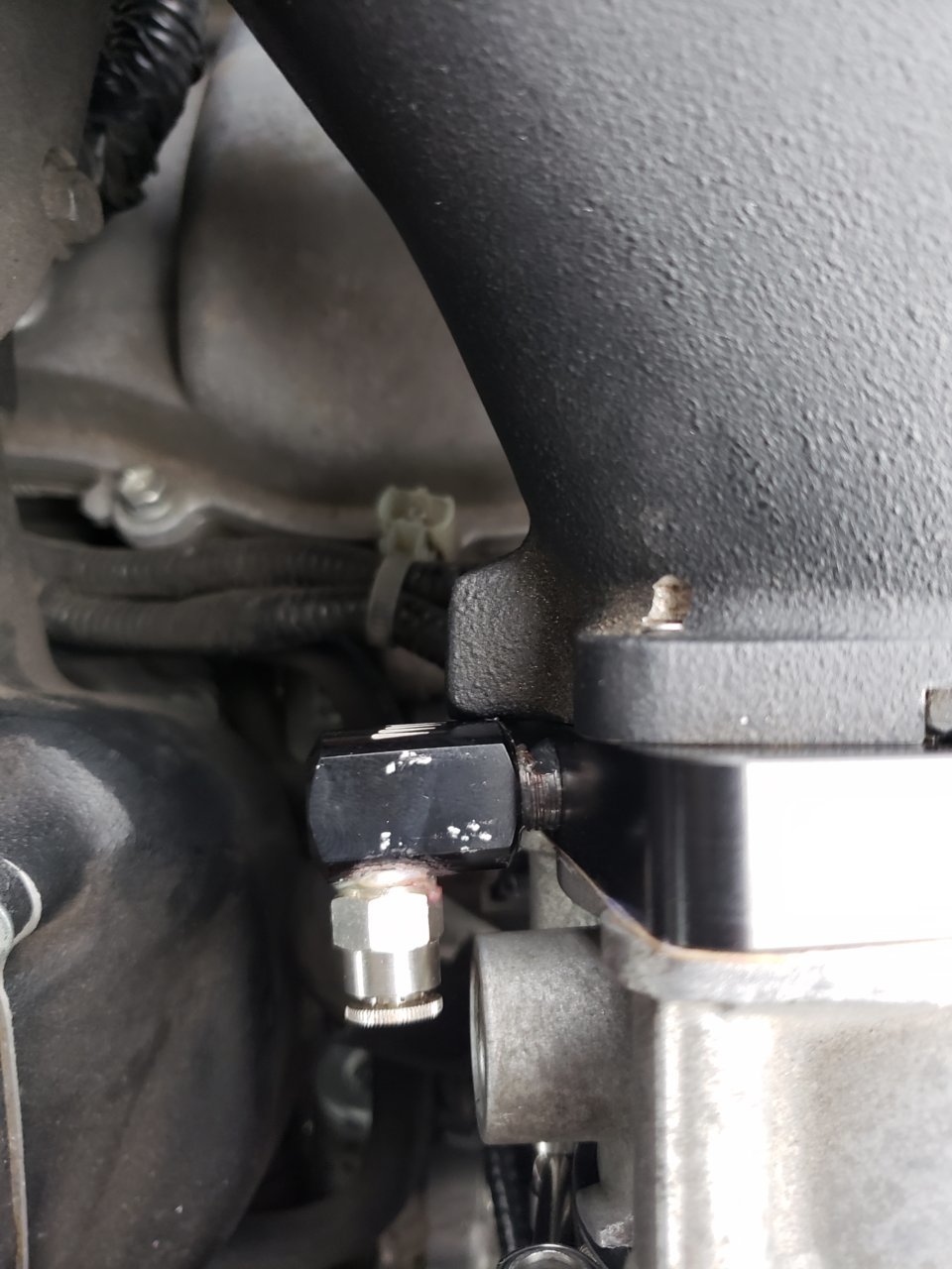

    Found a solenoid. They wouldn't sell it though. Pulling the fuse until I get parts.

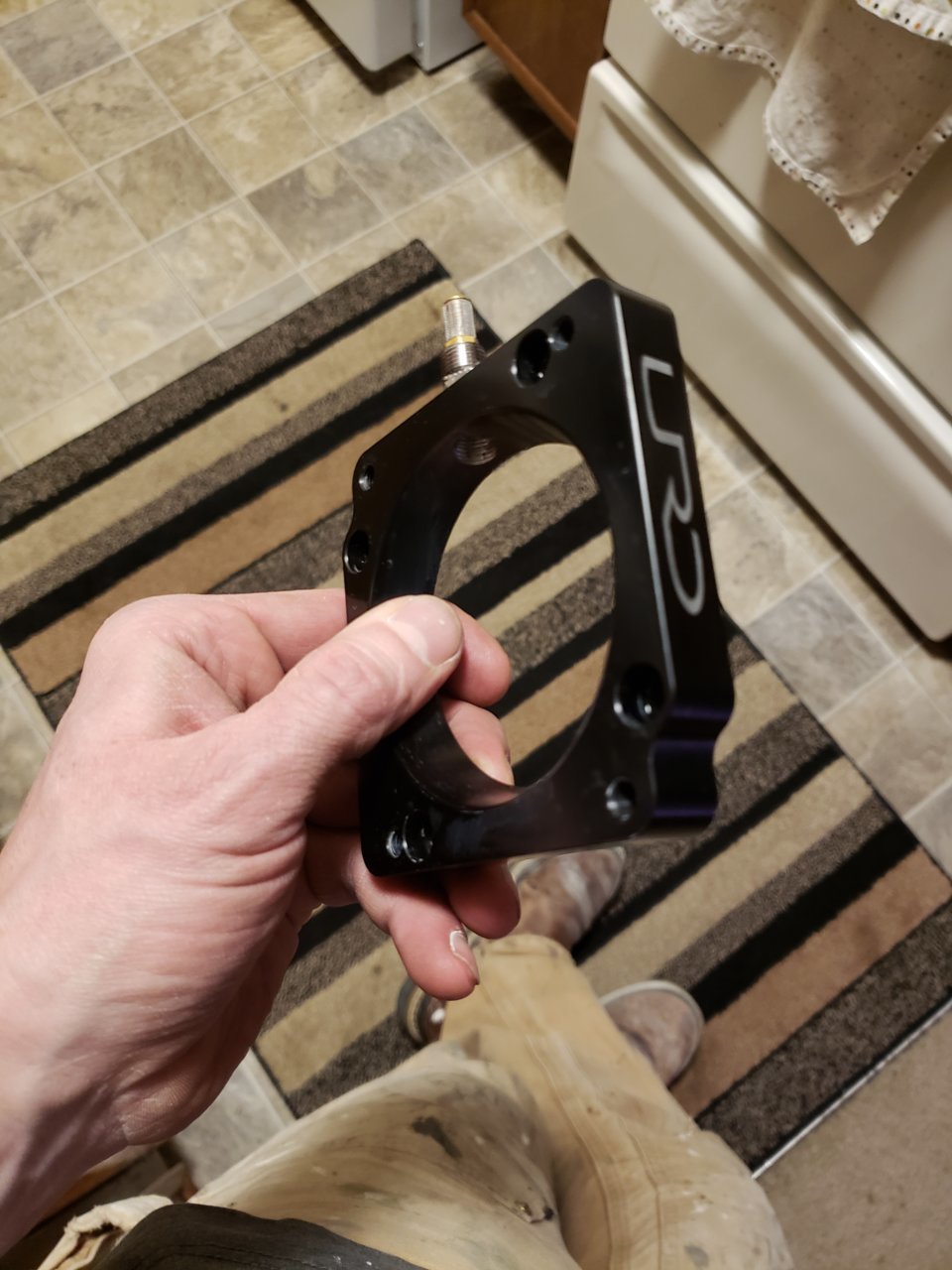

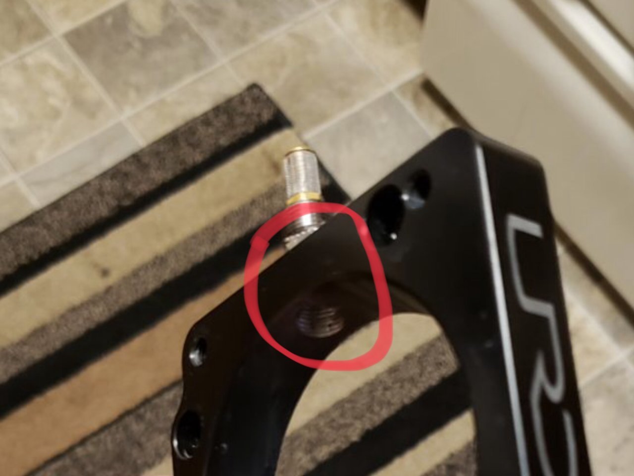

    I like this idea but,
    Have you run a test spray with the URD adapter out and not in the system to see the spray pattern?
    The nozzle looks like it’s setback pretty far in the screw hole and the spray might get knocked down by the side walls.
    I’m wondering if the inside section of the hole should be drilled out So the spray is not potentially
    knocked down into droplets or a stream
    Just my thoughts

    I agree. I was concerned with it but didnt know how to solve that. Bitch of an angle to get a drill there. Any ideas? This was what I'm about to buy. Hope it's what I need.Screenshot_20190105-175540_Samsung Internet.jpg

    To be honest if it was my setup I would take that adapter to a machine shop and have the whole section
    bored out as much as possible leaving 3/8” of thread for the nozzle to bit into

    I would be the machinist:) shopping for the correct extension to make that possible. My 90* housing will only allow it so deep.

    I think you have to figure a way to get the nozzle flush with the inside wall of the adapter or the spray
    will end up being a stream and not a mist,
    Maybe countersink a hole instead in the adapter for the nozzle to be flush on the inside wall

    I'll see how close I can get. Plate is only 9/16" wide. I'll give it a go tmrw.

    I just switched my injector setup on my intake to a low profile injector and tube nut adapter instead
    of just a threaded intake section and you can see the nozzle tip is almost flush with
    the nut holder
