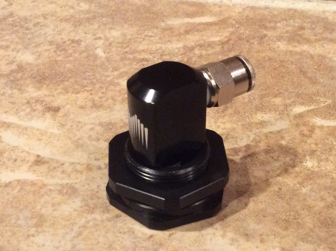

    I did have one of those. I sold it though. I was a little iffy with how much of an obstruction it made in the intake. Definitely simpler than what I'm committed to:)

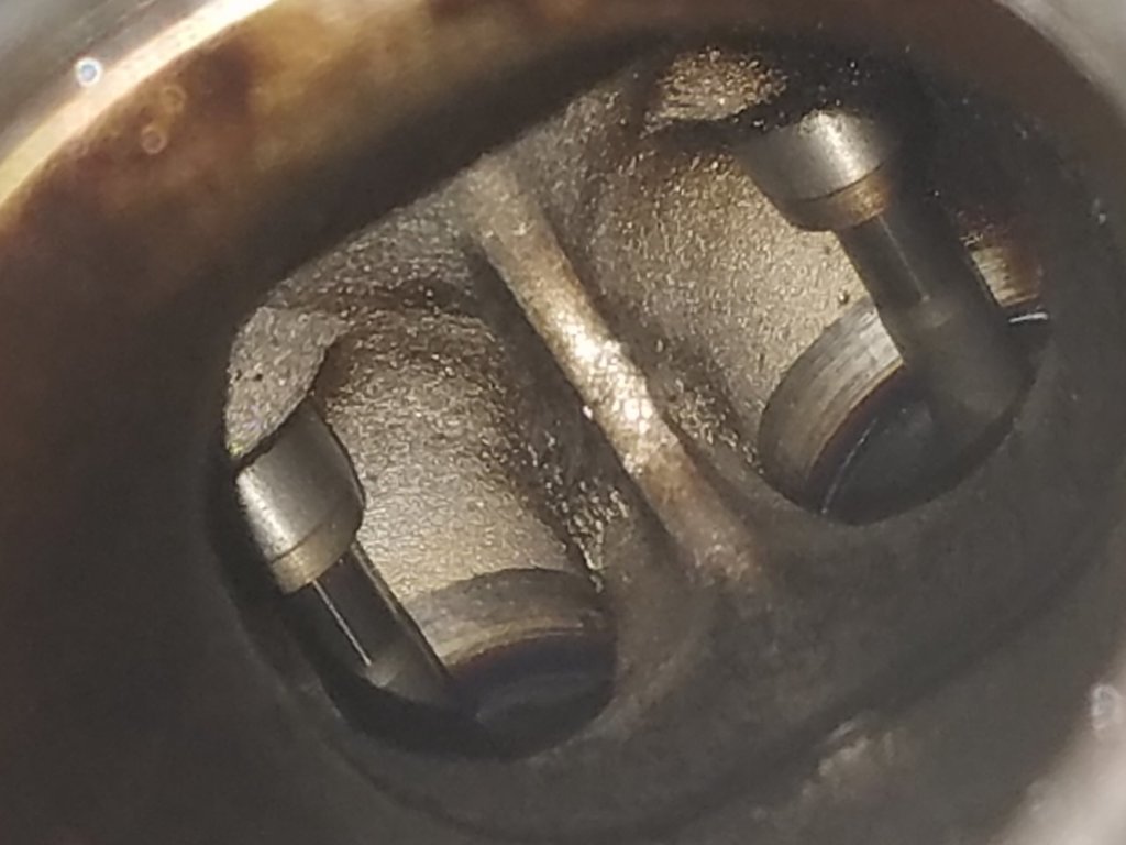

    1997tacomav6 V6 5sp,RegCab,TVS1320 Supercharger,Haltech, 800k
    Oct 5, 2013
    #113940
    10,367
    John
    Denver
    97 reg cab, v6 5sp 300hp supercharged, Methonal Injection, 800,001 plus miles, Original Owner

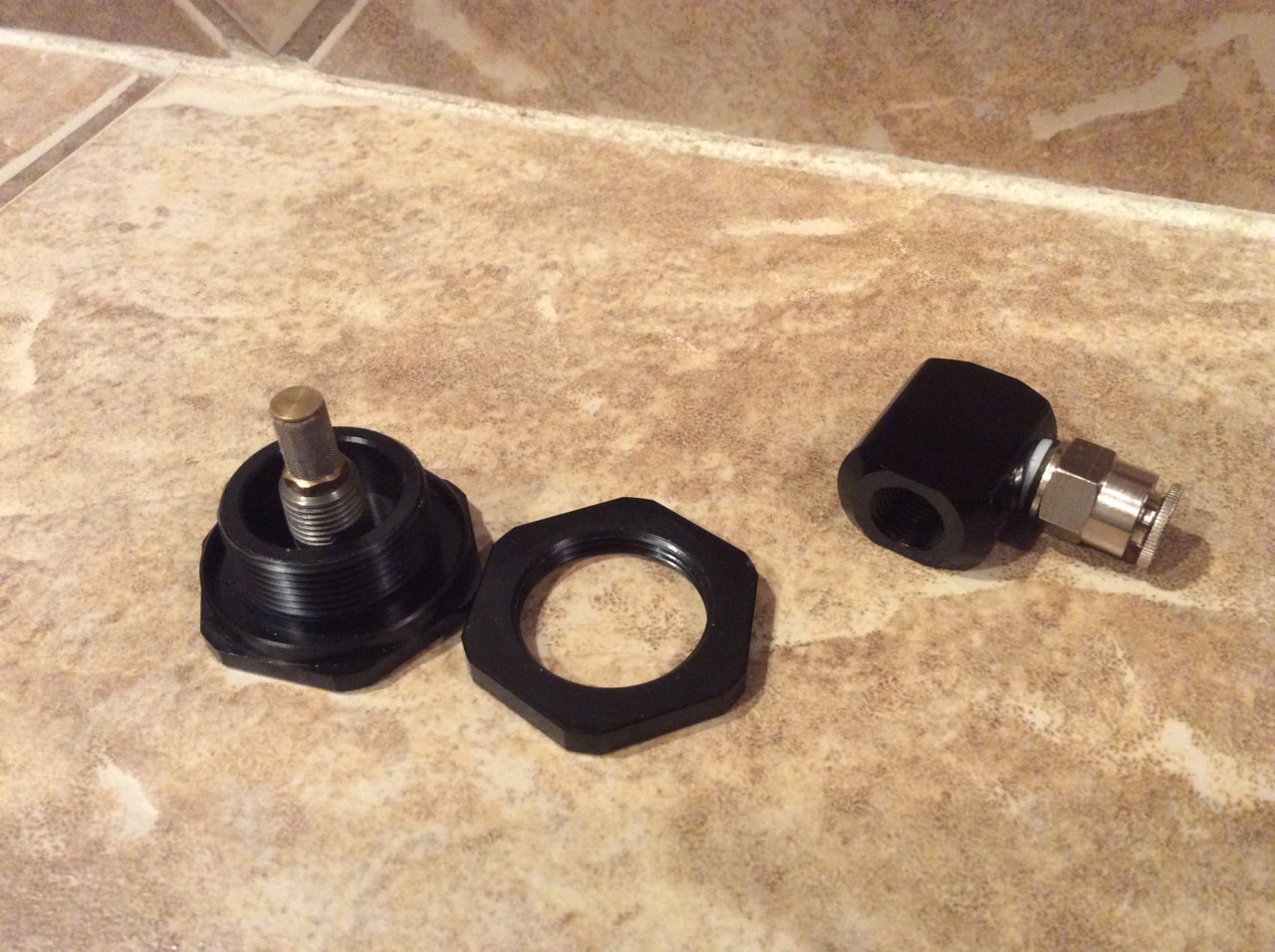

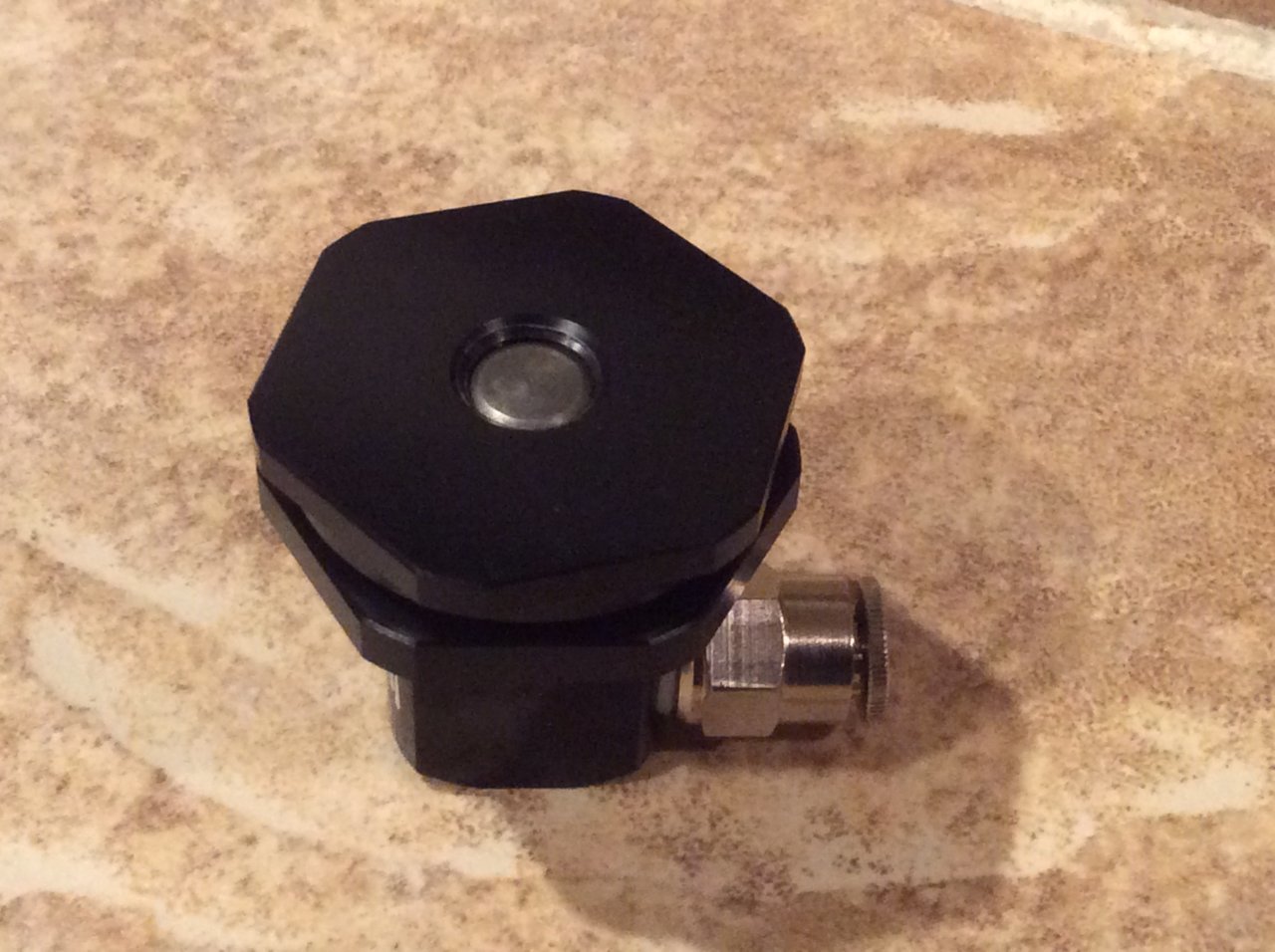

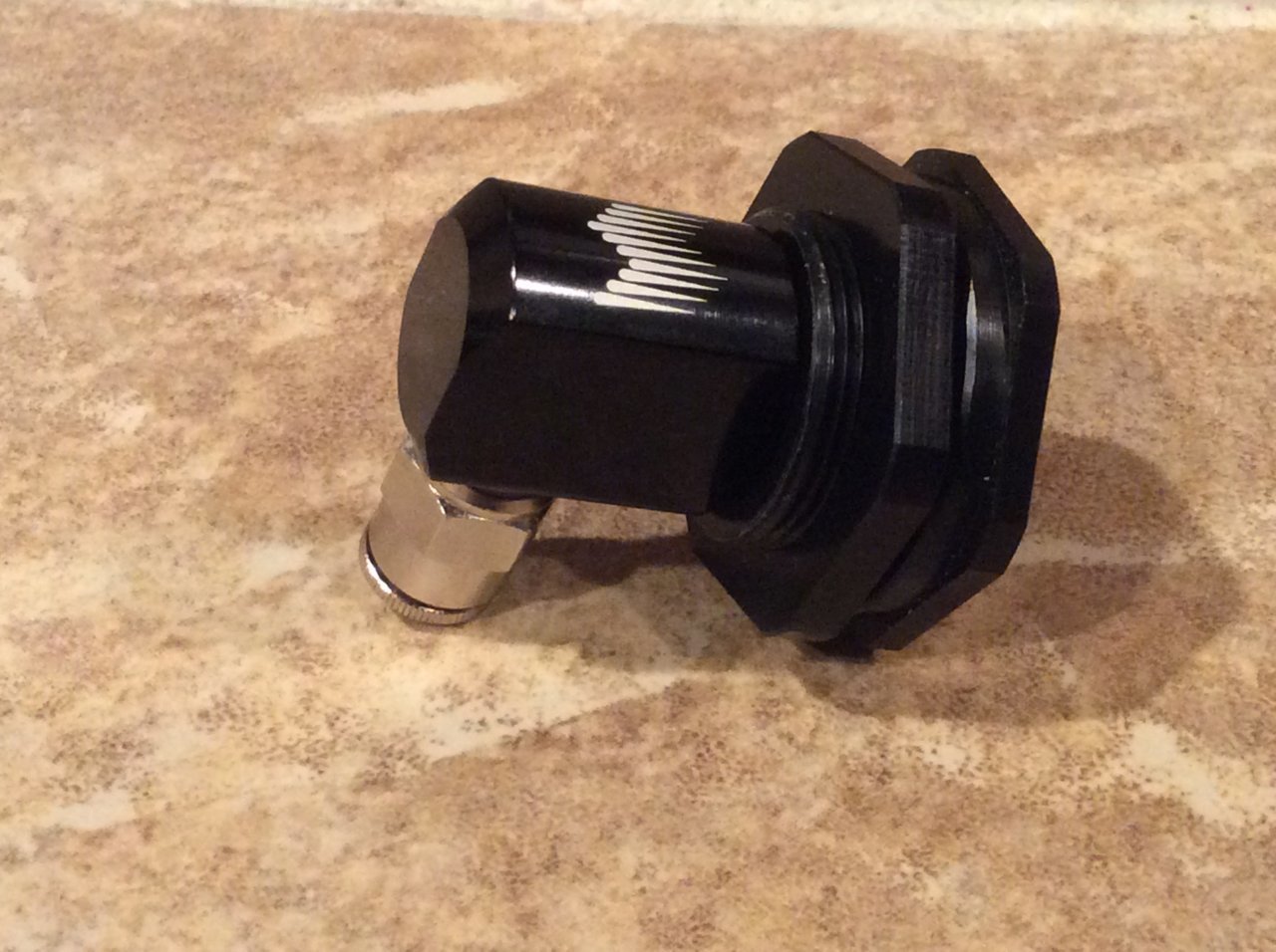

    V6 5sp,RegCab,TVS1320 Supercharger, 56mm pulley, methanol injected Haltech ECU, AC Tvs1320 supercharger,(MUST DO) every 125,000- 150,000 needs rebuild Projector headlights HID 5 speed manual Amsoil for all drive train Smaller 56mm custom pulley, (MUST DO) 2004 DESNO fuel injectors, zero ping ping, 2004 side door mirrors Dick Cepek Rims, Michelin tires LTX, ATM Pathfinders Dynopro ATM ( that last 100,000 miles) Now running Dynopro ATM mud and snow tires KN cold air intake Cat back dual exhaust with ss exhaust tip, Raised exhaust tail pipe to 2" below body line Optima*dry cell battery,red top Alpine sirius radio, 200 watt amp, focal is165 split door pod speakers Focal door speakers Subwoffer behind seat Viper alarm, Electric Locks Dark tinted windows, bucket seats corbeau lg1 Tacoma Rubber floor mats TRD fender extenders, Bilstien shocks, King shocks JBA UCA trailer iv hitch, electric brake control, Drilled slotted brakes, High carbon steel (MUST DO) EBS green stuff 7000 series pads(MUST DO) TRD engine oil cap TRD stick shift, Marlin crawl shift kit. Rear sliding window 2002 4Runner functional hood scoop cut into Tacoma hood, 4Runner dual overhead map light Gentex Auto dim + Compass + Temp, garage,rearview mirror Snow Methonal kit stage 2 Custom 3 core aluminum radiator Linex bed liner Haltech stand alone ECU, Intake supercharger gauge. Stainless steel brake lines, Custom leather wrapped steering wheel, Haltech stand-alone ECU,

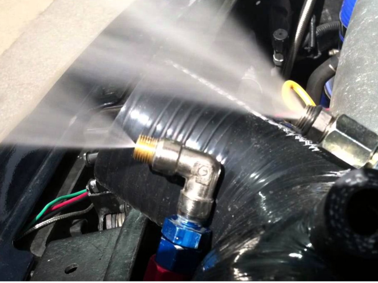

    The nozzel spray patterns usually spreads out right away and will probably hit the inside screw threads
    with it set in that far back
  3. Jan 5, 2019 at 9:14 PM
    #563
    White lightning boosted
    White lightning boosted [OP] Well-Known Member
    Dec 30, 2017
    #239848

    Thank you very much for the pics. That's quite helpful. I think if I bore out both sides I can make a success. I need a right angle drill. Doing the inside with a dremel would be pulling teeth.

    Looks to me like one might be safe with max .125in recess...

    Yeah. I'll have to split some differences. The pre made meth plates I've seen are about half the thickness of what I'm messing with. I didnt like the idea of a 2nd adapter.

    Awesome pic! What size nozzles? The one on the right looks like its higher flow than the left one.

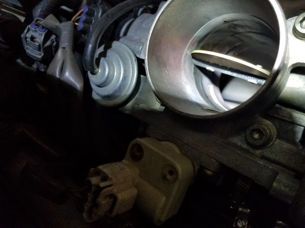

    So is there any advantage to the nozzle being post TB?
  14. Jan 7, 2019 at 12:18 PM
    #574
    Dec 30, 2017
    #239848
    8,273
    Jesse
    Poulsbo
    15' DCSB OR S/C
    Lift, pedal commander, led foglights, led interior lights, led back ups, led under lighting, urd tcai, led headlights, methanol injection, 76mm tb, hood struts, dif breather mod, ratiotek trans kit, x-series gauges, true cool trans cooler, belt wrap mod, 2.8 pulley
    The Tb wont accumulate residue. I really just wanted it there. No special gains.

    Hmm...well I’m spraying just water so maybe I’ll just go with the welded aluminum bung. I’ll have a self cleaning self maintaining TB. That’s +10 hp right there.
    Maybe I can position the nozzle carefully on the bottom of the intake tube and attempt to hide it.

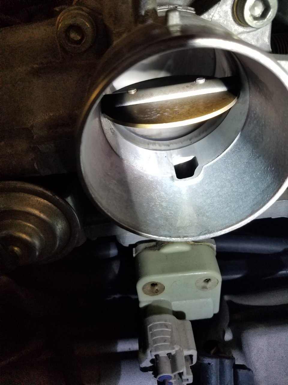

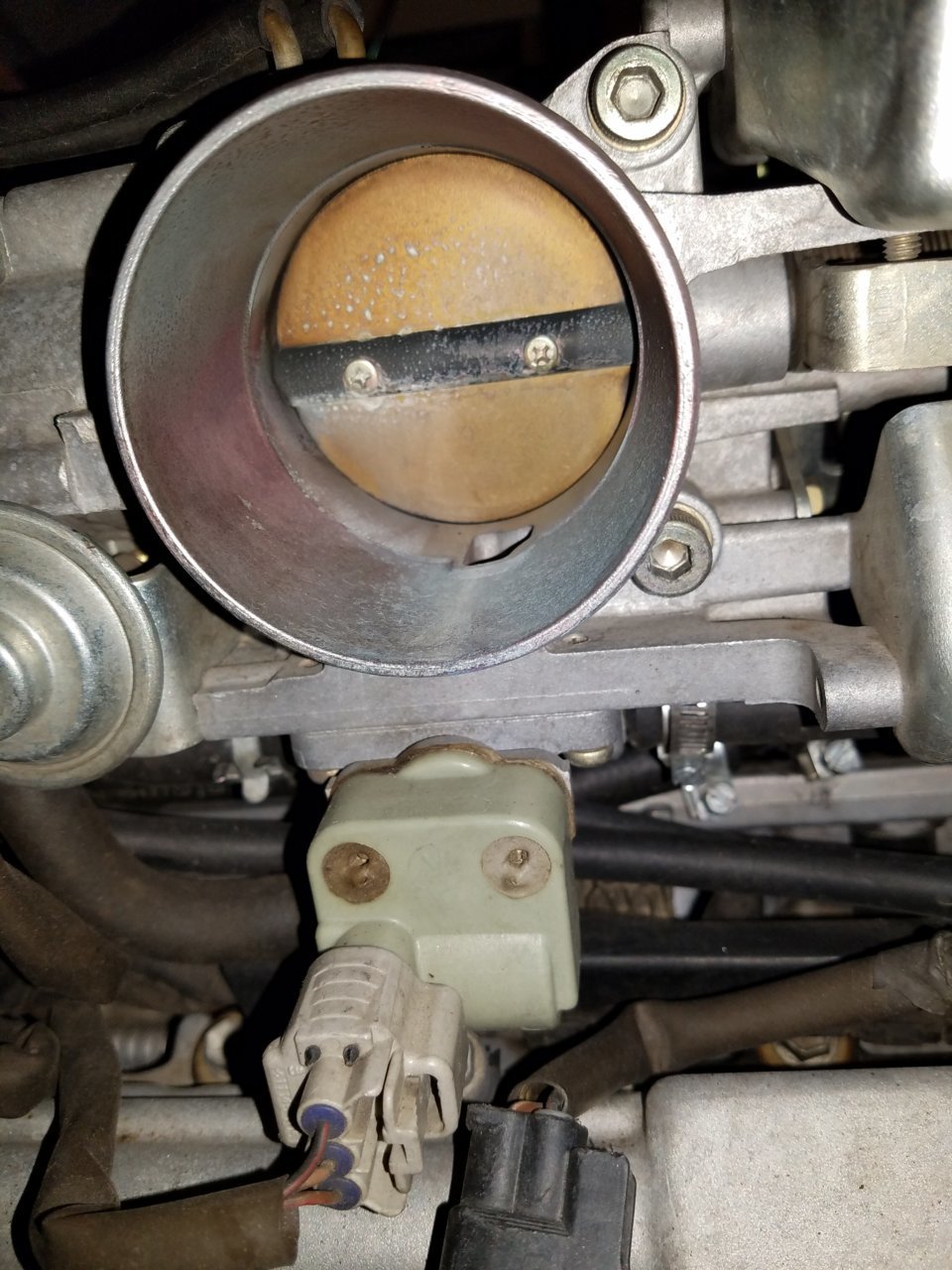

    The residue is actually very minimal and is actually more of a pink stain then an actual residue from rhe boost juice I use
    The upside of the nozzle before the throttle body is that it keeps the throttle body squeeze clean with zero carbon build up,
    I have a jillion miles my throttle body and it still looks like it's in new condition

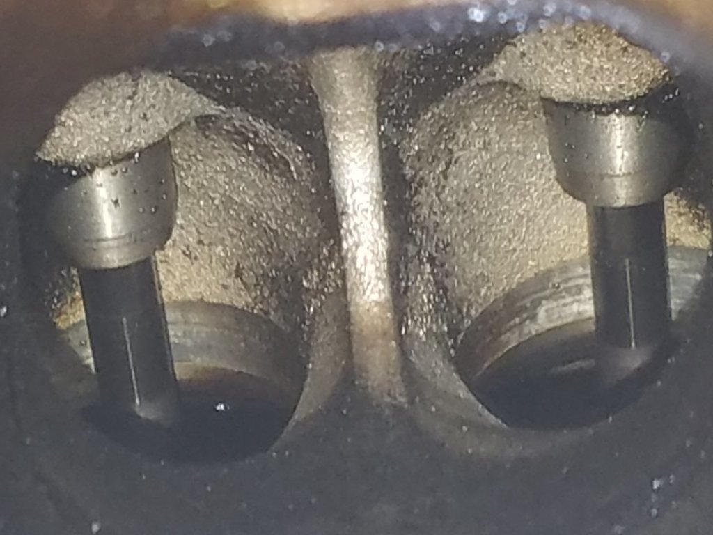

    Well remember the methanol acts like a cleaning solution for all the hard carbon buildup on the throttle body and valves too.
    My valves are the same way squeezy clean too from the methanol
