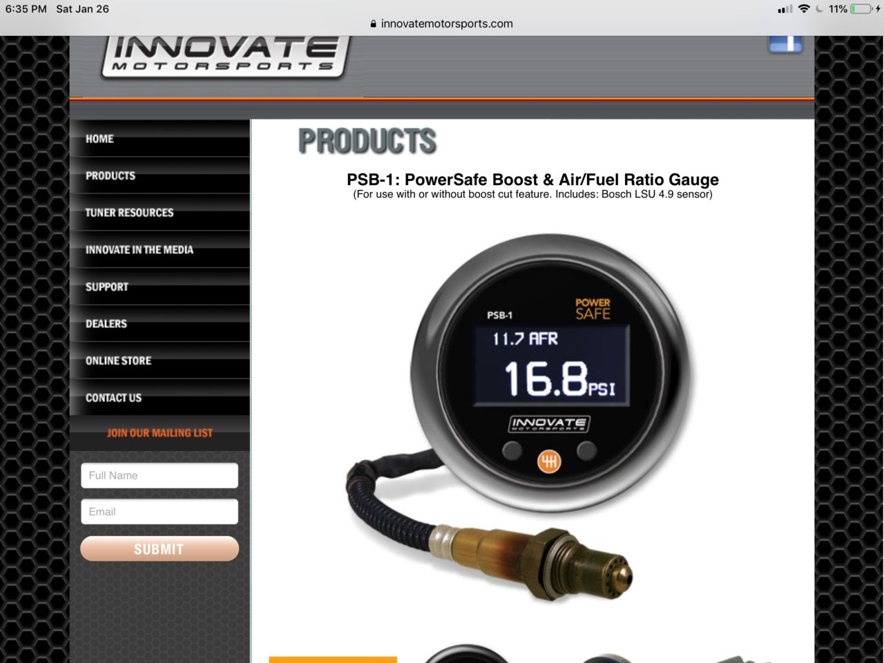

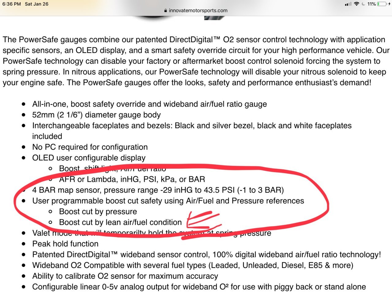

    Anyone here using a failsafe Innovate PSB-1 guage?
    I’m probably going to get one as I like that it will cut the boost if
    there is a lean situation with the AFR.
    Would be great item with the methonal kits to keep me in check that
    everything is correct with my AFR.
    This is a combo boost and AFR guage.
    Was looking for some feedback on this guage

    I have one. Keep in mind if you are going to mount it on the flexpod you will need to modify the flexpod. One dislike is the gauge has a bunch of thick wires coming out of it, kind of a pain to route everything.

    Ok great, was going to use a pillar pod so all wires are hidden, hopefully that will work.
    Otherwise your happy with it?

    Yeah should work fine in the a piller. I have no issues with it but I am lagging bad on hooking up my o2 sensor for it. Boost gauge works well though!
