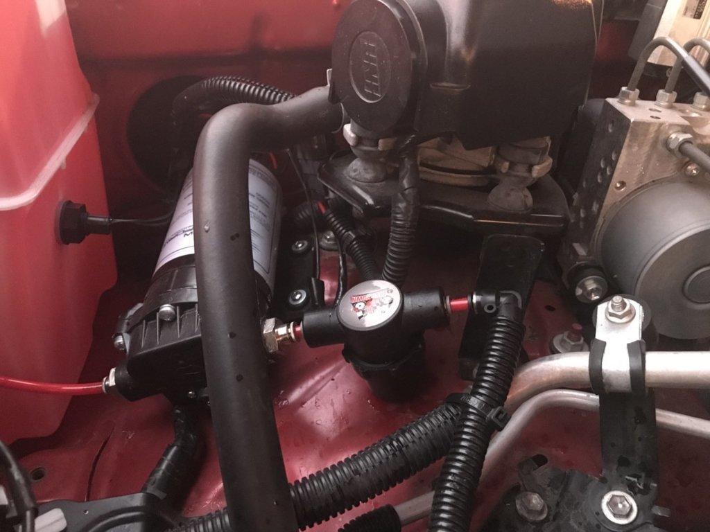

  12. Feb 22, 2019 at 7:14 PM
    #632
    BassAckwards
    BassAckwards Well-Known Member
    May 3, 2016
    #186002
    27,903
    2009 Tacoma AWD Turbo 2TR-FE
    Full-time AWD & BorgWarner EFR 6258
  13. Feb 22, 2019 at 7:23 PM
    #633
    White lightning boosted
    White lightning boosted [OP] Well-Known Member
    Dec 30, 2017
    #239848
    8,273
    Jesse
    Poulsbo
    15' DCSB OR S/C
    Lift, pedal commander, led foglights, led interior lights, led back ups, led under lighting, urd tcai, led headlights, methanol injection, 76mm tb, hood struts, dif breather mod, ratiotek trans kit, x-series gauges, true cool trans cooler, belt wrap mod, 2.8 pulley
    Oooo! Where did you find that gem? Please post your maintenance results. I was very surprised how much crap collected on the nozzle screen after 8 months. Annual cleanings I believe are not enough.
    Athlaos and BassAckwards[QUOTED] like this.
  14. Feb 22, 2019 at 7:26 PM
    #634
    1997tacomav6
    1997tacomav6 V6 5sp,RegCab,TVS1320 Supercharger,Haltech, 800k
    Oct 5, 2013
    #113940
    10,367
    John
    Denver
    97 reg cab, v6 5sp 300hp supercharged, Methonal Injection, 800,001 plus miles, Original Owner
    V6 5sp,RegCab,TVS1320 Supercharger, 56mm pulley, methanol injected Haltech ECU, AC Tvs1320 supercharger,(MUST DO) every 125,000- 150,000 needs rebuild Projector headlights HID 5 speed manual Amsoil for all drive train Smaller 56mm custom pulley, (MUST DO) 2004 DESNO fuel injectors, zero ping ping, 2004 side door mirrors Dick Cepek Rims, Michelin tires LTX, ATM Pathfinders Dynopro ATM ( that last 100,000 miles) Now running Dynopro ATM mud and snow tires KN cold air intake Cat back dual exhaust with ss exhaust tip, Raised exhaust tail pipe to 2" below body line Optima*dry cell battery,red top Alpine sirius radio, 200 watt amp, focal is165 split door pod speakers Focal door speakers Subwoffer behind seat Viper alarm, Electric Locks Dark tinted windows, bucket seats corbeau lg1 Tacoma Rubber floor mats TRD fender extenders, Bilstien shocks, King shocks JBA UCA trailer iv hitch, electric brake control, Drilled slotted brakes, High carbon steel (MUST DO) EBS green stuff 7000 series pads(MUST DO) TRD engine oil cap TRD stick shift, Marlin crawl shift kit. Rear sliding window 2002 4Runner functional hood scoop cut into Tacoma hood, 4Runner dual overhead map light Gentex Auto dim + Compass + Temp, garage,rearview mirror Snow Methonal kit stage 2 Custom 3 core aluminum radiator Linex bed liner Haltech stand alone ECU, Intake supercharger gauge. Stainless steel brake lines, Custom leather wrapped steering wheel, Haltech stand-alone ECU,
    Mine too, I figure for 20.00 I will replace it every year 30,000 miles.
  15. Feb 22, 2019 at 7:27 PM
    #635
    BassAckwards
    May 3, 2016
    #186002
    27,903
    Here you go brother. I havent looked at my nozzle lately, but i may clean it this weekend just to be safe
    http://www.alcohol-injection.com/en/water-injection-parts/429-in-line-filter.html
  16. Feb 22, 2019 at 7:29 PM
    #636
    BassAckwards
    May 3, 2016
    #186002
    27,903
    It has a stainless steel 40 micron filter so i think you can take it out and clean it
  17. Feb 22, 2019 at 7:43 PM
    #637
    1997tacomav6
    Oct 5, 2013
    #113940
    10,367
    John
    Denver
    The valve hole and stem actually get some kind of deposits in there that plug it up.
    My filter screen has been clean so far.
  18. Feb 22, 2019 at 7:57 PM
    #638
    BassAckwards
    May 3, 2016
    #186002
    27,903
    Ohh, youre replacing the nozzle every year. I misread that. Thats not a bad idea
  19. Feb 22, 2019 at 8:09 PM
    #639
    Dec 30, 2017
    #239848
    8,273
    Jesse
    Poulsbo
    15' DCSB OR S/C
    Or as instructed just take it out and clean it. Some clr and maybe air could tune it up.
  20. Feb 22, 2019 at 8:14 PM
    #640
    1997tacomav6
    Oct 5, 2013
    #113940
    10,367
    John
    Denver
    Yup you can do this too, cleaning the nozzle is a must and has to be inspected on a regular basis.
    It does and will get plugged with gunk. The last time I cleaned mine the spring, the nozzel and the shaft
    had some kind of corrosion stuck to those parts but the screen was clean
