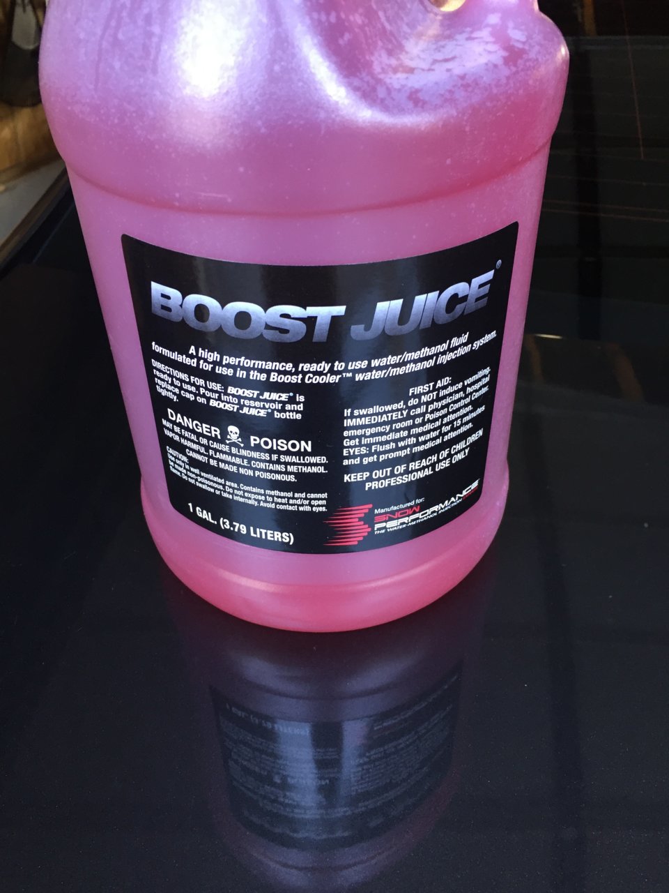

    Do you only run boost juice, or do you still mix some of your own?

    Personally I run boost juice

    I do too, im thinking thats probably a little cleaner than mixing it yourself

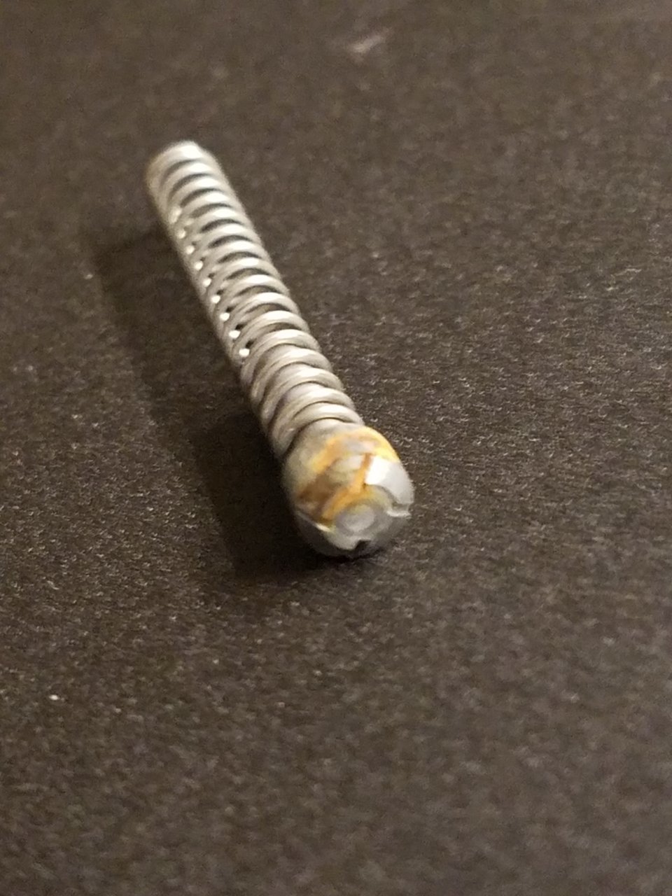

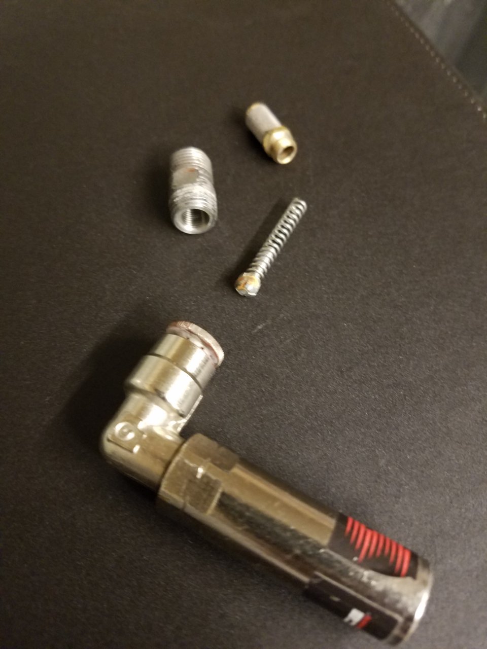

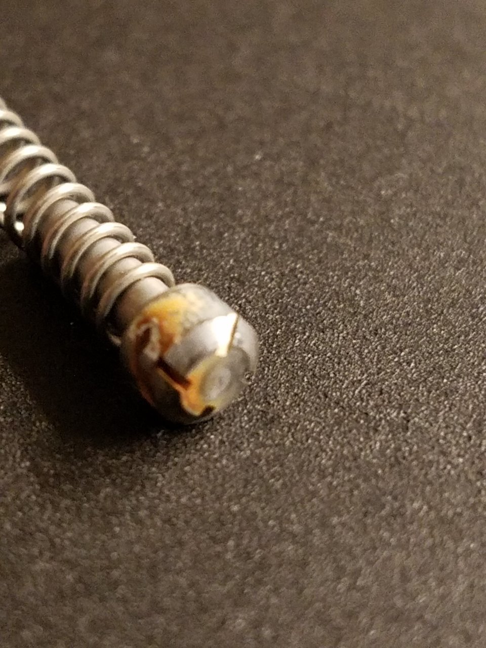

    I took my nozzle off and apart yesterday.
    Screen was clean,
    Nozzle hole was clean
    But the rotating spring valve was plugged with some gunk.
    Took a brass wire brush to the gunk and all is good.
    It’s a good idea to regularly clean the nozzle every 15k miles I guessing or once a year

    Do you run boost juice exclusively? Or mix your own

    Plain boost juice exclusively
