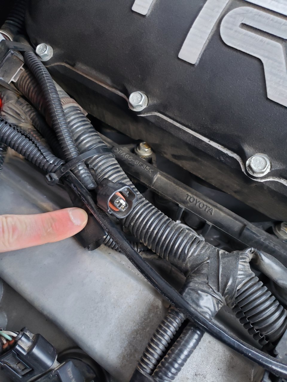

    Still looking for pics. Thanks. Just wanna no what injector wires to tap into. It says the 2 blue wires go to the injectors.

    @White lightning boosted may be able to help you with that. I have not tapped into my injector wiring yet, so im not 100% sure what that involves. I am running boost only to control it for now

    I picked the easiest injector and just tapped them. Wires arent specific .They can be... bassackwards and work fine20190411_192108.jpg

    Magnuson supercharger, 2.6 quick change pulley, 76mm throttle body, Doug thorley long tubes, urd y pipe, wot box with 2 step, 170 thermostat, airaid intake, urd short throw, djm 3/4
    I’m just confused. Do I hook the 2 blues up to the 2 wires going to 1 injector?

    Yes you only need to tap into one injector from what ive seen

    One injector is tapped. Two wires from controller to two injection wires. There is no backwards way.
