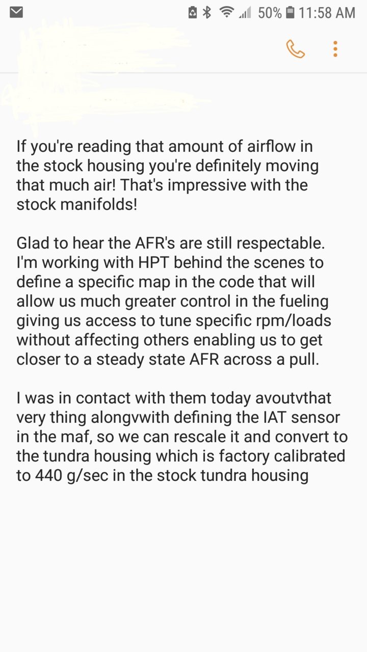

    This is my most immediate answer to this situation.
    The longer version to this answer is that you can reduce the voltage scale on the MAF electrically using a device to do so which would allow you to run higher gm/s through it. Maximum is 5 volts so there is a range to work with, you have to know what you are doing though..
    As far as mechanical voltage scaling of it goes, you can run a 3.5" tube instead of the 3"
    The Tundra intake air cleaner is a 3.5" design which is why it has a max of 440 gm/s right from the gate.

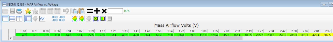

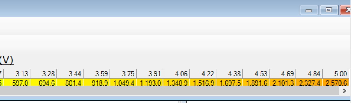

    Here is what HP Tuners is showing for MAF Airflow VS Voltage.
    This a 2010 stock calibration. (without supercharger)
    NOTE: this is lbs/hr NOT g/sec
    JustDSM posted it in g/sec just after I did.

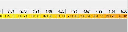

    With aftermarket intakes, and other EMS/Piggyback solutions the g/sec reported is virtually meaningless. Most all piggyback controllers are going to modify the maf signal to either richen/lean the truck at various points to achieve the AFR the tuner/calibrator wants.
    But here's the tables for the stock maf/housing calibration.

    Thanks guys. Makes sense that the g/s reported by the UCon (gag all you want) will be different from the actual g/s and not provide a useful signal.
    I am still curious, the stock MAF is calibrated up to 5V, but if the actual airflow goes ABOVE 323.85g/s (at the 5V mark) would the actual voltage through the wire connecting the MAF to the ECU continue to go higher? I understand one should not rely on the accuracy whatsoever past that point, however I'm just curious - it wouldn't make sense to me that it would just hit a plateau at 5V regardless of how high the flow goes above the uppermost 323.85g/s.

    Great question!
    You are correct about the 5v calibration. If airflow surpasses that 324g/sec mark, the MAF will peg at 5v even though you may actually have 400g/sec passing across the MAF. The way the MAF works is by maintaining a constant temperature across a thin element (wire) in the MAF tube. The amount of voltage required to keep the element at this temperature is what the ECU references. So if it takes 2.34v to maintain the temperature of the element, it's flowing 29.02g/sec.
    Unfortunately the sensor won't read beyond 5v as it's reference voltage is only 5v. So in order to read more airflow with the stock MAF it must be installed in a larger housing which flows more air and the MAF voltage table recalibrated.
