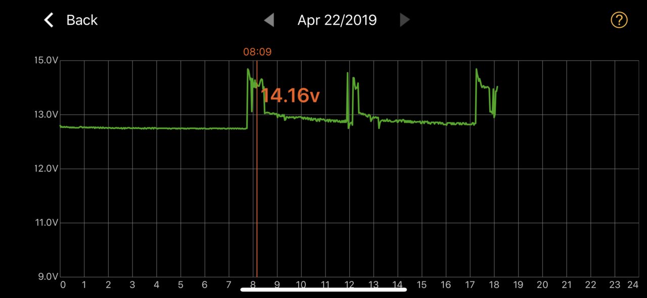

    Yep, the PCM regulated 5V circuits will stay that way, the PCM does not like seeing increased voltages of over 14.8-15v, however, and in the long run it may fail prematurely because of those voltage boosters.

    Here:
    https://www.tacomaworld.com/threads/the-northstar-agm-battery-voltage-booster-upgrade.604478/
    With +0.6v it puts typical voltage close to 14.2v, peak immediately after startup at about 14.7 which then drops off quickly.

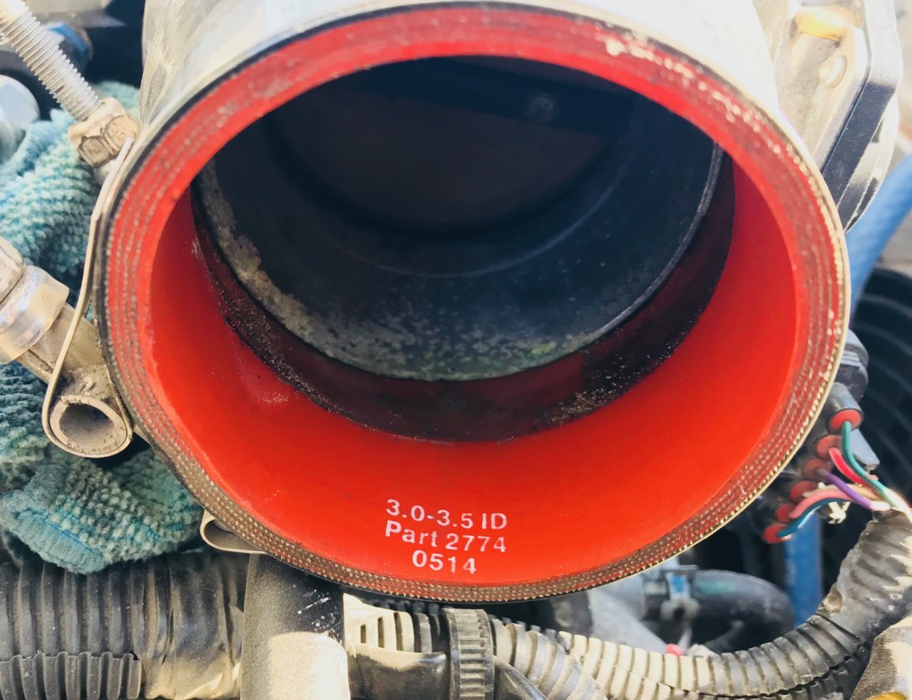

    Took the meth leg (where all the nozzles are installed) out and noticed this. It appears to be scale, not corrosion. And it's only on the throttle "lip", not near the butterfly itself.
    I suppose given that I think I spray more water/methanol than anyone else that I know of (675cc/min) - I think it must pool there sometimes. There wasn't any liquid sitting there, however, when I pulled it apart.
    Also, I inspected the nozzles while I was there and I didn't see any scale at all. I will probably do a de-scaling soon anyway, just to be sure.
    Stay cool my friends.

    I had similar. It's from going wot followed by immediately decelerating for extended periods. I did a quick scour pad and vaccum to clean.
