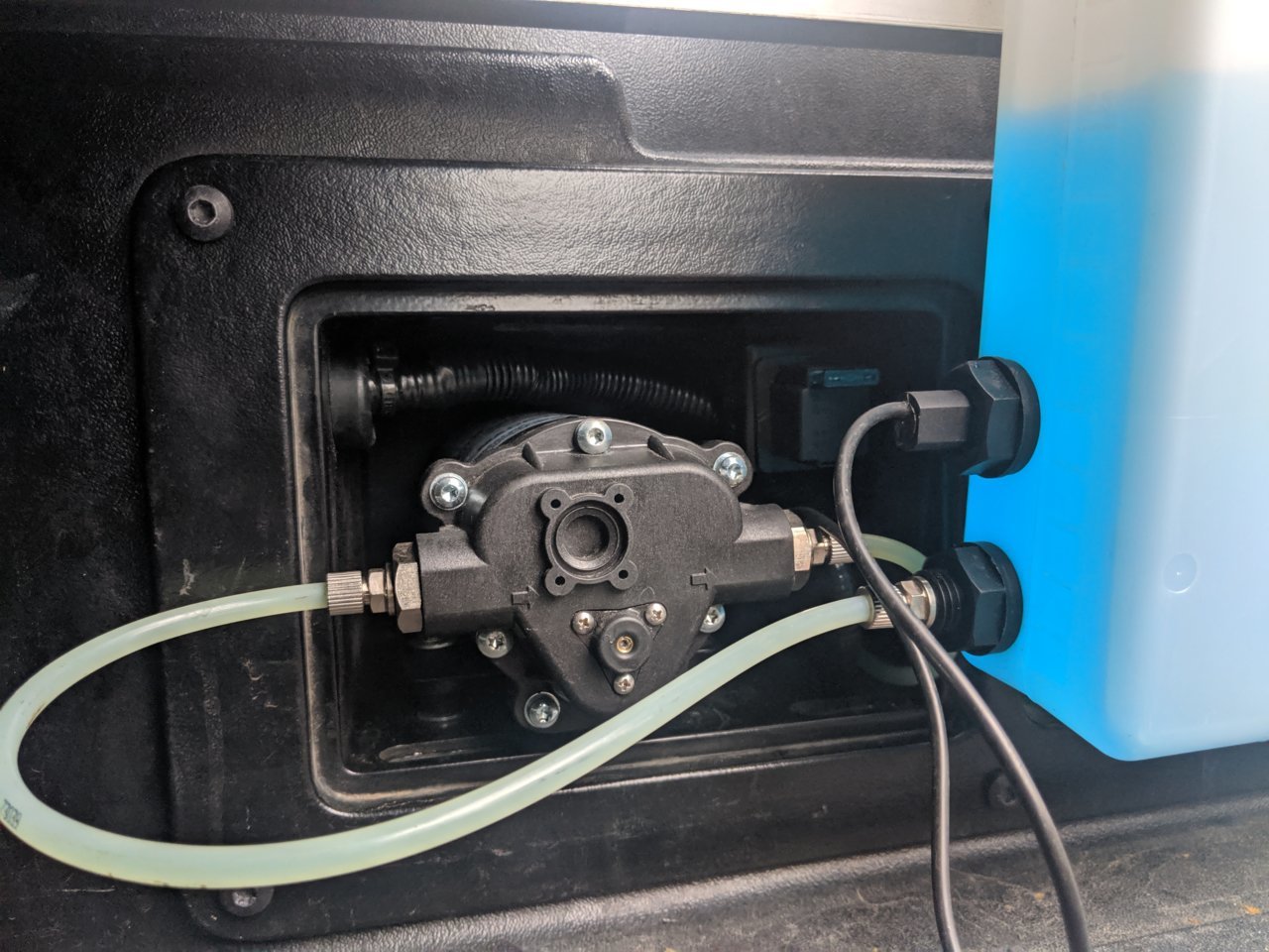

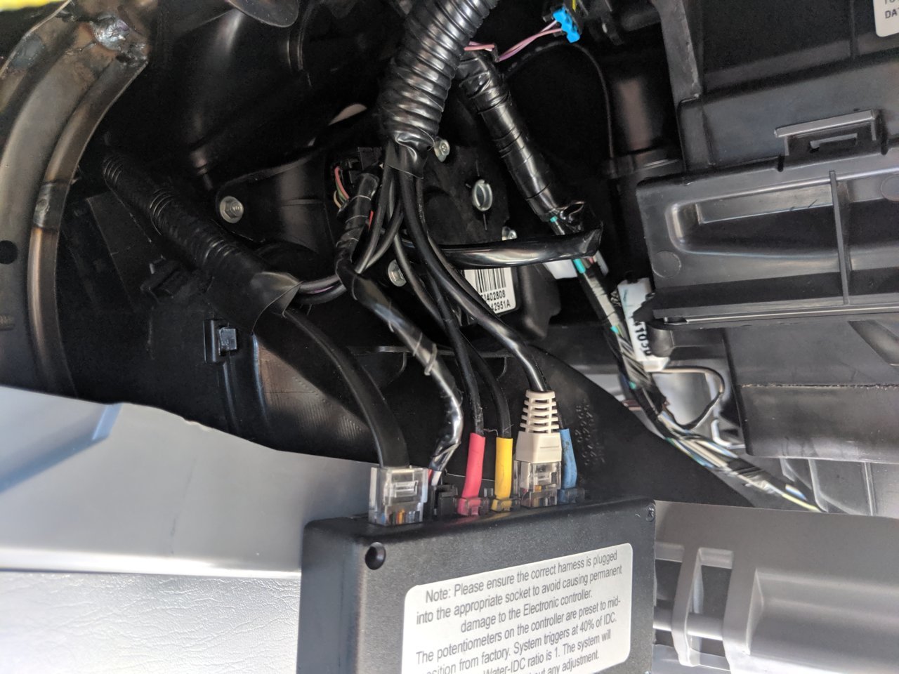

    Well I got a good deal on a brand new secondhand Aquamist HSF-3 setup which I'll pickup today or on the weekend. Rounded up E6000, 8 jugs of Canadian smurf piss as Speedwaytacotuesday calls it, a URD maf extension harness and may have to install a fuse block and clean up some wiring as I already have three fuse taps going.

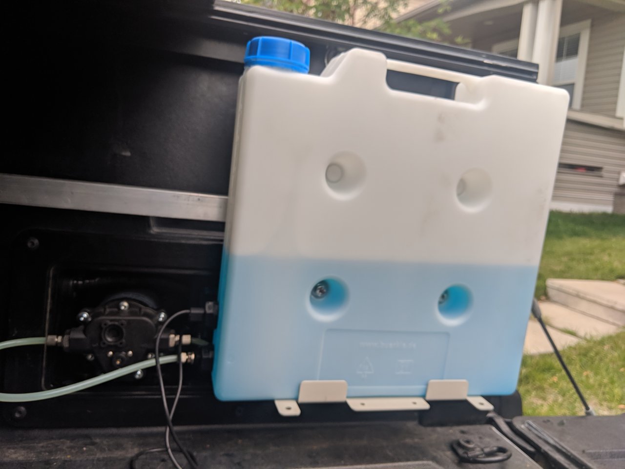

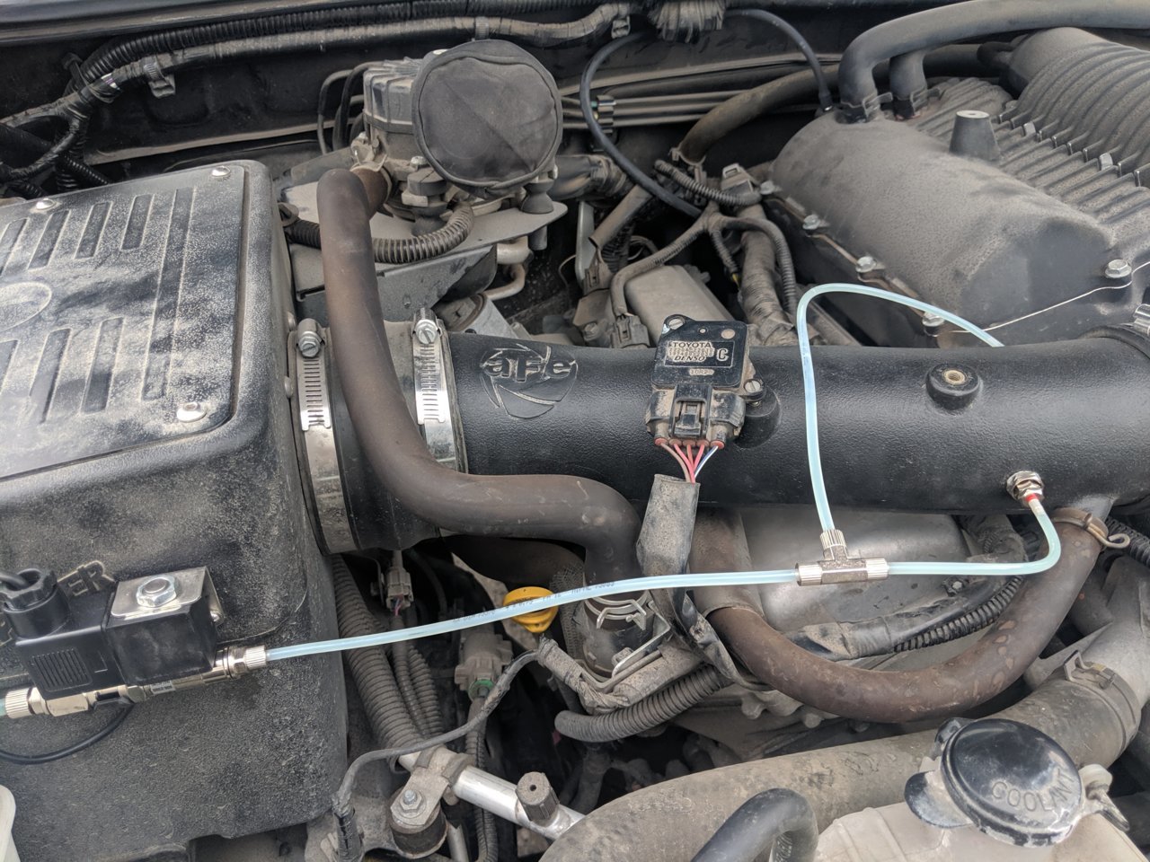

    Was waiting for the jets for a couple weeks to mostly wrap this up. Have to clean up a few things still and play around with setup but it sprays! Soooo sick of wire loom after this and last years battery relocate.
