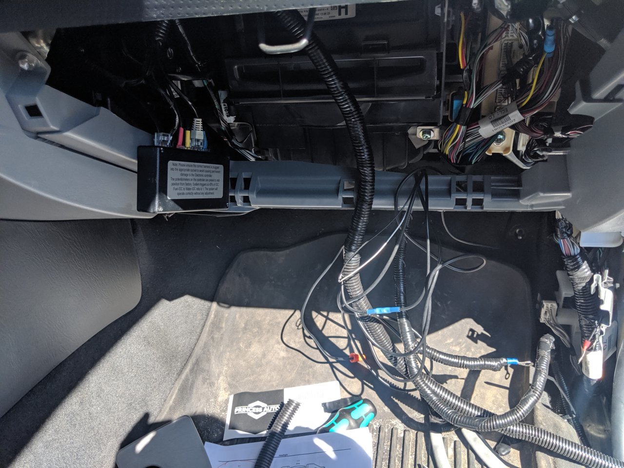

    Thanks. The wiring actually looks clean now. Just gonna put a bit of loom on the engine bay tubing and fasten it down. I need to add another support for the reservior and going to build a guard/partition for it too.

    Took me longer than installing the actual supercharger lol. Lots of fucking around and figuring out where to place and run things. I actually tried to crack open the in cab fuse box to try to make the unusused fuse slots usable. That was an utter failure and burned a couple of hrs

    What is all that wiring lol

    In cab fuse box removed. All those plugs go to it. Couldn't crack the box open though. I wanted to set up the unused/unpowered fuse slots so I could actually use them.
