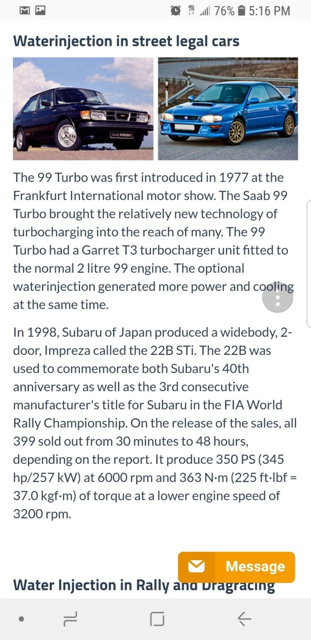

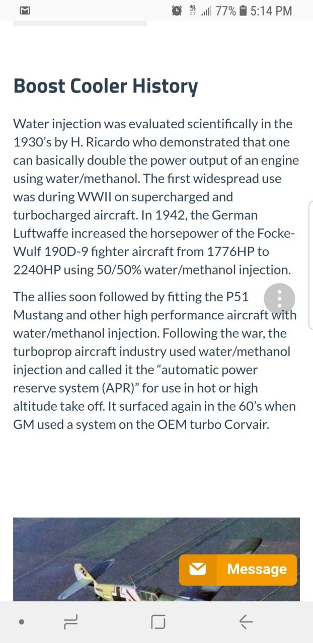

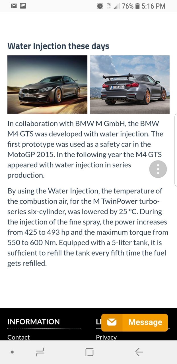

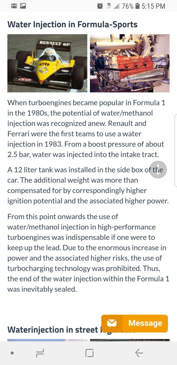

    For you guys that want more than screen shots this is available at snow performance's website. I found the history interesting. Screenshot_20180617-171440_Samsung Internet.jpg Screenshot_20180617-171554_Samsung Internet.jpg Screenshot_20180617-171440_Samsung Internet.jpg Screenshot_20180617-171554_Samsung Internet.jpg Screenshot_20180617-171634_Samsung Internet.jpg Screenshot_20180617-171700_Samsung Internet.jpg

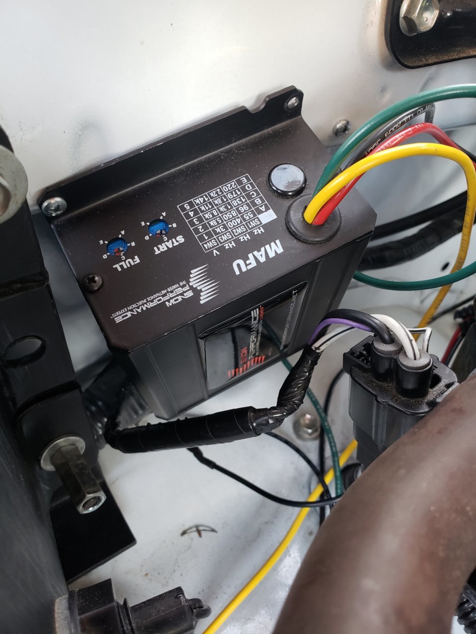

    Sounds like this maf controller could probably be used for the 7th injector. @loginfailed how did you find out which MAF wire is spliced for the controller?

    He sent me a wiring diagram. I had the wrong wire at first. I asked snow about running a 7th on it. They said in theory it might work. Nobody has tried.

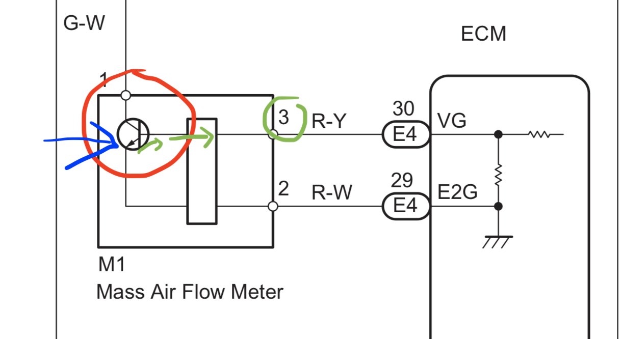

    I dug through the Taco wiring diagrams which I found here:
    http://www.customtacos.com/tech.old/files/05FSM/repair.html
    As you know, the MAF is actually both an air flow meter and an intake air temperature sensor in one assembly. So we just have to figure out which wires are for what. Looking here we see:
    https://www.customtacos.com/tech.ol.../06toyrm/06toypdf/06rmsrc/rm2006ta/005007.pdf
    For the Mass Air Flow Meter, it says:
    VG (E4-30) - E2G (E4-29) R-Y - R-W (<--wire colors)
    For the Intake Air Temperature Sensor, it says:
    THA (E4-22) - E2 (E4-28) R-L - BR (<--wire colors)
    If we look here we see:
    https://www.customtacos.com/tech.ol...06toyrm/06toypdf/06rmsrc/rm2006ta/0050017.pdf
    Pin 1 is labeled "B+". Spec is 9v-14v with ignition on. Basically a power wire.
    Pin 2 is labeled E2G
    Pin 3 is labeled VG
    Then if we look here we see:
    https://www.customtacos.com/tech.ol...06toyrm/06toypdf/06rmsrc/rm2006ta/0050019.pdf
    Pin 4 is labeled THA
    Pin 5 is labeled E2
    So now we know Pin 1 is power, Pins 4 & 5 are for intake temp. So we've eliminated all but pins 2 & 3. But there is a very big hint in the following picture. See the little black arrow (highlighted with my fancy blue arrow)? Any time you see that on a sensor diagram, you follow the opposite direction of that black arrow (highlighted by my fancy green arrows) and that is the OUTPUT (Pin 3).

    I was checking that controller out. It’s pretty much the same as the AEM. Probably will work fine with the 7th injector. Curious what the spray looks like on a number 2 nozzle from say 3000rpms to redline.

    True. I guess the easiest way would be if I had a second intake section and leave the nozzle section off and rev it up.
