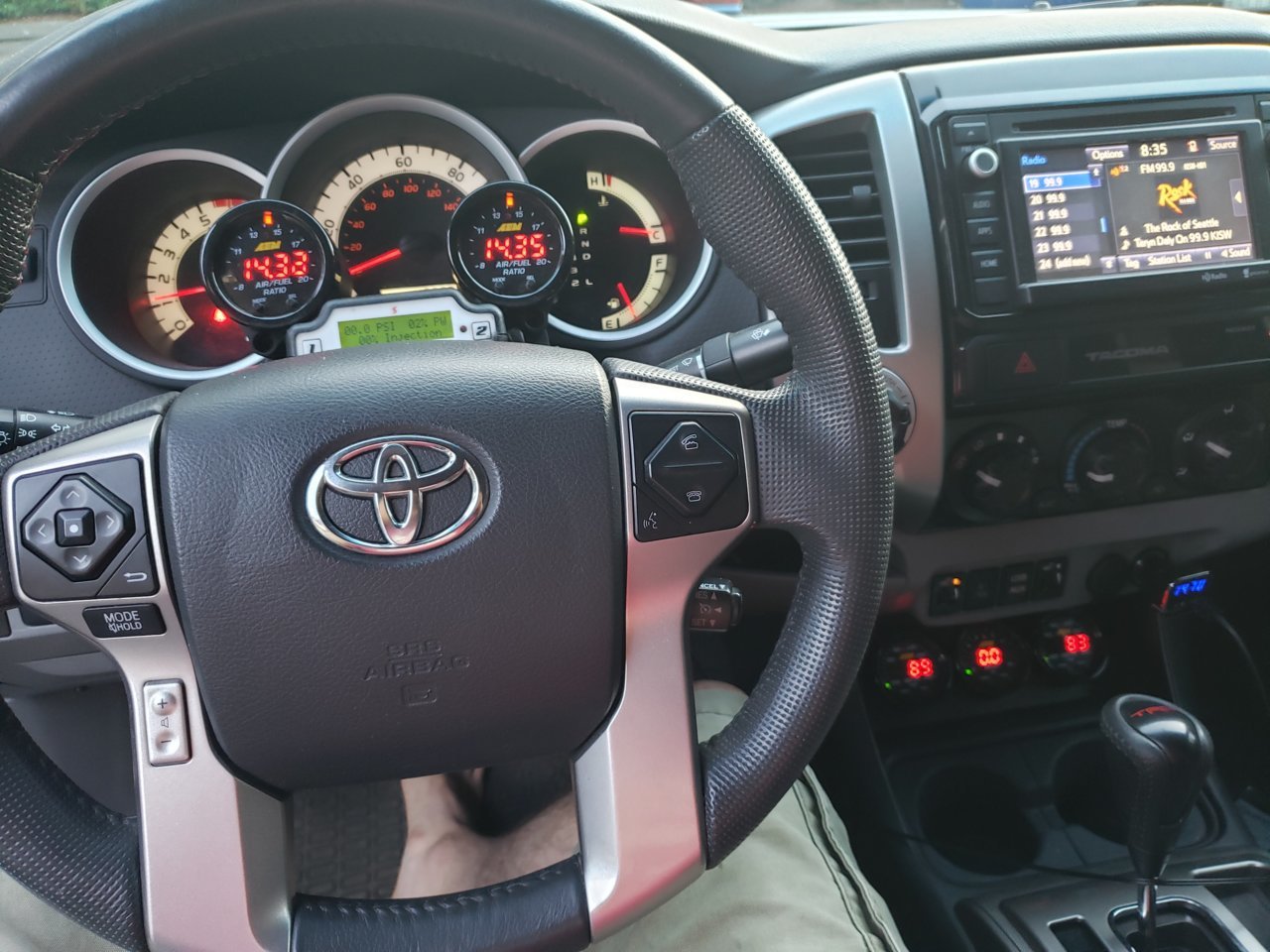

    I mounted my controller right on top of my steering column. I don’t have any pics but it fits right there quite well. Can’t put the steering wheel all the way up. But doesn’t bother me.

    Looks good there. I have flexpods mounted there so not sure how that would work..

    I made custom flex pod brackets to make it happen. its possible.

    That looks sharp. Did you make the gauge bezel in front of your shifter too?

    I used 1/2" flat stock aluminium at home cheapo an bent it with c-clamps. then sanded down the steering wheel side for clearance. allows the stage 3 and can still see gauges.

    yes. its carbon fiber 3/16" plate with matte black 3m wrap. looks quite stock really. you get used to a quick glance as these bright red gauges are easy to see.

    I have engine temp, boost, and s/c temp left to right.
