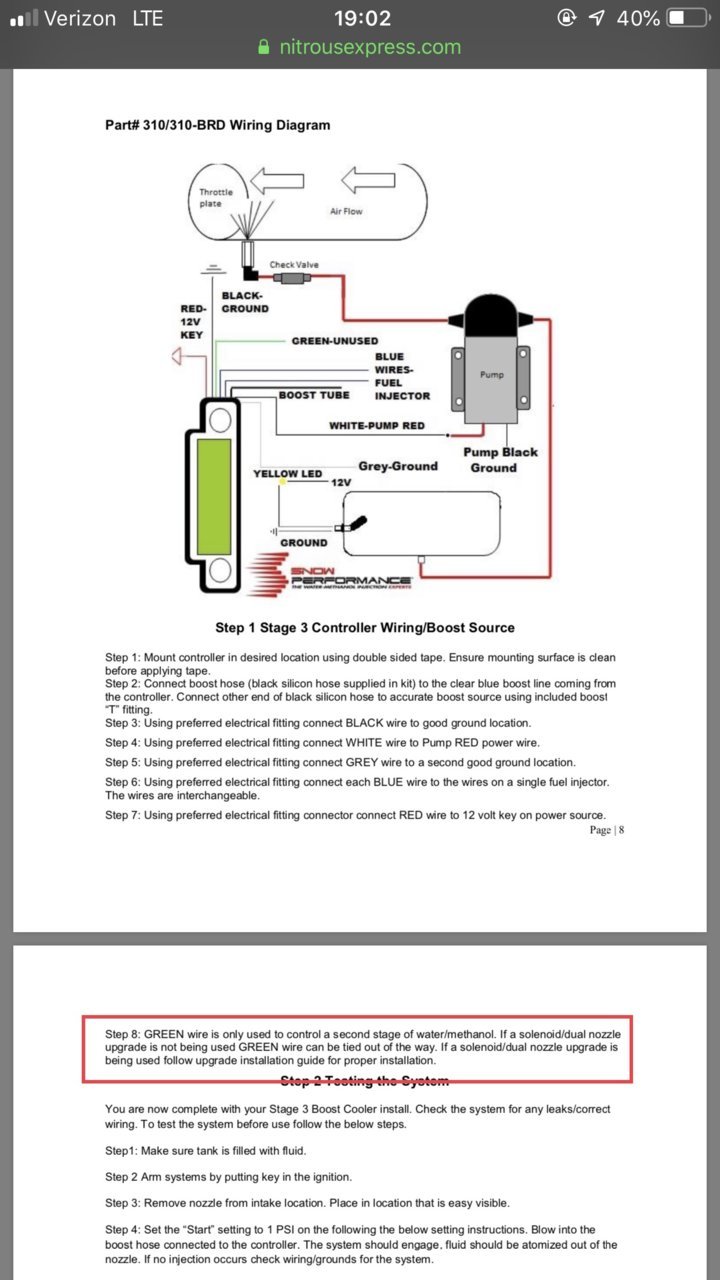

    So I have this 2.5 gallon Snow Performance tank I would like to install so I dont have to fill up as much. I was thinking behind the passenger rear fender with the filler neck accessed through the passenger side access door in the bed. What do y'all think?
    I do have one solenoid and one check valve. I may want to run two solenoids, one right before each nozzle to prevent engine vacuum from siphoning the water/meth (wm) depending on nozzle placement.
    I like how you @White lightning boosted placed your nozzle in your tb adapter plate. Yes i know I need the solenoid for this. ;)
    I may place mine in the sc inlet casting before the vacuum connections. This way if I ever get around to doing my sc intake mod, the nozzles are already close to where they need to be so new lines and such would not be required.
    Cheers

    Would a check valve work the same? I’ve got a solenoid that’s just going to open for the second nozzle.
    You can use these and just thread them into each nozzle holder.
    https://prometh.com/collections/solenoid-check-valves/products/copy-of-mini-one-way-check-valve
    Edit - wait no it won’t work. It just prevents flow going back to the pump.

    sweet idea for tank mounting. helps with the taco lean too. how are we able to run a duel system? do you know what page in the instructions?
    Roostfactor[QUOTED] likes this.
  14. Nov 30, 2019 at 7:05 PM
    #894
    Kelvin
    Kelvin Wheeeeee
    Mar 8, 2013
    #99256
    2,884
    16’ GX460 with some junk bolted on
    Green wire

    The biggest reasons I know of so far in my limited knowledge on these systems is:
    #1. If placing nozzle AFTER tb then solenoid must be used to prevent the engine from siphoning the wm in vacuum.
    #2. If placing nozzle BEFORE tb then normally only a (pre determined cracking pressure) check valve is needed.
    #3. If remote locating the tank such as trunk or bed mount, Snow recommends placing the solenoid either between tank and pump, or pump and nozzle to prevent siphoning.
    @White lightning boosted found out real world that having just Snow's check valve in place was not enough to prevent the engine from siphoning the wm in vacuum.
