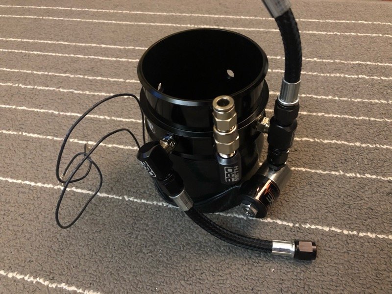

    @White lightning boosted could you post up and describe your braided stainless for your methlines? I'm thinking of doing that too.
