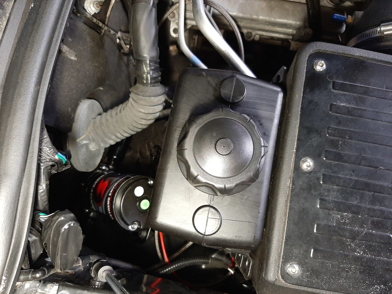

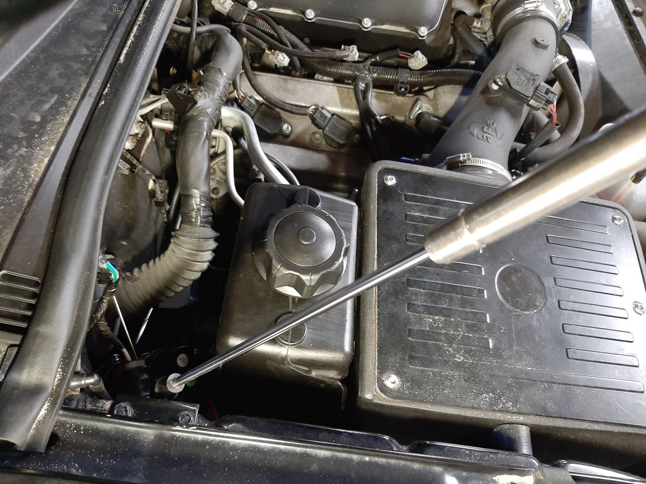

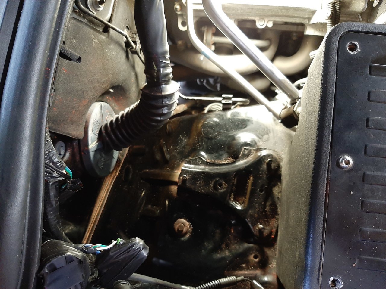

    Hey meth friends, is there any issue mounting the pump upside down / inverted? This is my mock up of mounting locations. Gonna make a bracket for the tank to basically butt up to the airbox without actually putting any holes in it.

    There wouldn't be any problem with that. Only requirement is the hoses where they connect to the pump are lower than the meth tank.

    Got it. Lines into pump are definitely lower than the tank.
    If I'm planning on only using boost for controlling spray at the moment, can I leave the blue injector wire for the IPW control disconnected?

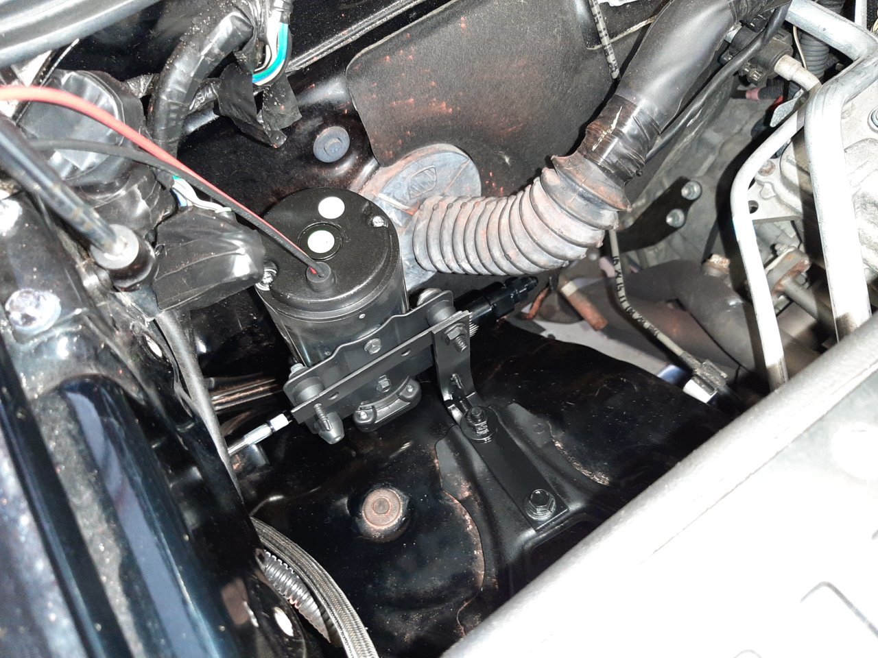

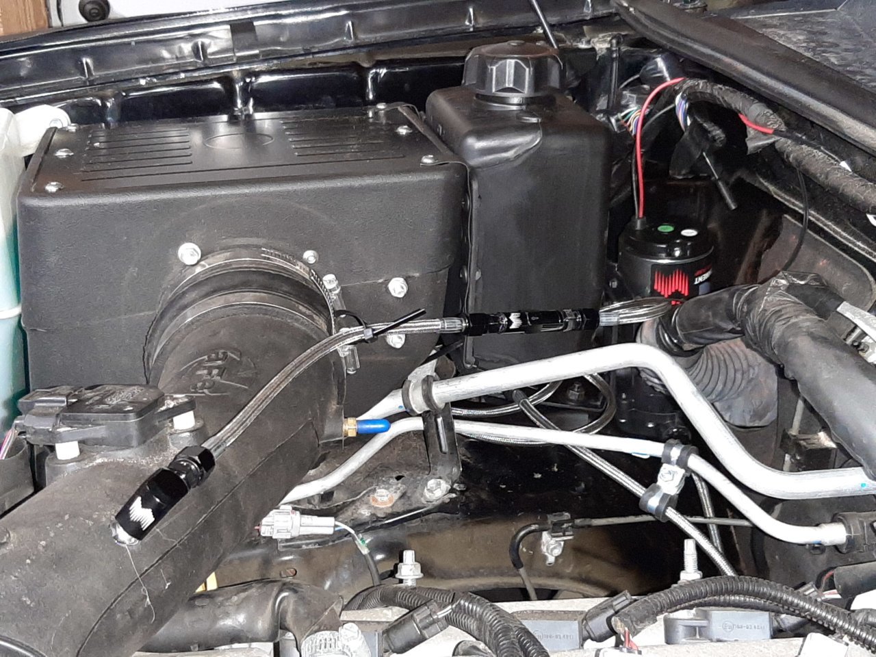

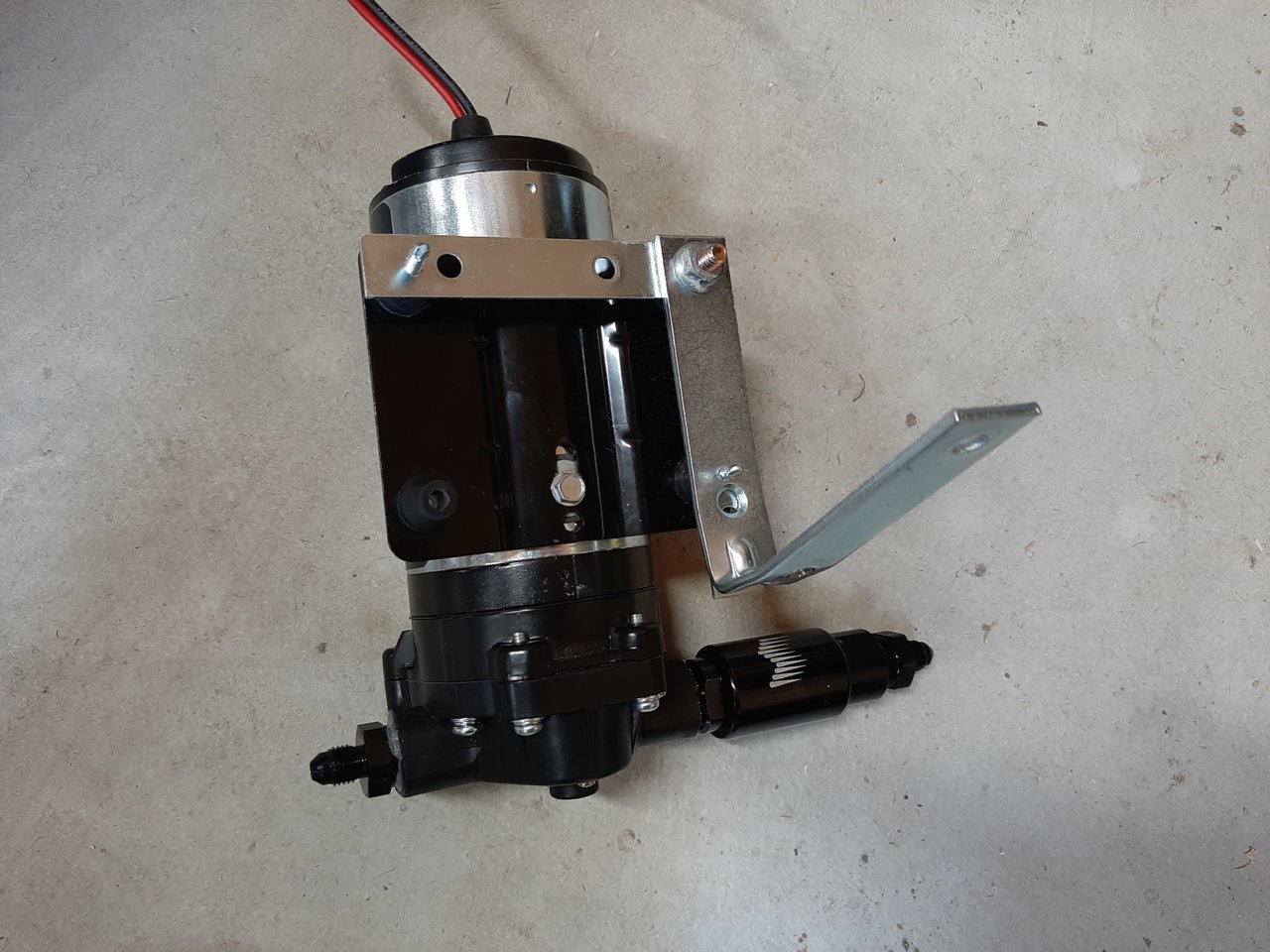

    Used the old air injection pump mount to mount my pump in the back of the engine bay.

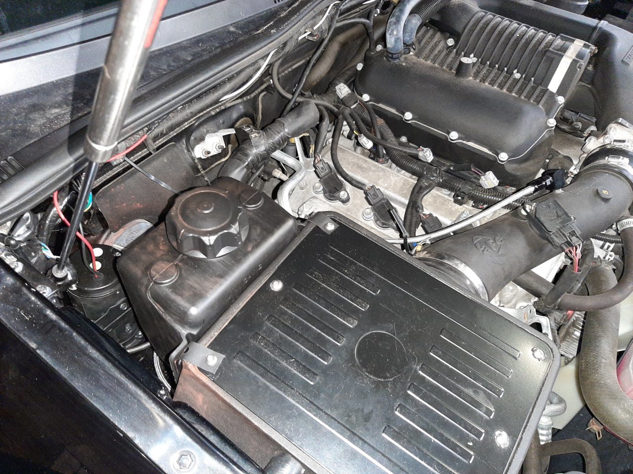

    With tank and nozzle mounted. Excuse the temporary ghetto fabbed brackets and zip ties.
