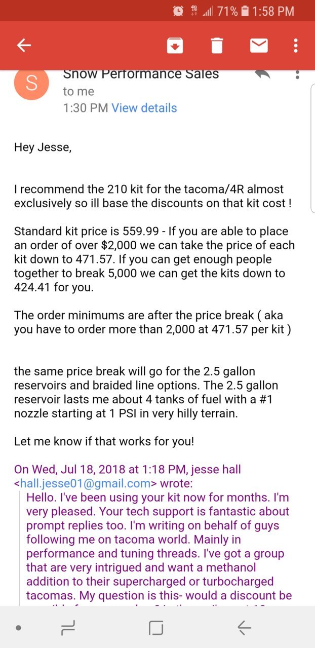

    how many people are interested in running meth? i am. anyway we can start up a group buy?

    Let me contact the guys at snow. Great idea.

  14. Jul 18, 2018 at 1:59 PM
    #94
    White lightning boosted
    White lightning boosted [OP] Well-Known Member
    Dec 30, 2017
    #239848
    8,273
    Jesse
    Poulsbo
    15' DCSB OR S/C
    Lift, pedal commander, led foglights, led interior lights, led back ups, led under lighting, urd tcai, led headlights, methanol injection, 76mm tb, hood struts, dif breather mod, ratiotek trans kit, x-series gauges, true cool trans cooler, belt wrap mod, 2.8 pulley
    This was the info I have today. Good deal if we hit the 5k mark.

    Great. I know I put this thread in the wrong section. Should have been in performance and tuning. Spread the word. FYI if you find these kits for cheaper elsewhere there's a reason. Dont buy them. They are not valid for warranty through snow.

    To reach the goal of the 5k price it's about 11 kits. Let's spread the word folks!
