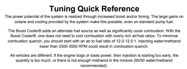

    This is nozzle sizing from the Snow instructions. I went off the 400-600hp range for the 375ml nozzle.Screenshot_20200924-161708_Drive.jpg

    I remember this chart too. I went with double what Snow wanted because of some article I read online somewhere. The AEM and Aquamist appear to be about double what Snow says in this table....

    My truck definitely doesn't bog or lose power with what I'm spraying.

    Neither. I even get a surge in power when the progressive system comes online.

    I started with 375ml because I was worried about spraying too much at low RPM. I'm running the 2.5 pulley with 10psi max boost. I initially set my spray to start at 5psi but bumped it up to 6psi because I was still in the 3300-3500 rpm range at 5psi. I noticed some bogging on my launches at the sand drags.
    Snow recommended injection above these rpms, but that's hard to avoid with the smaller pulleys on a full stop launch.
