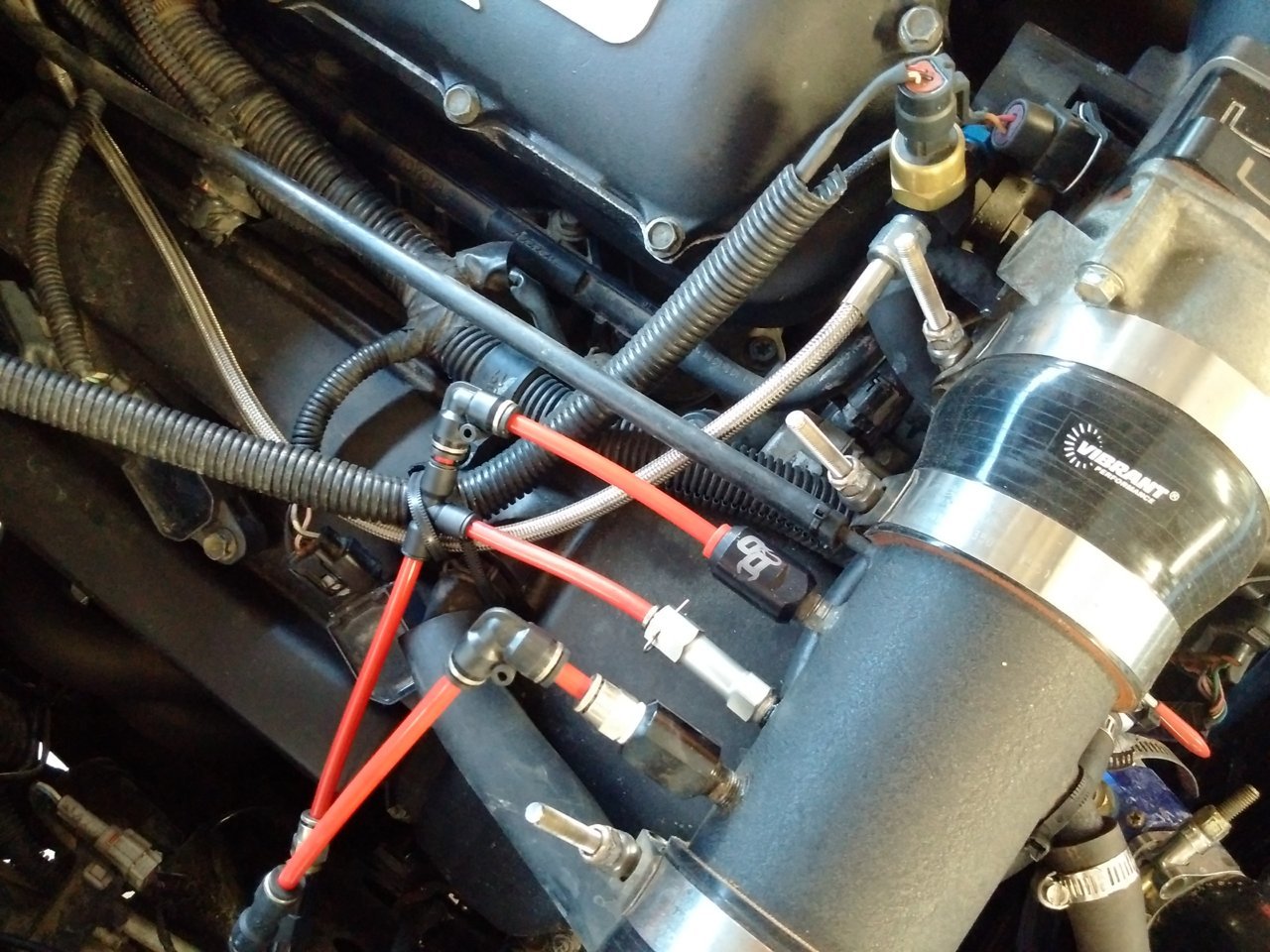

    The stage 1 system with the 225ml/min nozzle is set to activate at 7psi. Obviously that's a constant spray - the stage 2 system is set by MAF and if I'm at WOT it'll start spraying at around 2600rpm, progressing up to full blast at 5V, which is around 5000rpm.

    So. AEM v3 nozzle review. Seems to have made a difference. Noticeable when the progressive system kicks in. Obviously that's butt dyno but it does feel like there's a bigger surge in torque. I really bought the nozzle as a safety feature though, I wasn't hoping for some crazy power difference.
    Or maybe it's the sporty new seats making me feel faster... idk...
