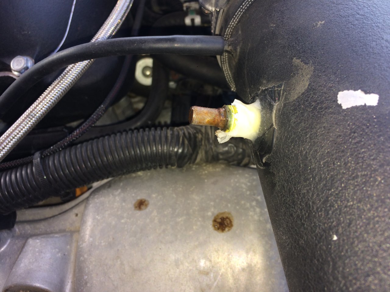

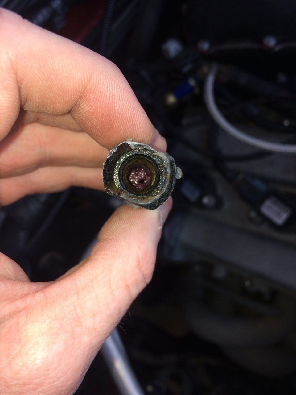

    Got my #6 nozzle in the mail today. Working on the install now.. does anyone have any tips on tools to use to remove the nozzle from the intake pipe? It would appear that I over tightened it during install and now it doesn't want to come out.
    Also found this almost all the way plugged up and the nozzle itself was rusty. I run a filter as well and it hasnt ever looked like this. I did add the filter a few months after adding the system so maybe that has something to do with it. Makes me want to add a filter before the pump too. I think I will start cleaning/replacing the nozzle every 7500 miles. This was with 15k miles on the system using only Boost Juice

    Got it out with some channel locks. Waiting for the E6000 to dry and then it off to test drive

    Not sure if you can put a filter before the pump? It didn't work with the Snow 100 micron filter when I installed on the wrong side at the pump inlet. Snow said it has to be after the pump. Maybe a different filter will work, I could easily be wrong.

    Looks like the methanol ate whatever coating Snow had on their nozzle leaving bare metal which obviously doesn't like meth!
    I don't know how you have your nozzle installed and I don't have advise since I haven't even installed my system yet.
    You cant just unscrew your nozzle?
    Whats preventing you from using a pair of vise grips and loosening it up that way?
    It doesn't look like the nozzle is useful any more anyway?

    I didn't realize snow said no filters before the pump, I guess I won't try that.. thanks for the heads up man
    I figured it out! I put the last nozzle in and snugged it up with needle nose pliers. It was the other piece of the snow fitting that goes over the nozzle that you also screw on that I also tightened down. Long story short, when I tightened this down on top of the already snug nozzle, it caused me issues during removal haha
    Yeah I was trying to remove it without destroying it at first, but gave up and went the channel lock method. Those made quick work of it. Like you said after looking at it I wouldn't want to reuse it
