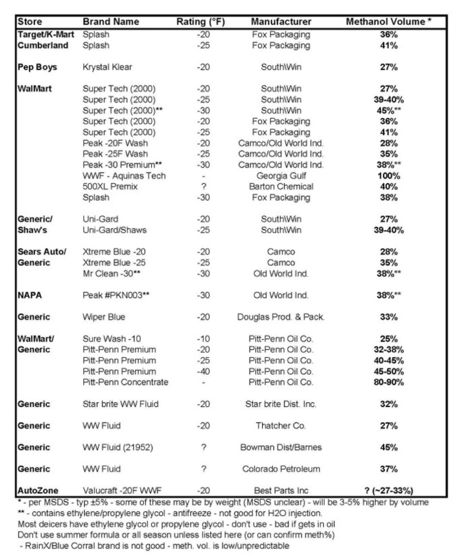

    Found this helpful reference guide for washer fluid methanol content

  4. Sep 29, 2020 at 4:15 PM
    #1044
    BassAckwards
    BassAckwards Well-Known Member
    May 3, 2016
    #186002
    27,919
    2009 Tacoma AWD Turbo 2TR-FE
    Full-time AWD & BorgWarner EFR 6258
    You know, they may not all be the same, or it may vary depending on what you use to control it (IPW or Boost pressure). I have noticed mine consistently starts spraying at 50% when using only boost to control it. I am thinking about wiring mine up to my 7th injector this weekend just so I can see how often that comes on, and maybe I can fine tune it a little bit more with that. I could be completely wrong though, I am no expert, just trying to think through things
    JacksonTacoma[QUOTED] likes this.

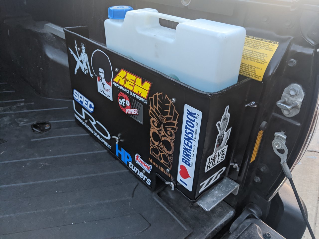

    I haven't noticed much difference in consumption yet going to dual 375 cc/min (from 320 cc/min). Also mixed some 50/50 to try out and the kick is there but it's due to both the nozzles and the mix. Probably will run washer fluid after this tank to see how she behaves.
    Also, just built a bash guard for my back of the box meth tank. And a place to put some stickers I've been hoarding for a while.

    Really nice bash guard there. I think that's a great place for all the stickers.
