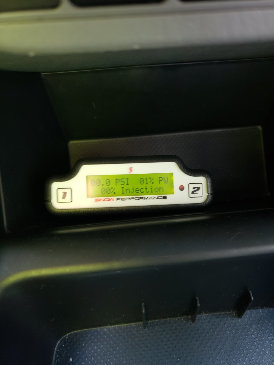

    20180730_085829.jpg So. Ongoing testing is needed for accurate info after installing snow performance's stage 3 controller. Probably overkill for my application but I couldn't easily fit another 2" gauge. My excuse, and fine with it. I used their general guidelines for setting it up. 50/50 info read from both boost and injector pulse width. Guessed at everything else. Wow! Truck drives great. I need a dyno, and the money for it for further gains. It's hard to explain how it drives but I'll try. Imagine if its 90* outside and when you boost you allowed 30* air in the motor instead of what you're used to. It's very surprising. If you hit the throttle at 50mph about 1/2 to 3/4 it really goes. I'll post a video when I can. What surprised me is approaching 70 you start backing off the throttle steadily and you're still accelerating. I think it's from the cooling making the supercharger really perform instead of drop off from heat. These pics dont show much as I loomed everything. Finger is to the injector tapped.

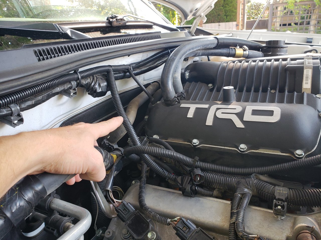

    So do you just have to tap into one of the injector wires?

    Yes. Took me 2 min. Super simple.
