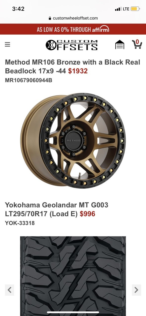

    Can anyone help me please, curious if the method 106 -44 offset 3.27 backspacing wheels will work on my 19’ taco

    Work? As in? Lift? Tire size?

    I have a 3.5” rough country suspension lift and am looking to run either a 285/70 or a 295/70

    Wasn’t sure if the backspacing and offset would cause a lot of problems

    The 106 is an actual beadlock wheel and I don't recommend those for most people due to the increased weight and maintenance.

    Yeah I really like the concave look of them

    Not worth it. The wheel is double the weight of a normal wheel which leads to decrease in MPG as well as shortened life of suspension components from more unsprung weight. Plus there's the maintenance of them. Torque on the bolts should be checked every few thousand miles.

    The 312 is very similar

    which offset should I use the -12 or 0?
