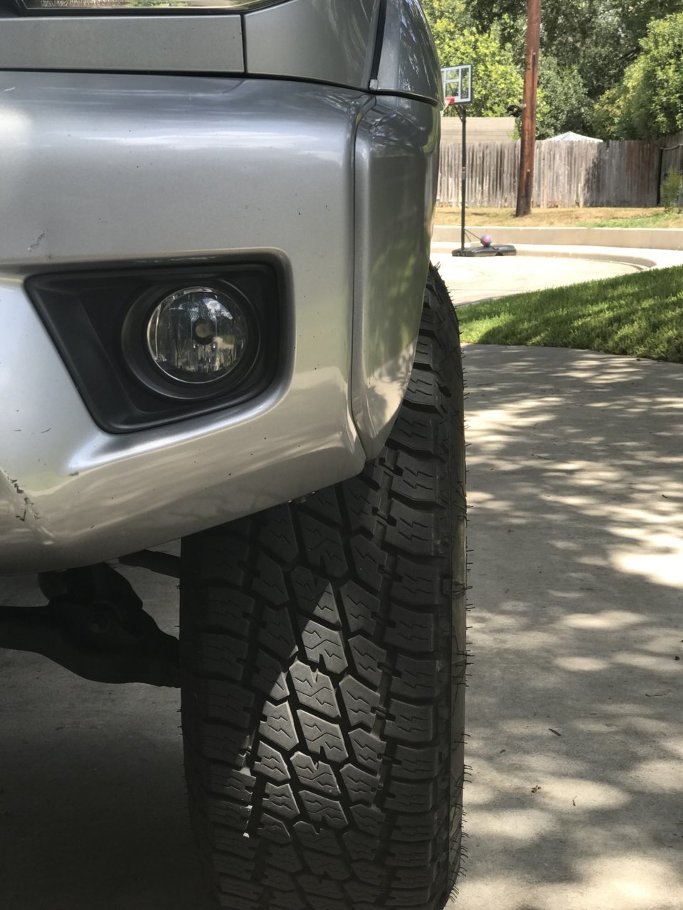

    This is a 17x8.5 -10 with a 285. So approx 3/8” less and of course the 275 is narrower. 3CA8A5BA-2F18-46AC-A09C-8F4678A1AFC4.jpg
