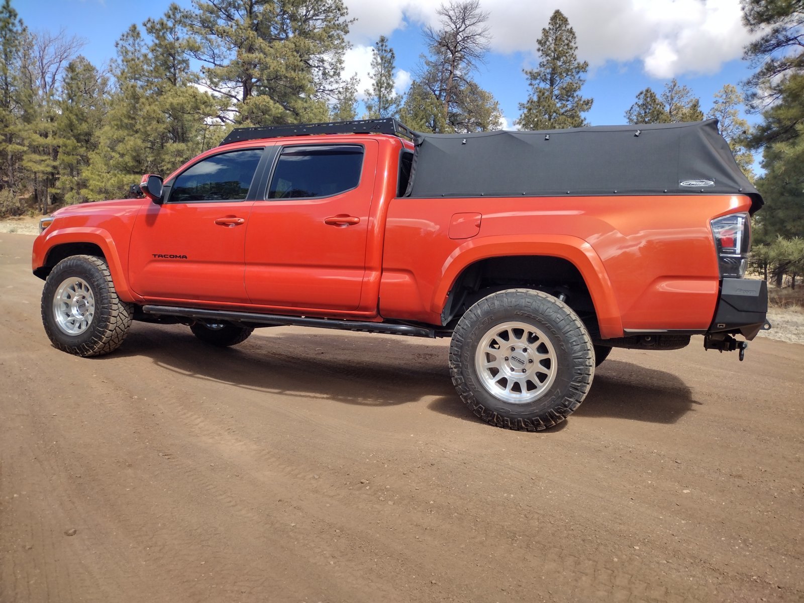

    Here's my 703 in the machined finish. Switched from the black TRD and totally loving the little bit of flash.

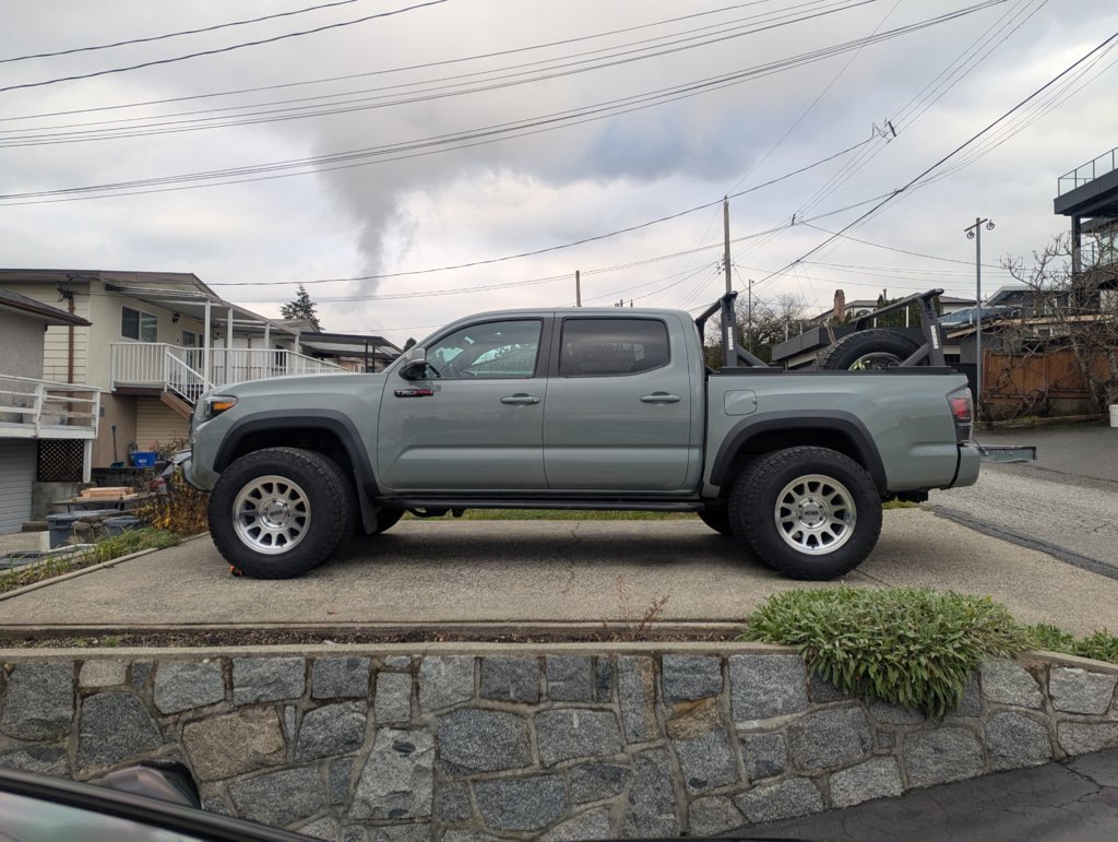

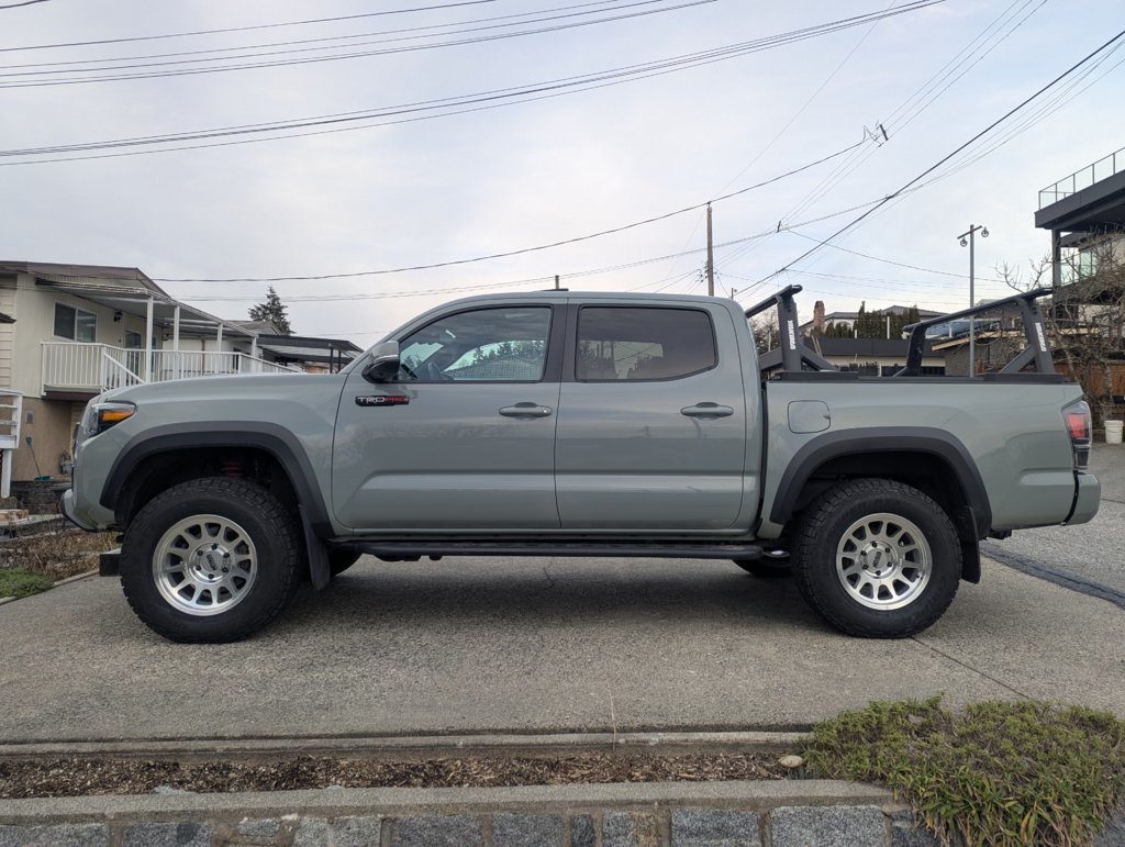

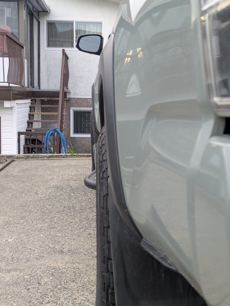

    Here are the photos of them mounted. I like the offset compared to stock
