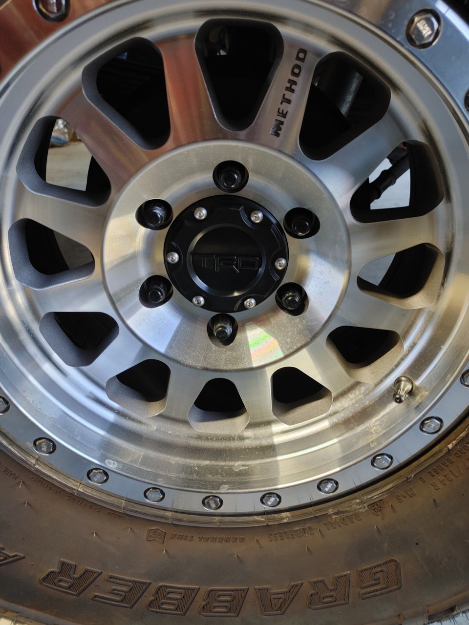

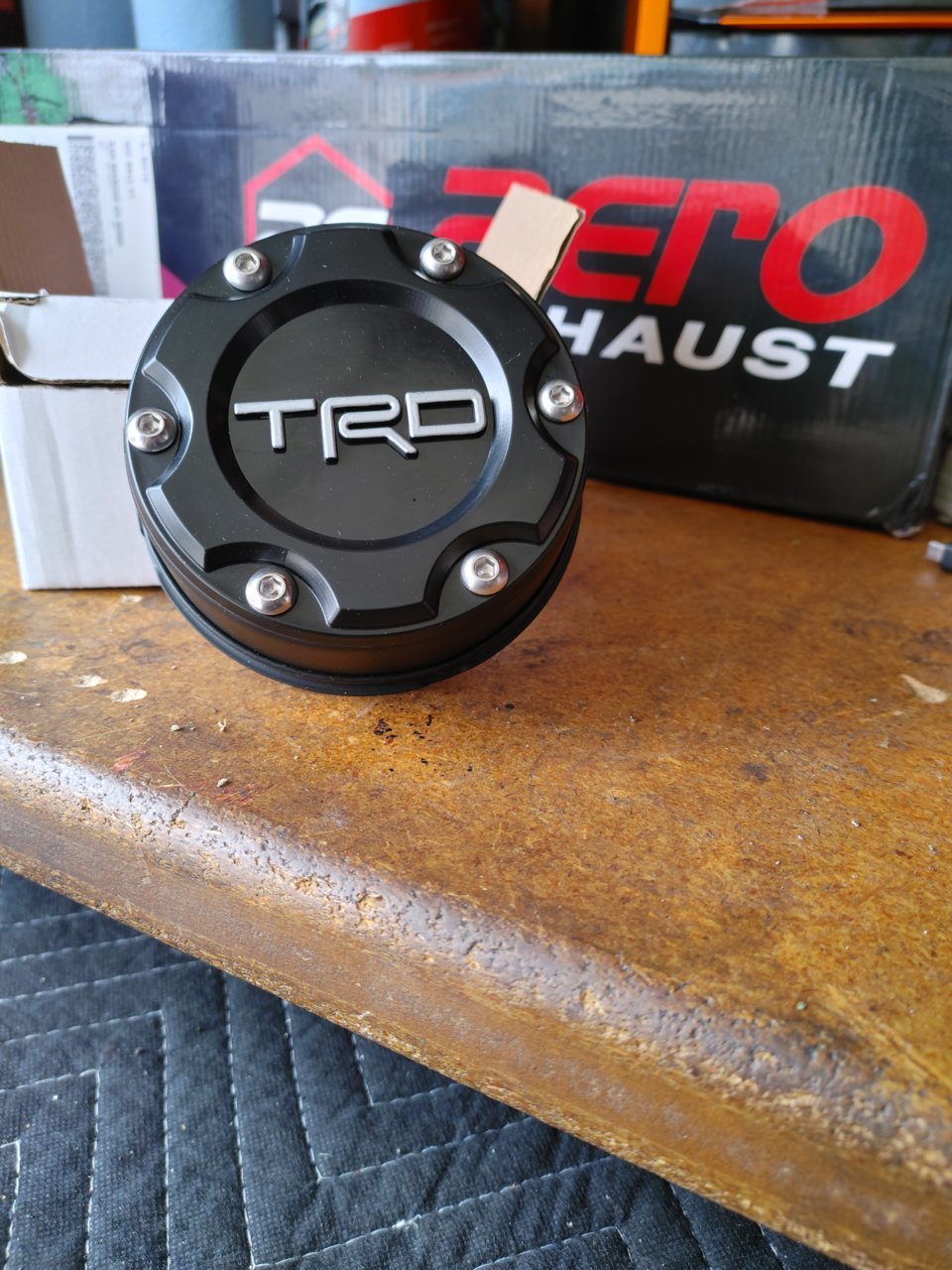

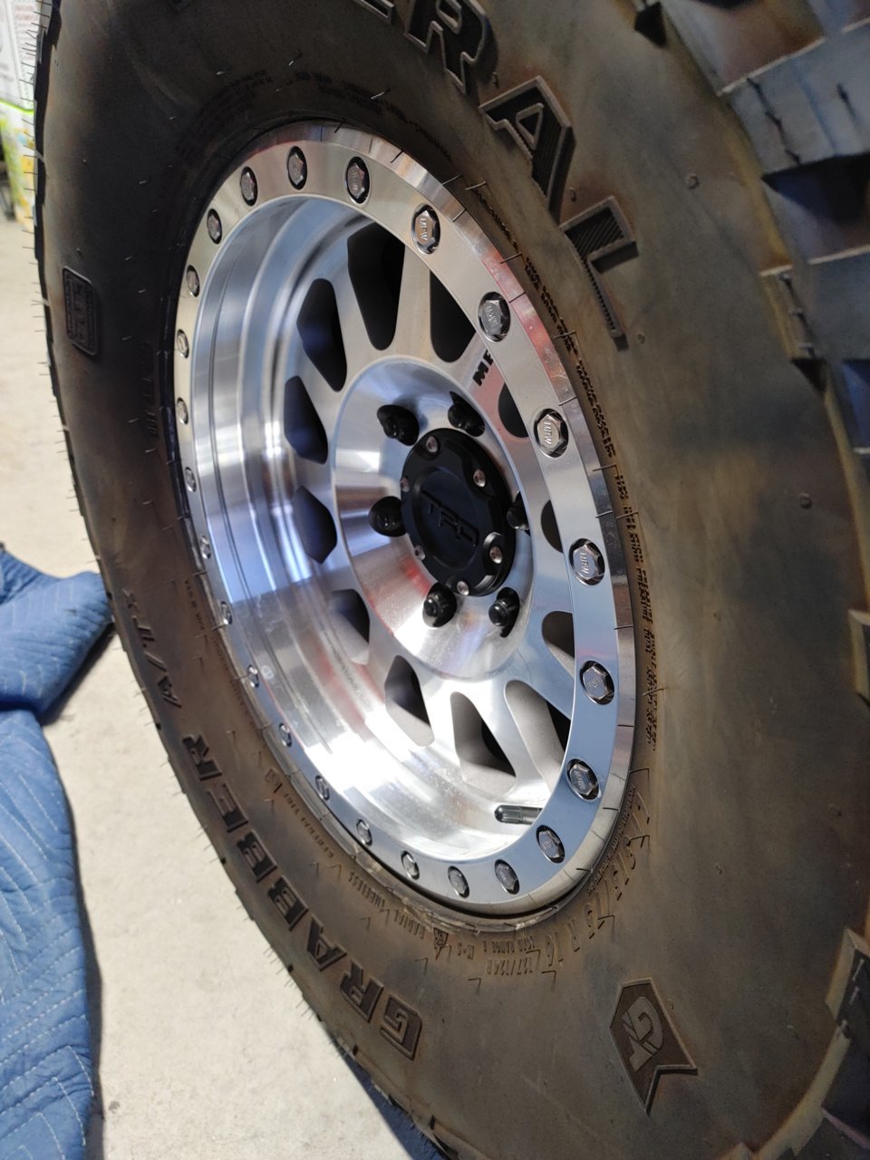

    Had to drill new holes with the flushmount method caps that i have...no biggie...

    How did you get them to sit so flush? They look great!

    I already had the flushmount caps from methods...but you can trim the original caps like a 1/2 inch and itll sit flush...just use a dremel and fold the end with a small channel lock pliers..

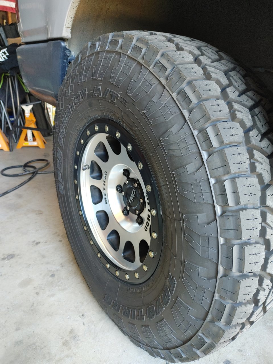

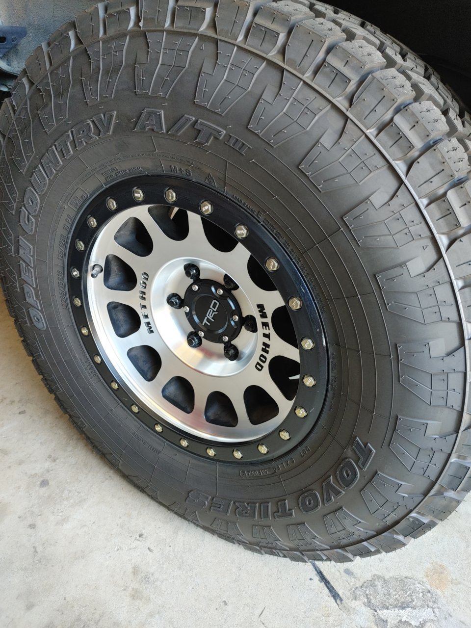

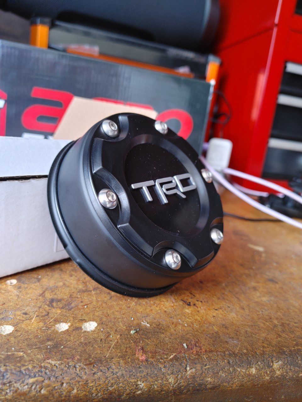

    Another set for the 4runner...thanks meso...

    What did you use to paint them, and what hardware did you use?

    Just a silver sharpie...theyre permanent markers and holding up pretty well...forgot the size of the bolts but got em from Amazon for like $8 for a pack of 50...its an allen head that usually comes with the light bars..

    Looks really good, i thought you out a vinyl overlay. I just bought some from some one on here but don't know what hardware to use, if you remember the size would appreciate it that way I buy the correct ones. Did you attempt to use the stock method caps hardware?
