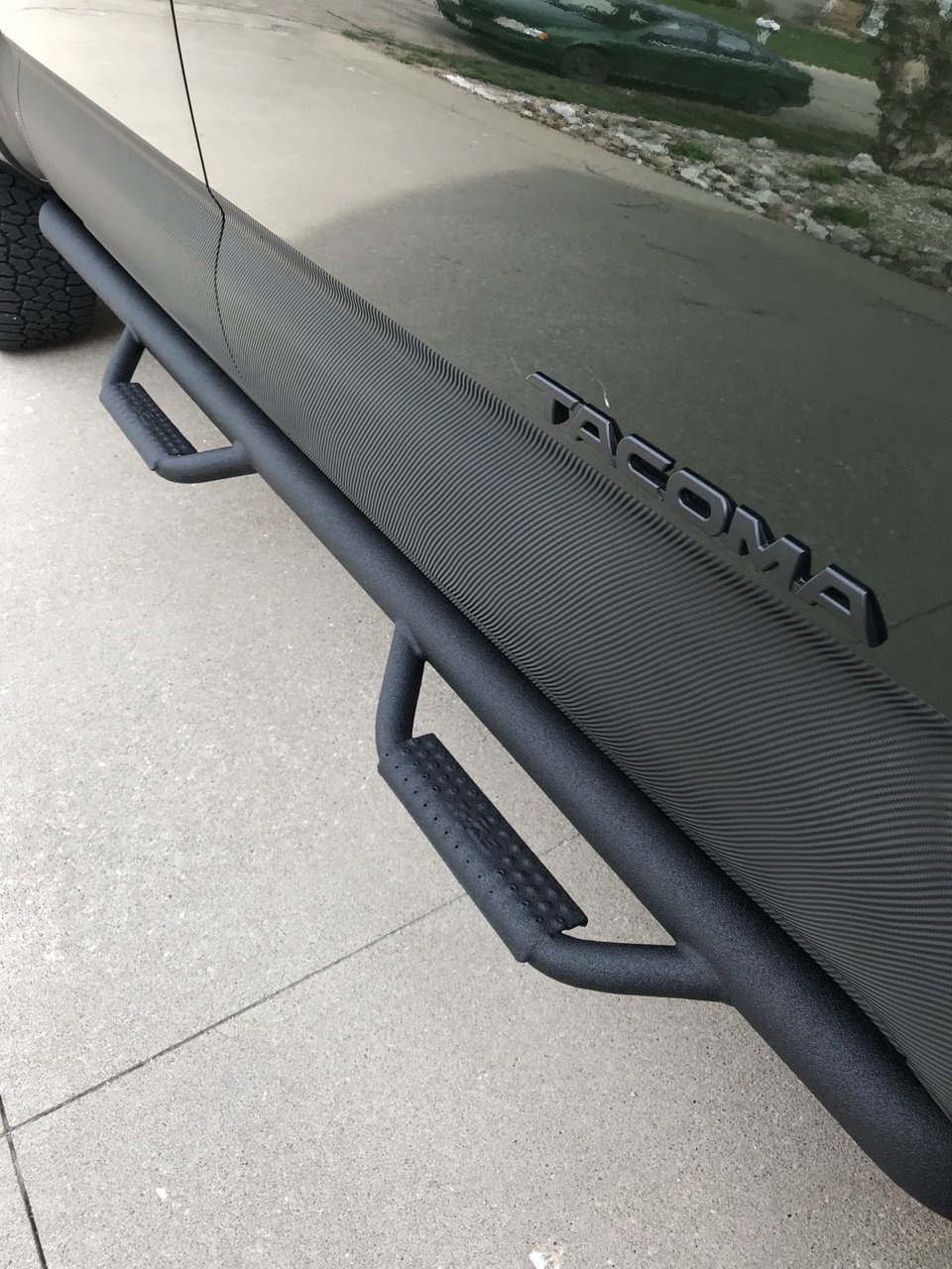

    Have them sprayed with bed liner, had my step bars done almost 3 years ago and no chips, dings or rust and I run a fair amount of gravel roads.6584B143-8077-409E-9EF0-80D7A8790154.jpgA5B97F42-A2A8-4543-ABBD-29A399E1097A.jpg
