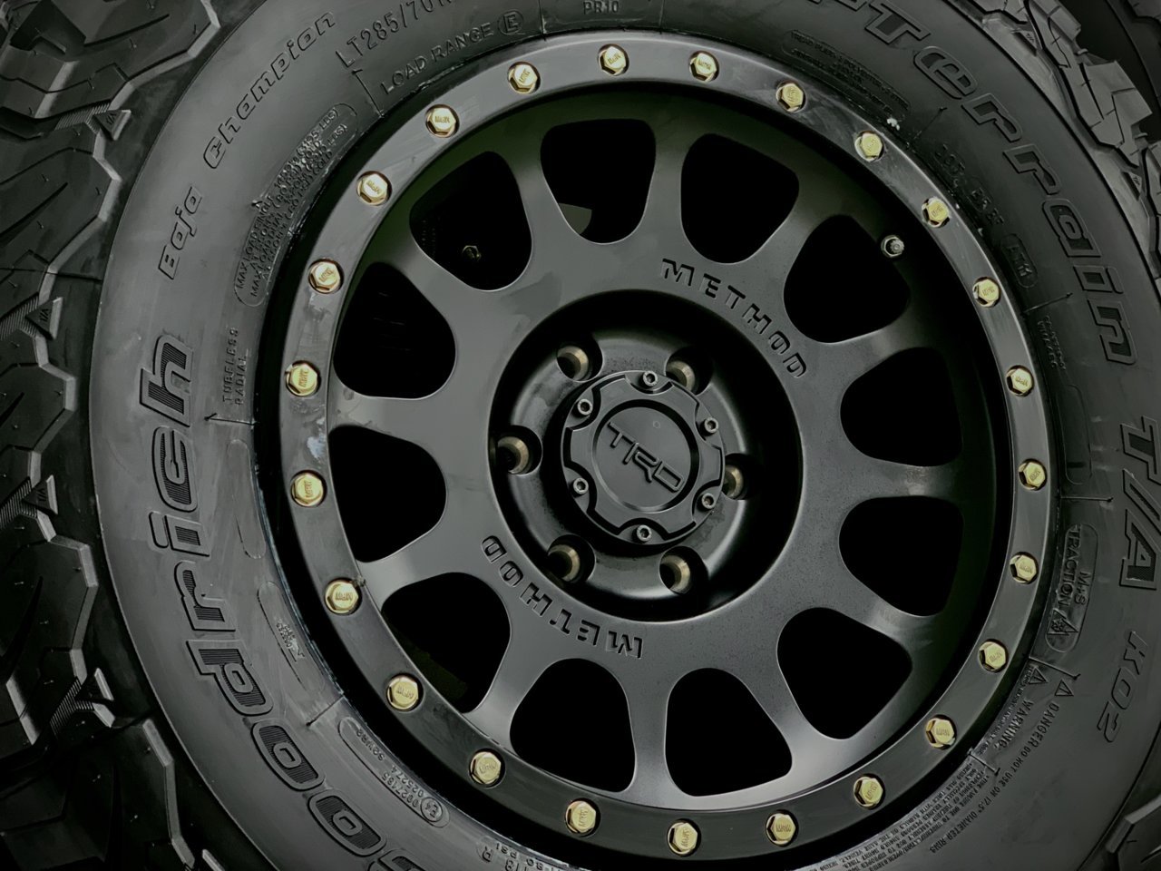

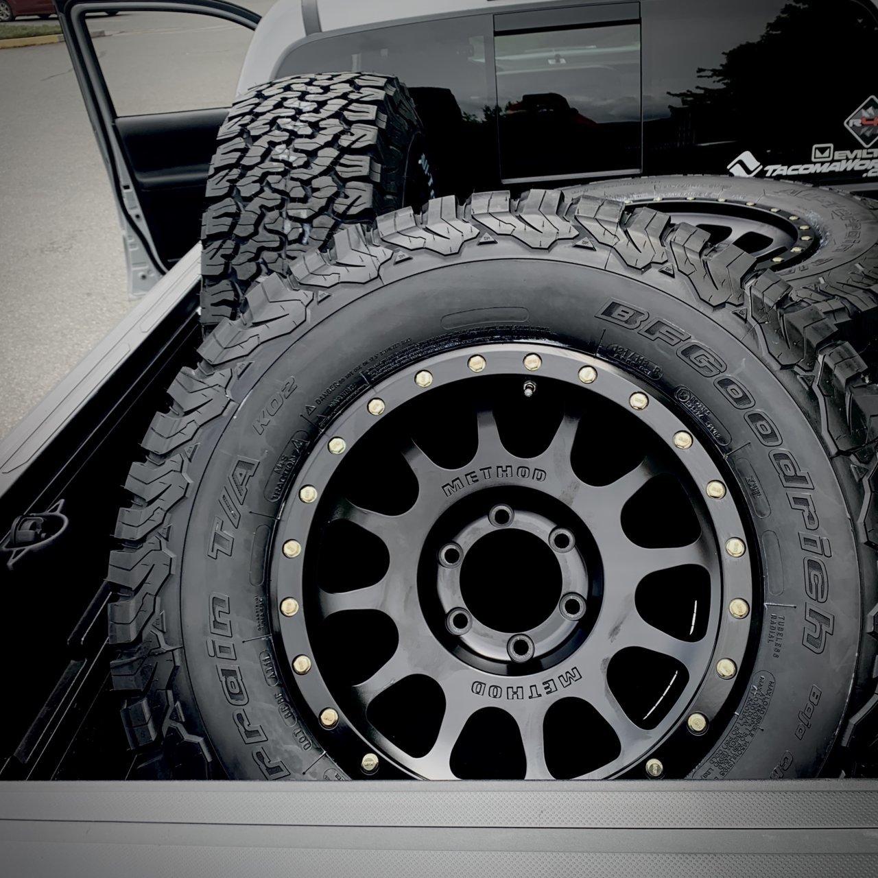

    I have been trying for about two months now to get a black bolt kit for my Method 305s. They have been “out of stock” for as long as I can remember. When I did get a reply back (in May) I was advised they would be available in June.
    No update on their site yet and I still haven’t gotten a response back (via email, IG message, and FB messenger).
    I was wondering if anyone else has this problem or is selling a set for 4 wheels. :)

    It’s a bolt. Pull one off, size it up, go order from any decent fastener store. Black bolts can be a pain finish wise left to the elements. So check your buying something appropriate. May even go with plastic since it’s for show only, not a fan of anodized black since it fades from UV, but an ally bolt anodized black might also be a good choice for a wheel.

    Pull em off, paint em

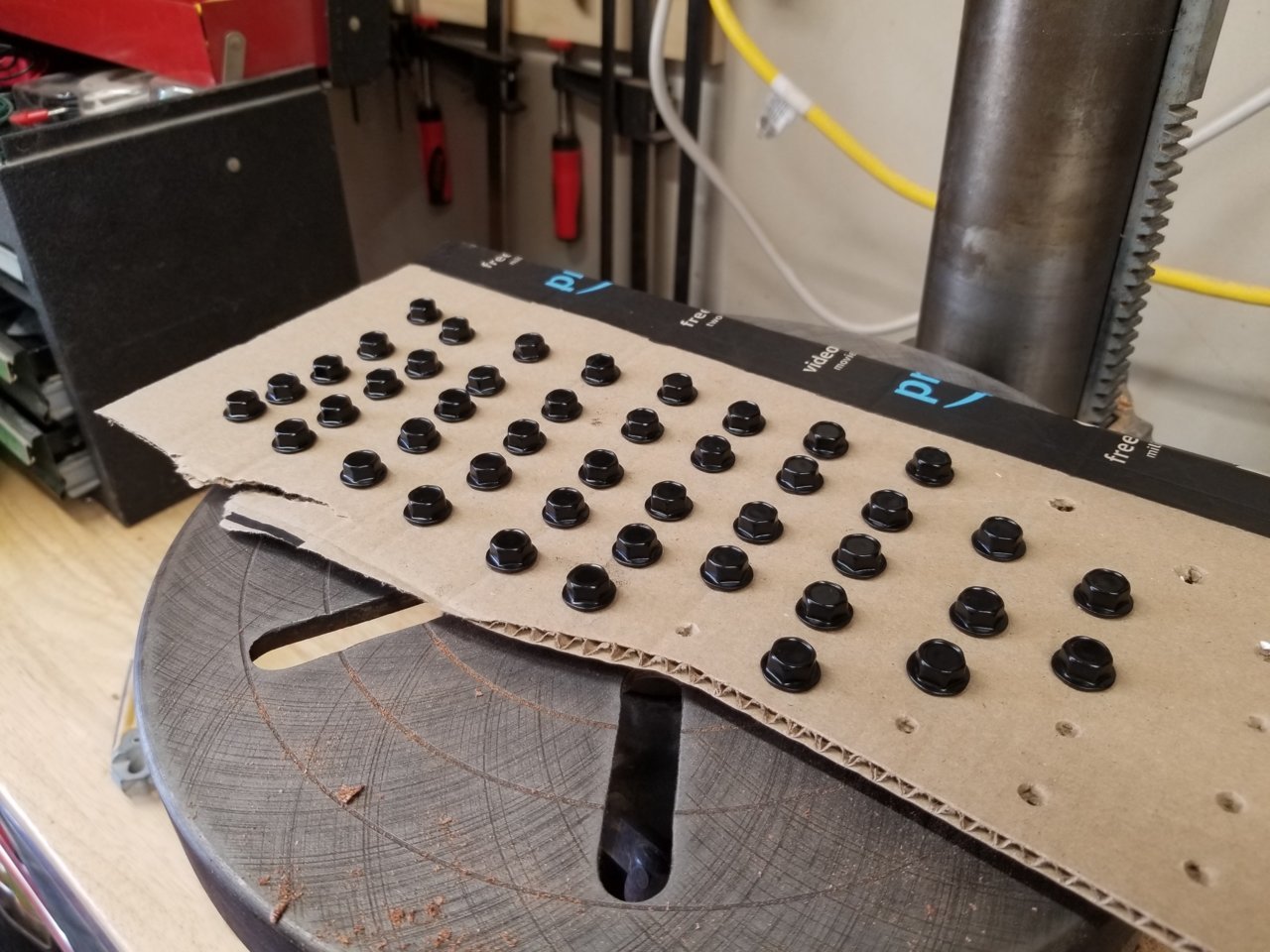

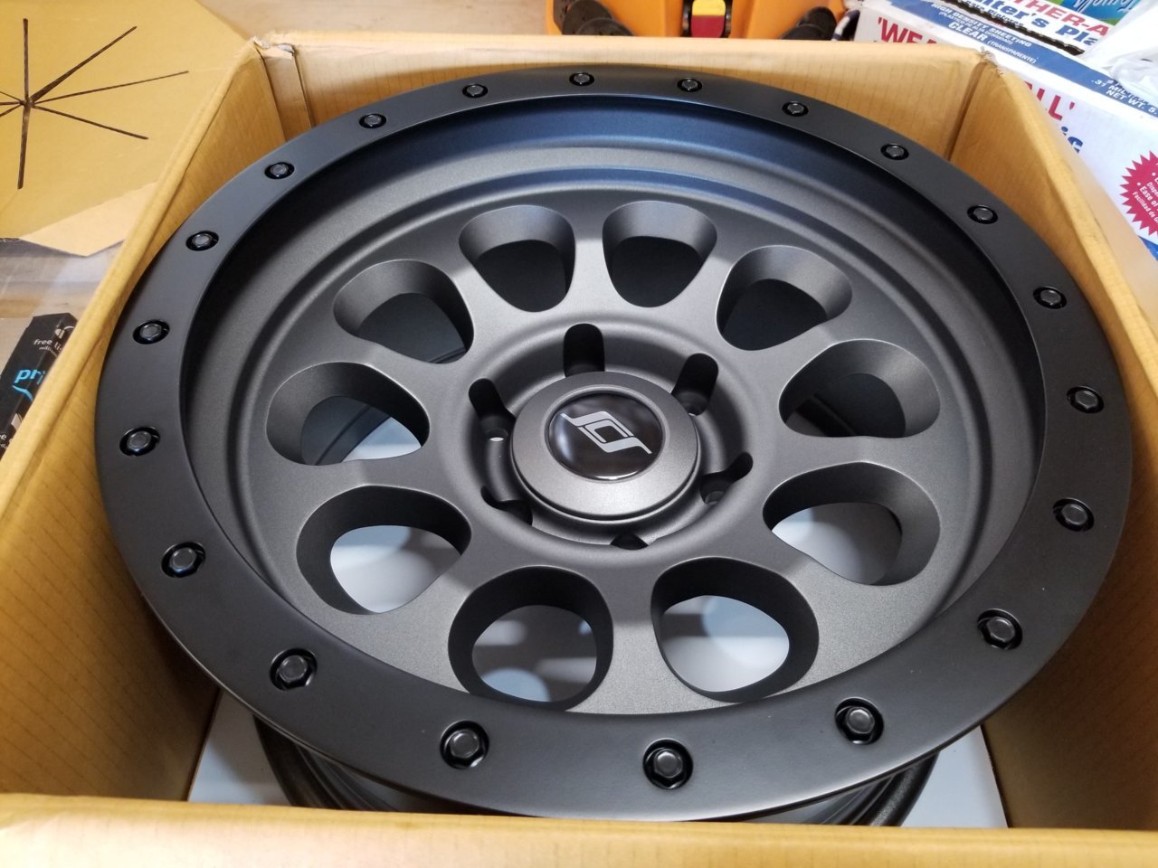

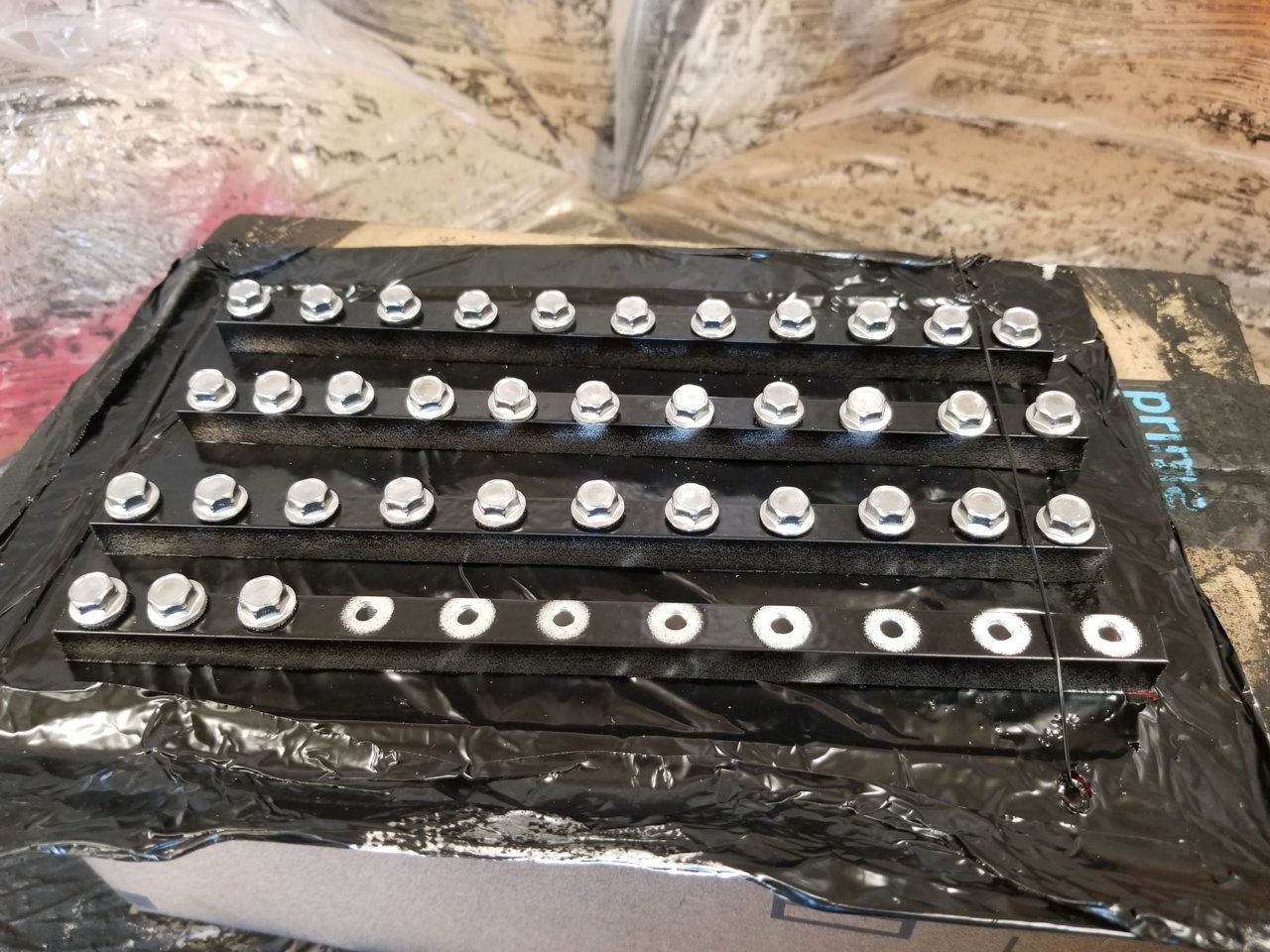

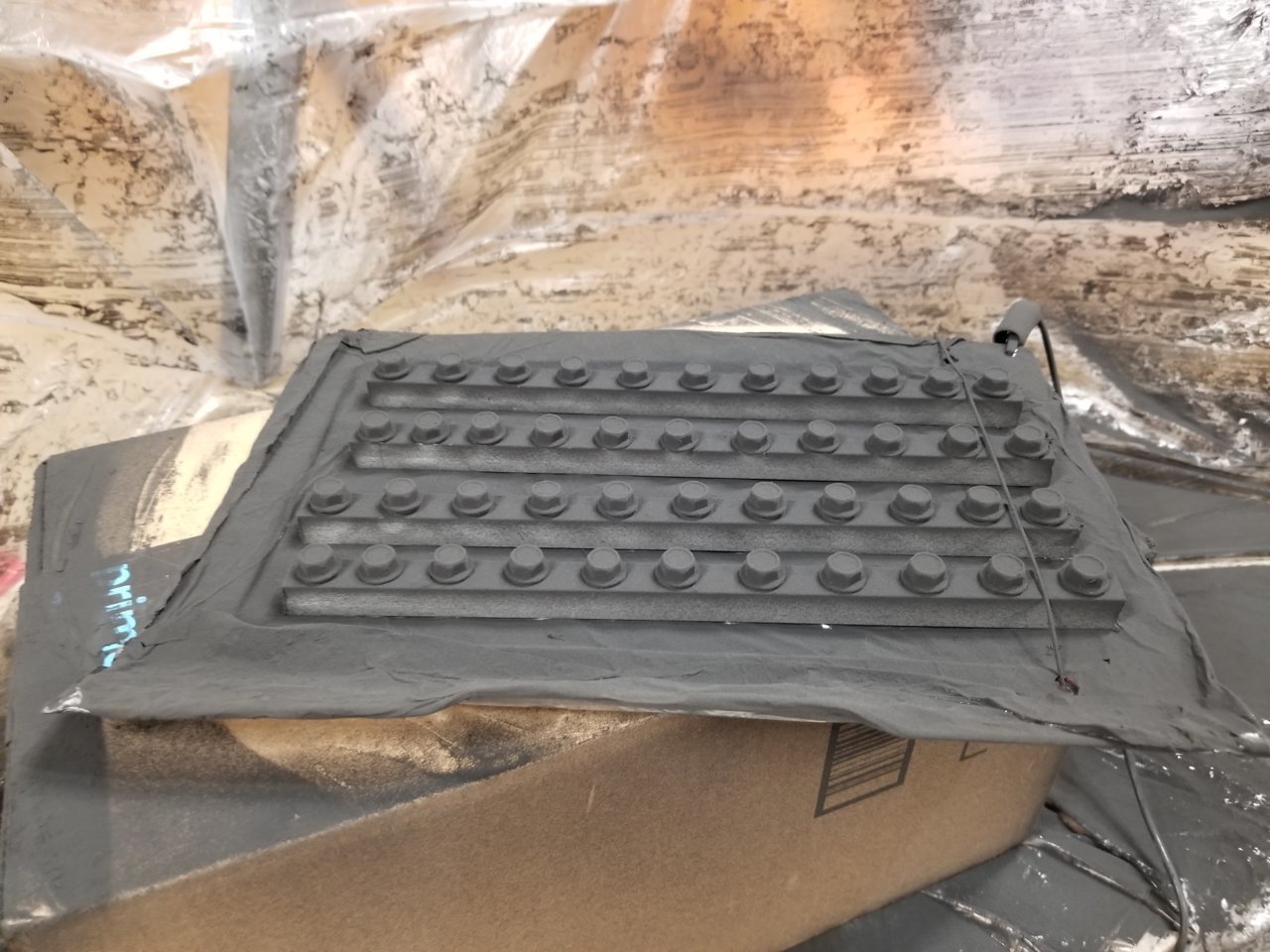

    I powdercoated mine. HF sells PC kits. Just need a compressor.

    what did you think of that powder kit?

    It has its limitations and you won't get a professional quality finish on large flat surfaces... but for something small like this, it's perfectly suited.

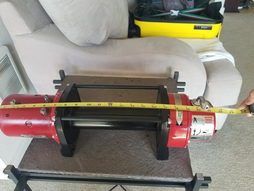

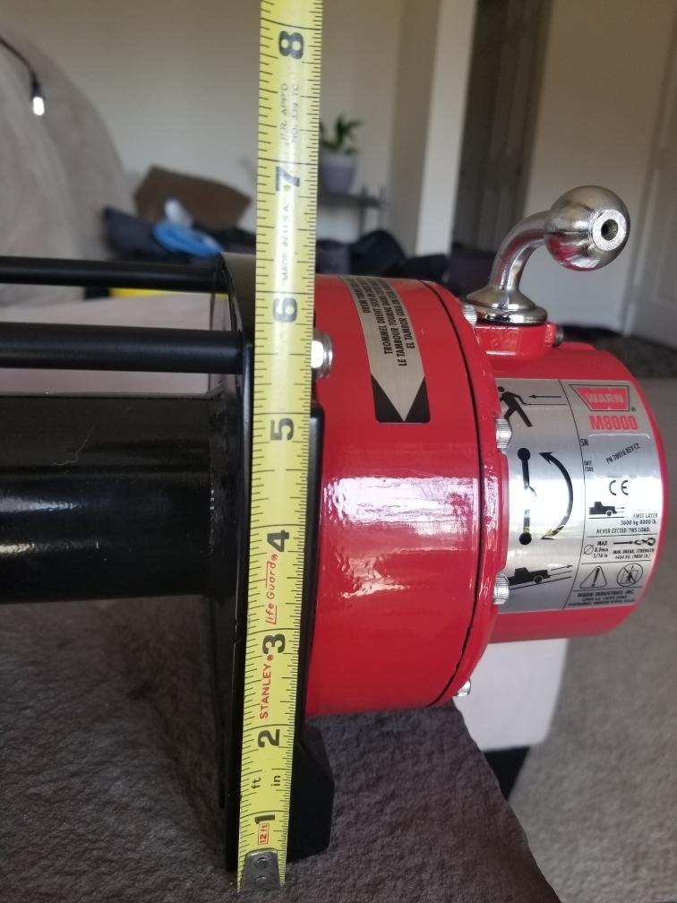

    I also used it to powdercoat this winch when I restored it. Not show quality, but pretty damn good for a home jobber.
