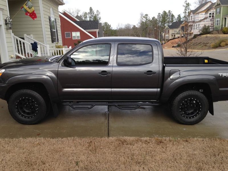

    i have 301s. 16x8 0/4.5BS no lift.
    no rub for me on 2013 4x4. local 4 wheel parts swore they would never fit (wanted me to bump to 17), but Method said they would fit and enough people on here had them so i went ahead and got them, had someone else install.

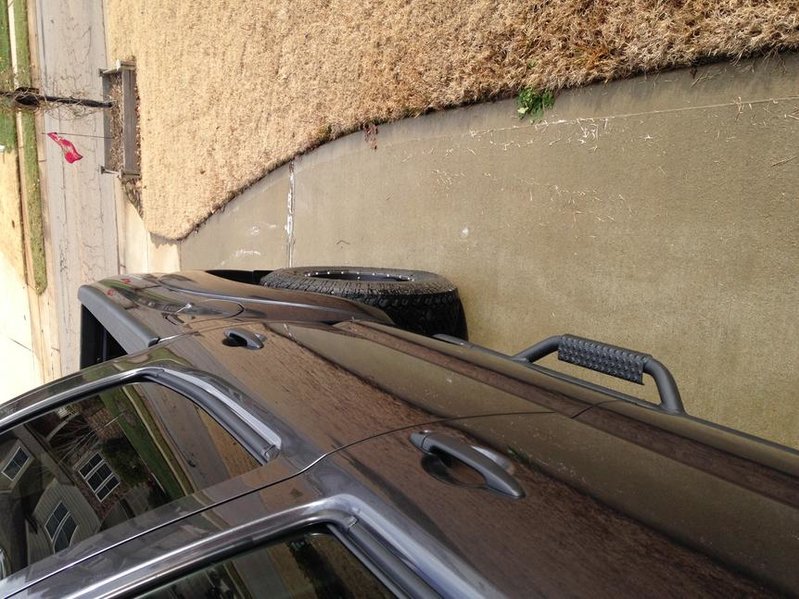

    my tires are stock (265/70/16). they stick out maybe 1/4 inch. this is only pic i have, not sure how easy it is to see here, but they do stick out a little. i'm in holly springs.
    don't know why it keeps flipping my pic, sorry.
