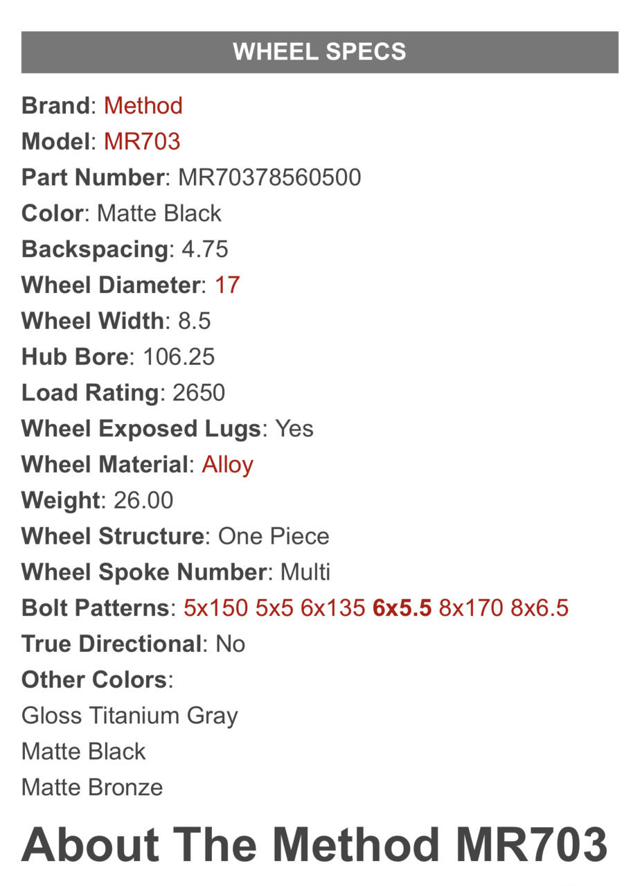

    Do these fit on the taco without hub centric rings? I believe our hub bore is 106.1 and the menthols are listed as 106.25….
    can anyone verify if these fit the hub bore without any play. Thanks

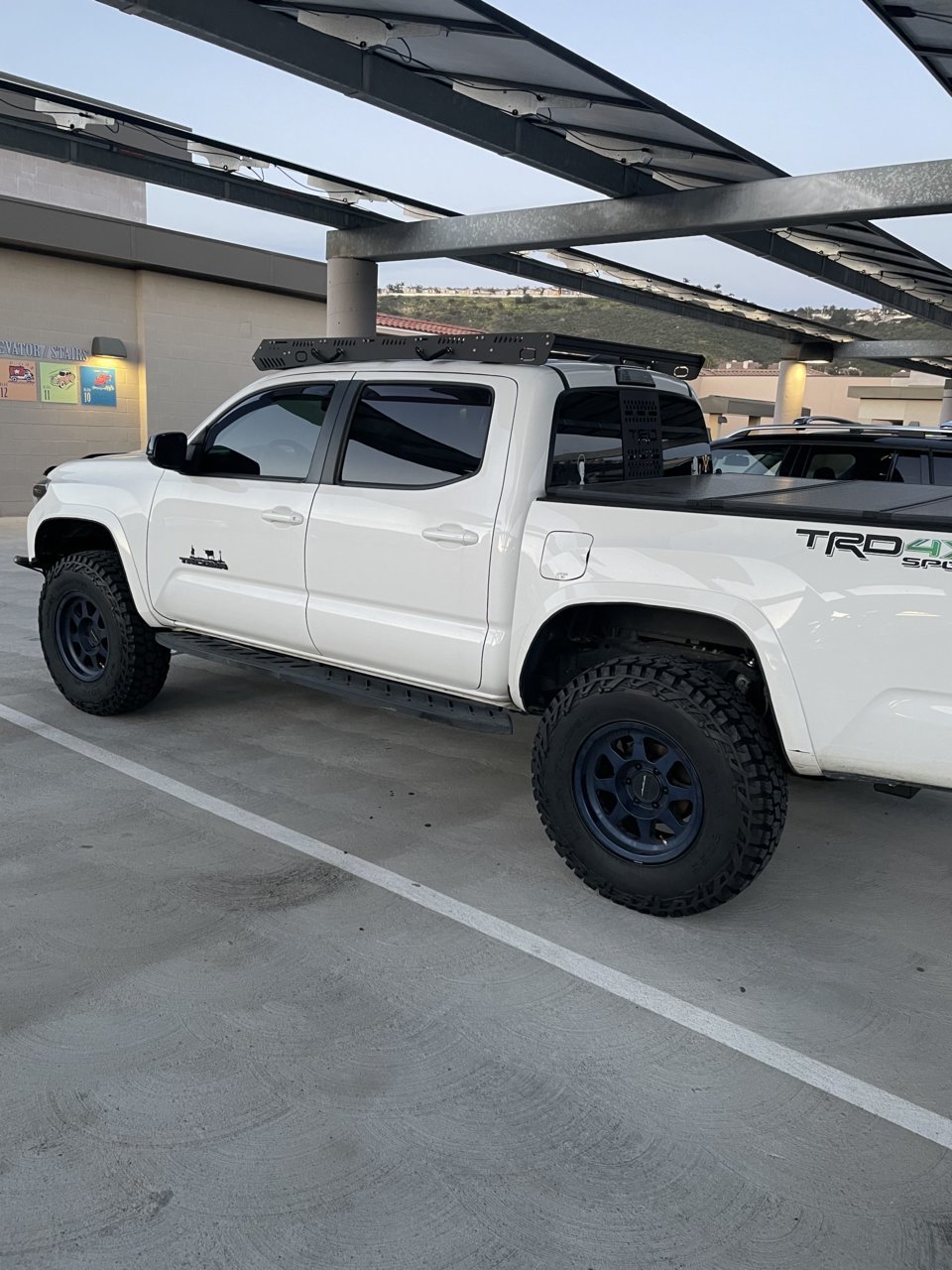

    I bought these when they went on sale from Tacoma Lifestyle. They fit fine with no issues whatsoever.

    I have 701's and they use a 60 degree taper lug nut. They are not hub centric. When Method says lug centric fitment I think they just mean the center bore will fit over hubs/flanges that could use hub centric wheels. You cannot have both hub centric and tapered lug nuts. The lug nuts for hub centric mounting need to be flat flanged. The wheels will work worth out the rings. Just make sure to use extended length lug nuts. They can purchased from Method, Discount and other shops but I found the best prices from Wheelers. The nice thing about Wheelers is you can get them in quantities of 4, 20 or 24. Buy a set of 24 and a set of 4 for spares. One thing I like about the 701's is the location of the valve stem. It comes thru where the wheel material protects the stem better. My theory is that there will be less of a chance for the stem to be damaged.

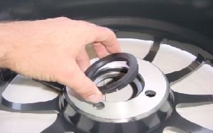

    I have the 703’s. They came with four plastic rings but I have no idea what they are for. Certainly not needed for our trucks though. I did buy the extended lugs. Super happy with the 703’s both looks and performance wise.

    Those rings are hubcentric rings they go on the hub, bore free, tight fitting wheel if needed some wheels have a different size bore then the vehicle they go on

    none, that size is made to fit tacomas perfectly. I’m not sure what your hesitation is
