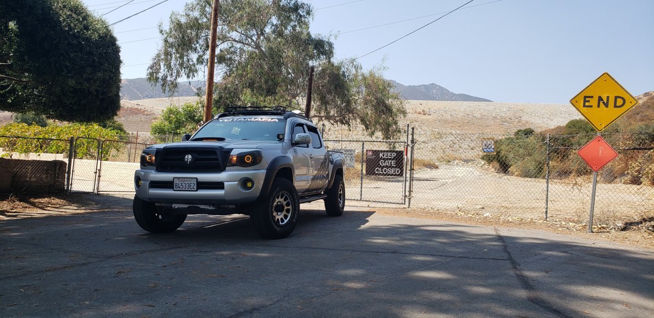

    Got them mounted at your west covina location. Excellent service as usual20200825_143755.jpg

    Happy to hear that @VYPER - thank you for your support! Your truck looks great :thumbsup:
