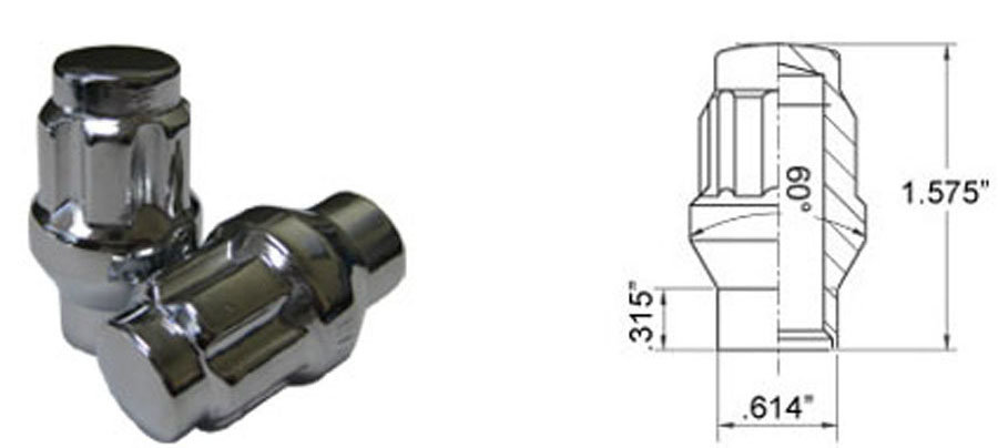

  13. Jun 2, 2018 at 2:17 PM
    batong_23
    batong_23 vincedprince
    May 29, 2017
    #220176
    1,365
    SoCal
    2017 white toyota tacoma trd sport
    Conical??
  14. Jun 2, 2018 at 2:27 PM
    Kyitty
    Kyitty Mr. Beard
    Feb 20, 2015
    #149179
    9,586
    Bozeman, MT
    2015 Tacoma DCLB Better Than TRD
    See Build Page
    Cone Shaped Extended Thread
    Ignore the measurements. This just shows how it is shaped.
    The tapered shoulder is good for Method NVs because it helps center the lug in the hole in the rim. Tacomas are Hub Centric, but the rims are not. The conical lug nuts help prevent the rim from wobbling and therefore prevent vibration on the road.
    I originally had the factory lug nuts on my Method NVs. Lots of steering wheel wobble.

  17. Jun 4, 2018 at 7:20 PM
    #17
    Evenflow
    Evenflow Well-Known Member
    Jul 15, 2013
    #108344
    5,516
    Jason
    San Diego, CA
    06' DCSB 4x4
    Yes
    No, that is the “ ET” part that you absolutely do need
    Kyitty and batong_23[QUOTED] like this.

  19. Jun 17, 2018 at 10:19 PM
    #19
    Sauzacoma
    Sauzacoma IG: @Stancaban
    Apr 18, 2017
    #216580
    193
    Southern California
    2017 TRD Off-Road (DCLB)
    Okay so where can i find these ET lugs? I was looking on 4wheel parts.com and then ended up goin to autozone. I didn't see any with the ET on 4wheel's site so I just got the kind that ends with cone. They seem to work but I do feel uneasy about how they're seated in the cone of the wheel's lug bores.
