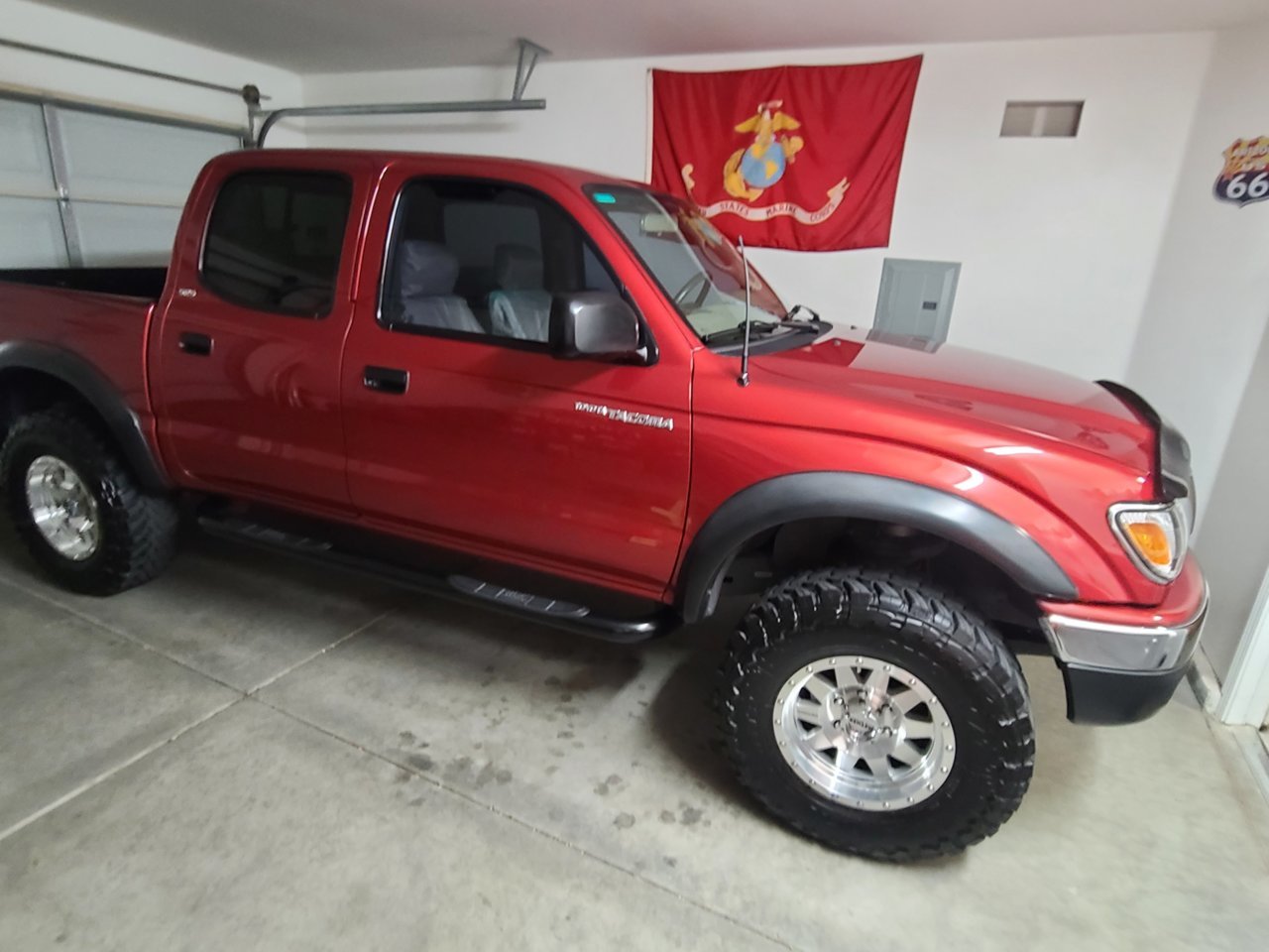

    I've got Method racing 301's on my 02 DC Pre Runner and I'm having a hard time keeping tape weights on the wheels . The longest they have stayed attached to the inside of the wheel has been 6 months and the quickest they lasted was maybe 3 months
    Today I went to my local Firestone to get my tires rotated and balanced and the tech informed me three of the wheels had no tape weights on them but showed evidence that they were there prior
    The last time I had these wheels balanced was March of this year but started seeing wear on the tire and vibration was In July this year . Each time the tech uses an abrasive wheel to clean the area for the weights and then use brake clean to clean the area completely . I even had the techs use duct tape over the weights the last two times . This is a dirt track trick to keep from losing the weights
    Any idea why these wheel weights won't stay on the wheels ???
