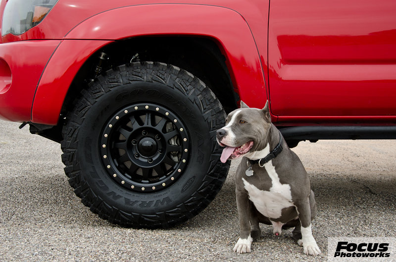

    Not plasti-dipped, but I have those same wheels in black.
    Not my truck or my photo, but you get the idea. Be careful with those bolts, BTW. I had to remove mine every time I got new tires and then replace them before the wheels got balanced (due to the smallest differences in bolt weights, it could throw your balancing off). I got tired of doing it, so I just took them off and left them off. I like the look better
    The way my tire shop had their tire mounting machine, it had a roller that would ride on the lip of the wheel (right where the bolts are). My tire shop advised removing the bolts to prevent potentially breaking the heads off. I only know of one person that this has happened to, but an ounce of prevention and so forth... Up to you. Might be a PITA to drill out the broken bolt and replace it if that ever happened.
