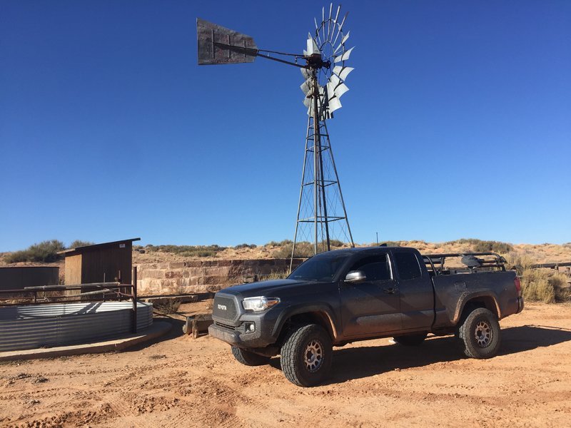

    Here's a pic of mine with that setup (not that there aren't 1000's of these posted elsewhere).

    She's a beauty. This NV style got my eyes as well as the VEX. Thanks again for the reply and the info and pics.

    Thanks. I really like them too. I'm running 35's on them now.
    The only thing I don't like, I guess a lot of fake beadlock wheels have this, water pools in the lip and unless you dry it, it never goes away. Just makes your wheels really dirty.
