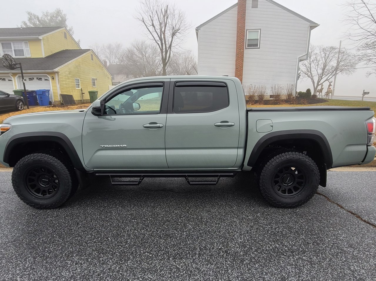

    What is the offset and size wheels. That’s a nice looking truck

    17 x 8.5 No offset. Falken Wildpeaks 265/70/17

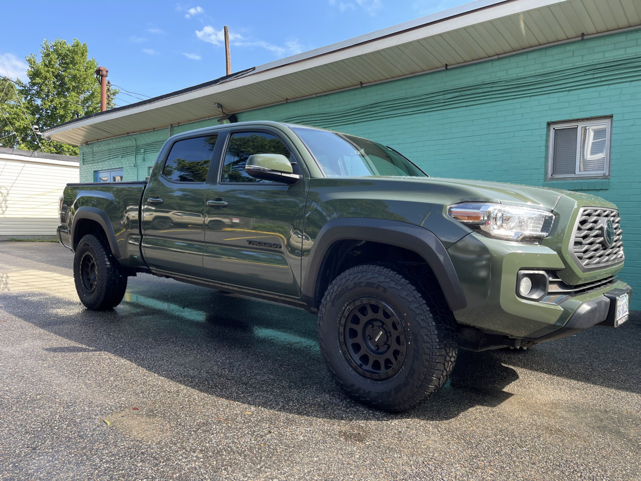

    605AEB1F-F82E-4F77-8743-D3A8CAB3B615.jpg AB5CB1B1-5F29-493F-B1AC-FCAA5A8DBB45.jpg Method 305"s on 265/75/16

    Just to confirm this is stock with no rubbing?

    Stock height, One size bigger tire 265/75/16 and the method 305s are 0 offset

    no rubbing
