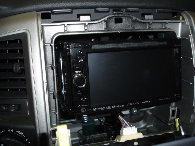

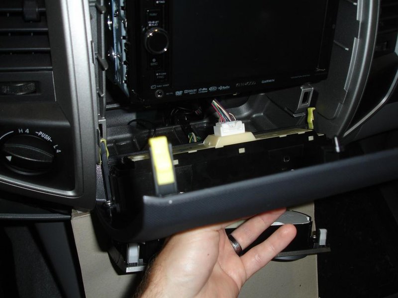

    Here are some photos. The first one shows the HU itself. It has the factory metal brackets attached and then bolted back into the truck. These are the only things that hold the HU in place. The second photo shows the back of the dash kit. There are four clips that go into the slots in the dash and these hold the dash kit in place. The dash kit does not actually do anything to hold the HU in place, it just covers the hole. Sorry I couldn't get better angles, I didn't feel like taking everything apart again.

    You are correct. The faceplate does not connect to the HU. How does the faceplate on your Metra kit fit? Mine is horrible!
