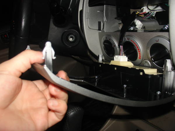

    i put everything back together but I can't get the metra dash piced to snap in place. I can literally pull everything off with my hand. Is there some trick to snapping it back on?

    did you put the little clips on the 4 tabs on it?

    x2 i had the same problem you did and that was what i was missing.

    yeah i cant remember if the kit comes with them or if i had to use the ones off the stock piece.

    I used the stock ones, yellow if I remember correctly.

    yup you would be correct

    thanks fellas, thanks for the quick response
    you mean the small white ones?
    OK ... I just did this, yall are on point.
    THX

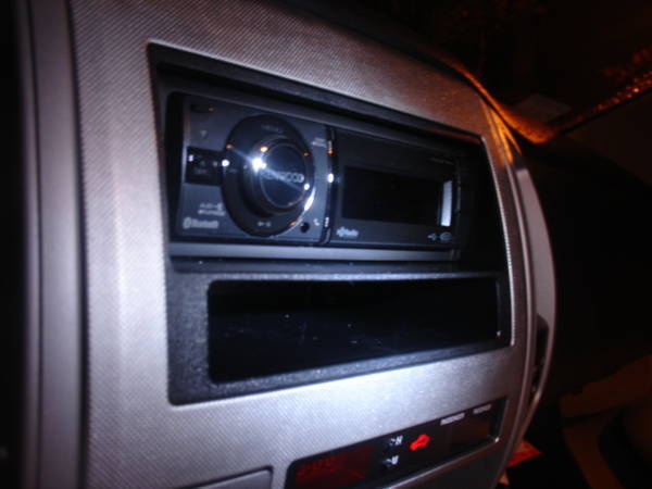

    thanks again,
    finished piece

    anytime, and good job on the install, looks nice.
