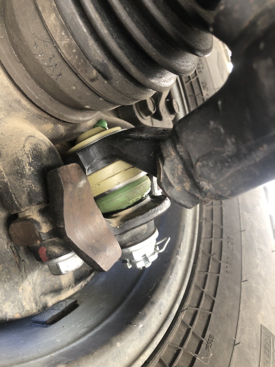

    I just installed these in my truck last week along with all new bushings and UBJ. So far so good. I hope they last because I don't think they will ever come out without some serious cutting of them (the flange). They have a larger bottom flange than OEM and the OEM already didn't leave enough room to use a ball joint press to remove it. One thing to note is that you will likely need a 90 deg grease gun adapter to grease them. I didn't have one on hand when I installed mine, so I had to grease them before putting the CV/axle back into the spindle. Took about 25 pumps and the boot started to balloon just a little and they've held the grease just fine as far as I can tell.

    looks very good
