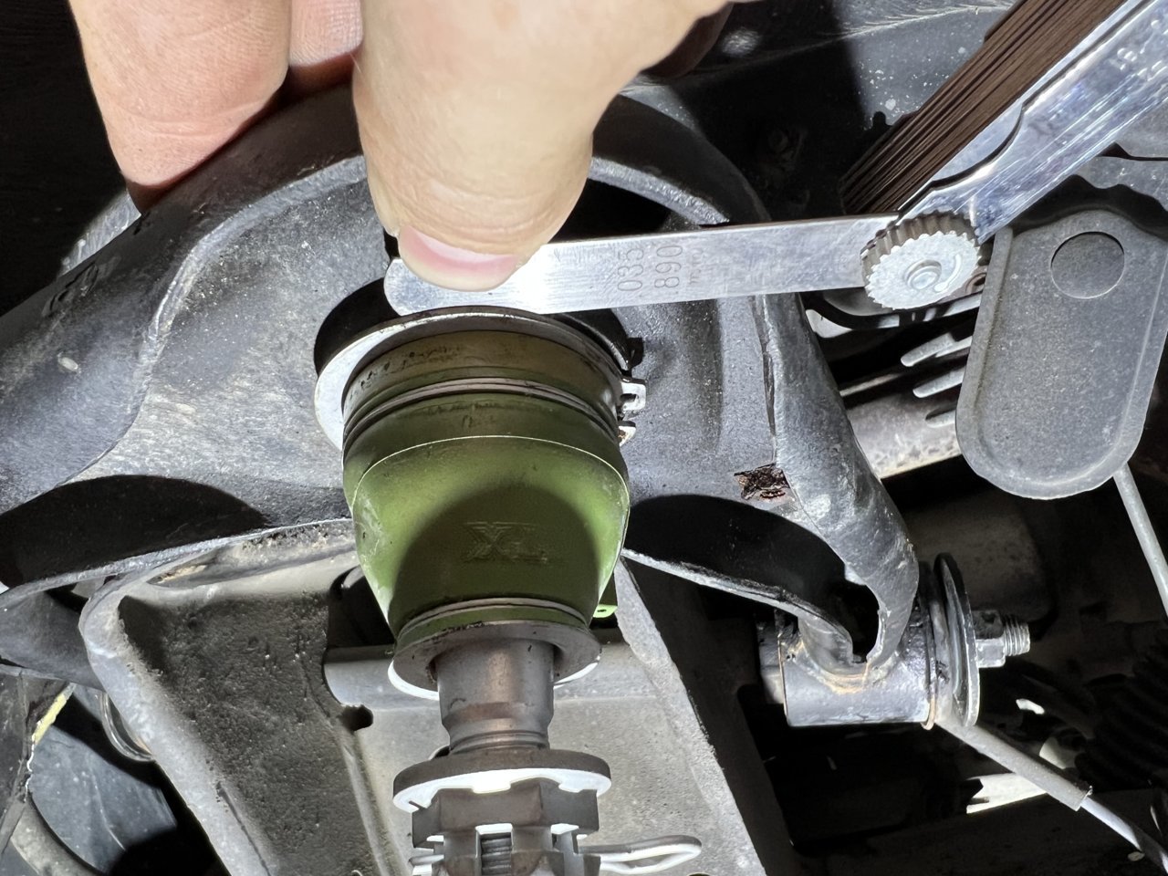

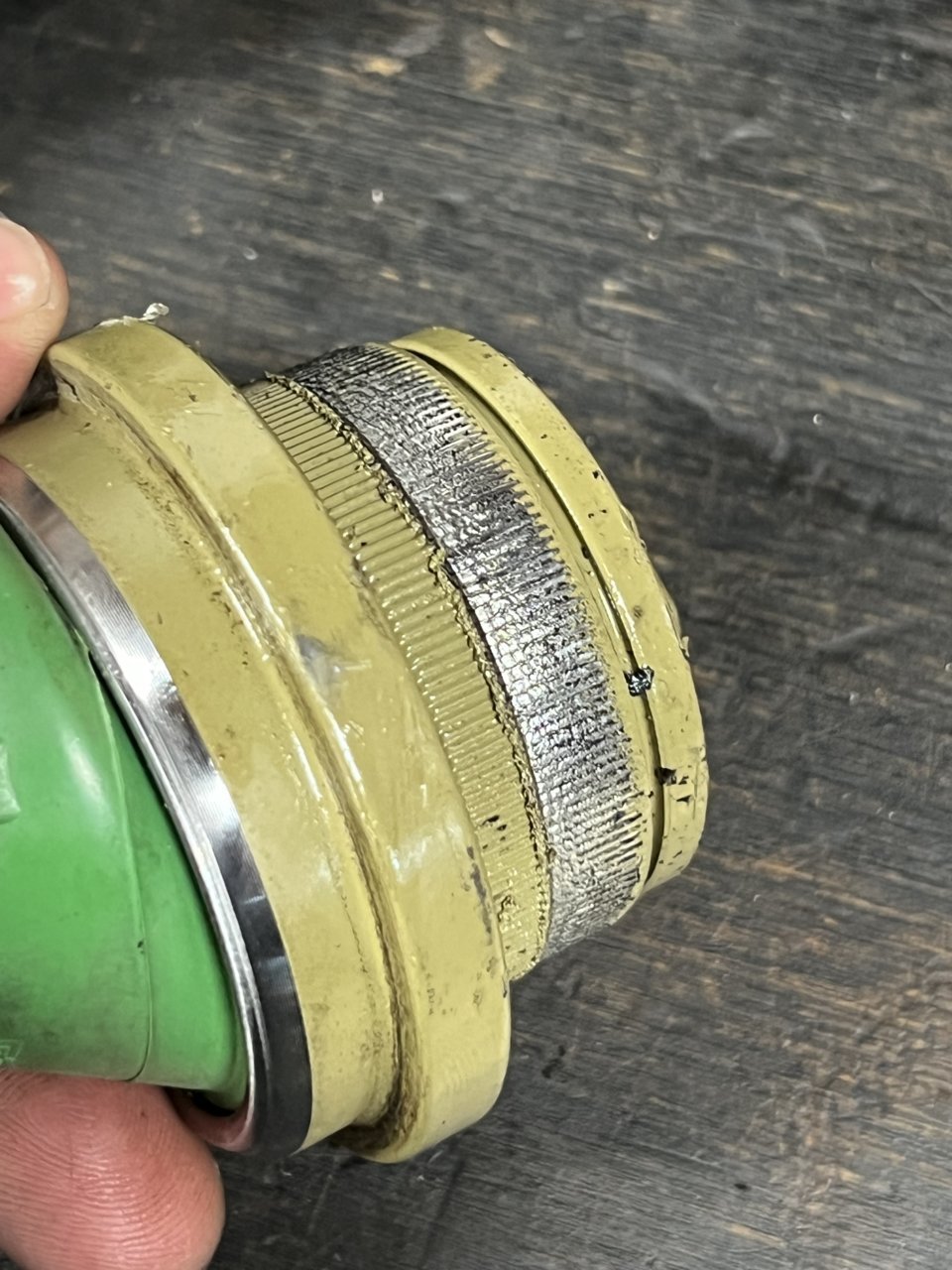

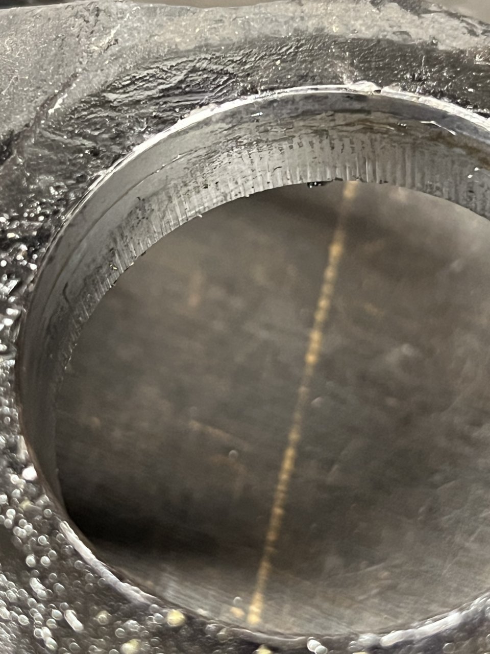

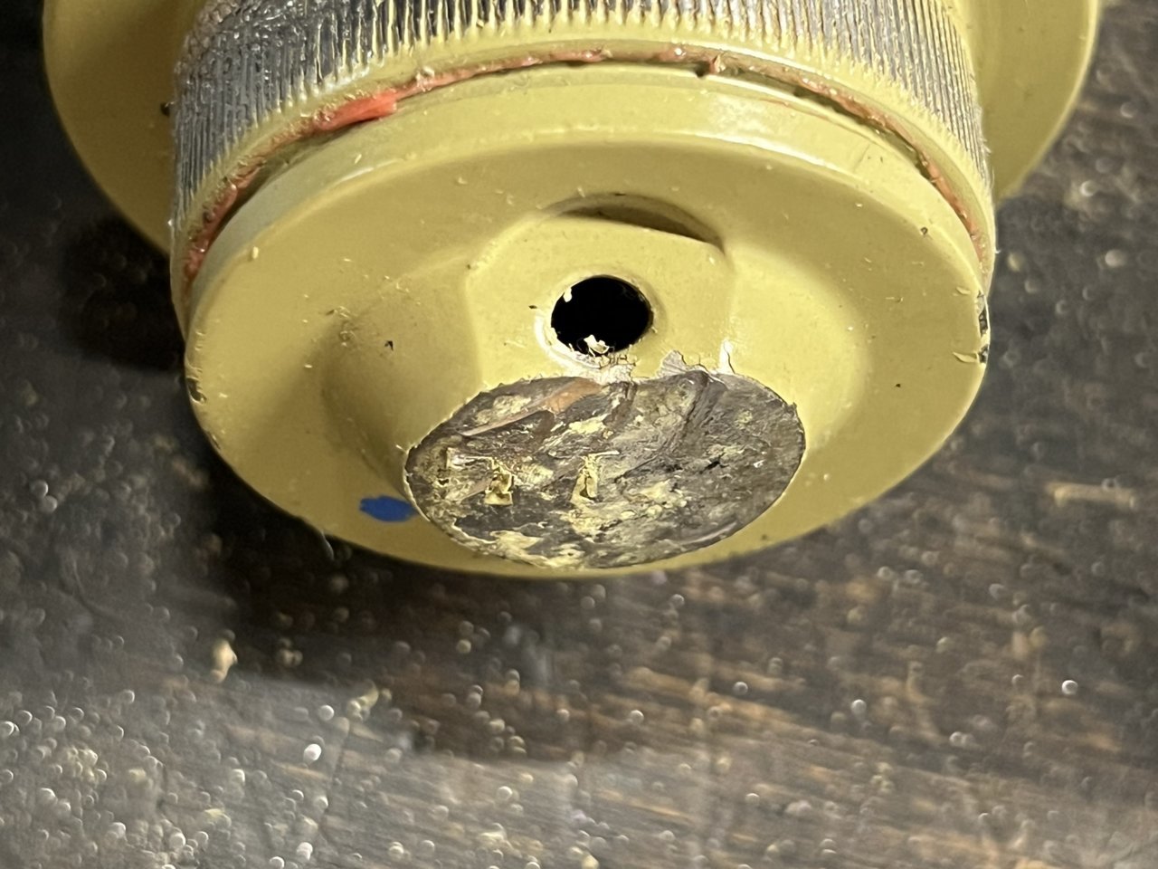

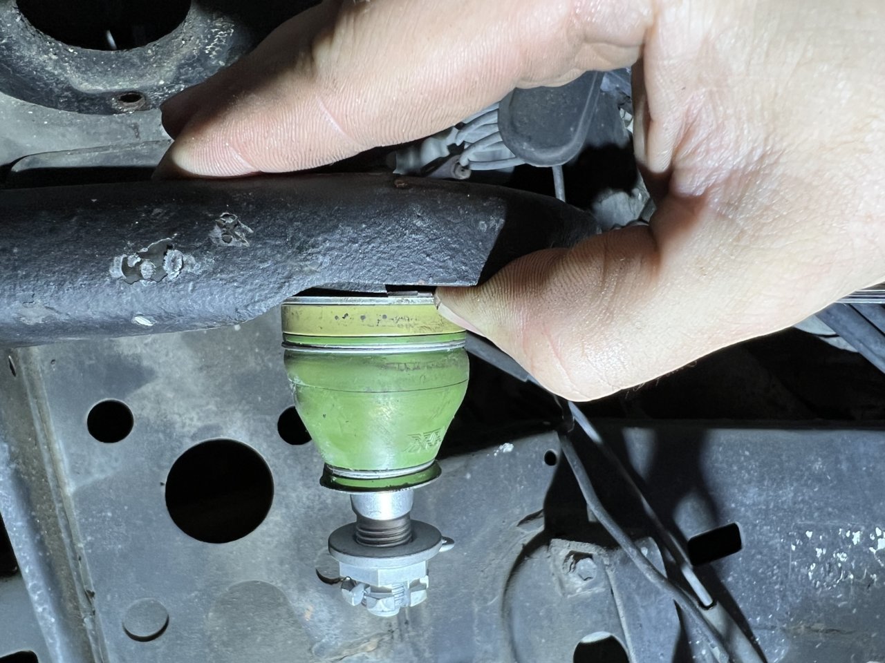

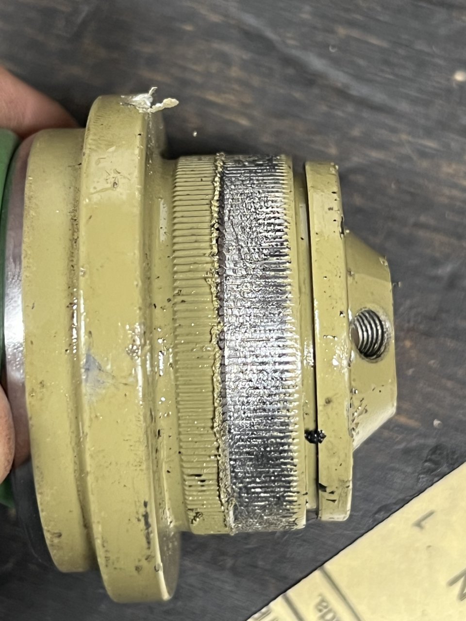

    I'm replacing the ball joints on my 2008 and wanted something that will last, so I bought the highest rated line I could find: Mevotech TTX. They are also the most expensive by a landslide. I spent about $200 after tax and shipping from Rock Auto. I used parts: TXMS86568 and TXMS86527. I've replaced ball joints on 2nd gens a handful of times and never had much luck with anything other than Toyota OEM (most wear out in a short amount of time), but I heard good things about the TTX lineup so I figured I would give them a try.
    How they failed:
    The lower ball joints on the LCA are the worst offenders. They are too large in diameter to press in. I greased the control arms and used a 12 ton hydraulic press that maxed out and couldn't do it. I tried to press the ball joints back out but they broke my ball joint press adapters. I had to use a BFH to hammer them out and in the process not only did this destroy the ball joints, it bent the hardened steel jaws on my Yost 6.5" mechanics vise.
    The uppers don’t fit either. They are too deep and there is a gap larger than 0.035" between the circlip and the control arm. With how tight they fit this might not be a show stopper, but the circlip should be snug against the control arm. This gap means the ball joint could move, and if it starts moving it could destroy the control arm and fail catastrophically during use.
    Like I said, I've replaced ball joints on these trucks several times without issue and have replaced ball joints on countless other vehicles. Pressing out old ones can be a PITA, but that's not what happened here. These are brand new ball joints touted as extra heavy duty but they don't fit the advertised application. I'm out a $100 set of adapters, $200 in ball joints, countless hours, and likely my control arms. I don't see them holding onto a ball joint tightly again after this endeavor.
    I'm going to be contacting Mevotech to see if they have any thoughts on this.

    edit: attaching a picture of the LCA for clarification. These are the ones that the lower TTX ball joints didn’t fit in and likely got stretched out

    Wow man, that's caca for sure. Those look like they were way out of spec, OR your LCAs were - just out of curiosity, are you sure they were OEM LCAs?

    They are definitely the original control arms. Original bushings and ball joints for sure.

    Took some oem LCAs to a shop to have some of these ball joints installed. Guy said he he had to use a 20 ton hydraulic press from another shop to get them into the LCA. They’re installed on my truck now, haven’t really driven the truck at all with them but they look cool. Hoping they last for a long time.

    He said they didn’t go in smoothly either, went in with a loud bang. “They both almost killed me”

    Those are $773…but what’s the point? Aftermarket UCA’s are for correcting suspension geometry after a lift. I already have a $4,000 solution for correcting the geometry.
    I already have an old set of UCA’s in my attic somewhere. Worst case scenario I find and use those with different ball joints. The problem is the LCA, which is something that doesn’t get talked about a whole lot. That’s not something people usually replace. Even if I buy those JBA control arms my problem is not fixed.

    You probably can't get a good measurement now but I'd be interested to know the amount of interference between the LCA and its corresponding ball joint (ID/OD). I would expect a few thousandths, but your photos make it look like a bit more than that.
