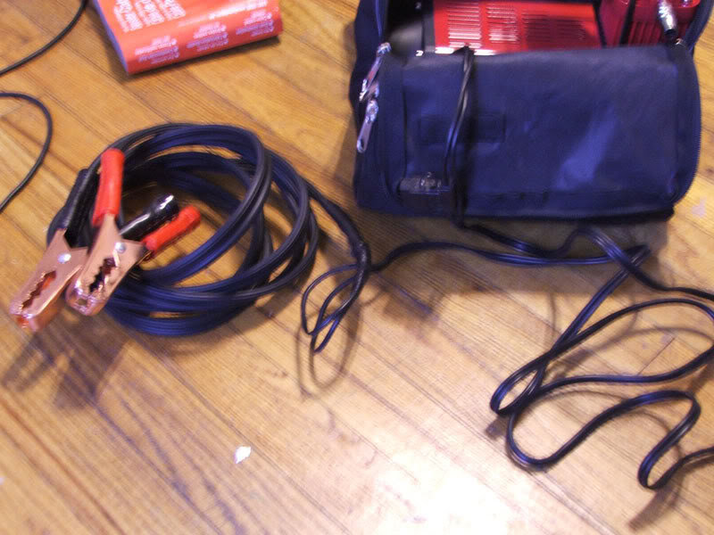

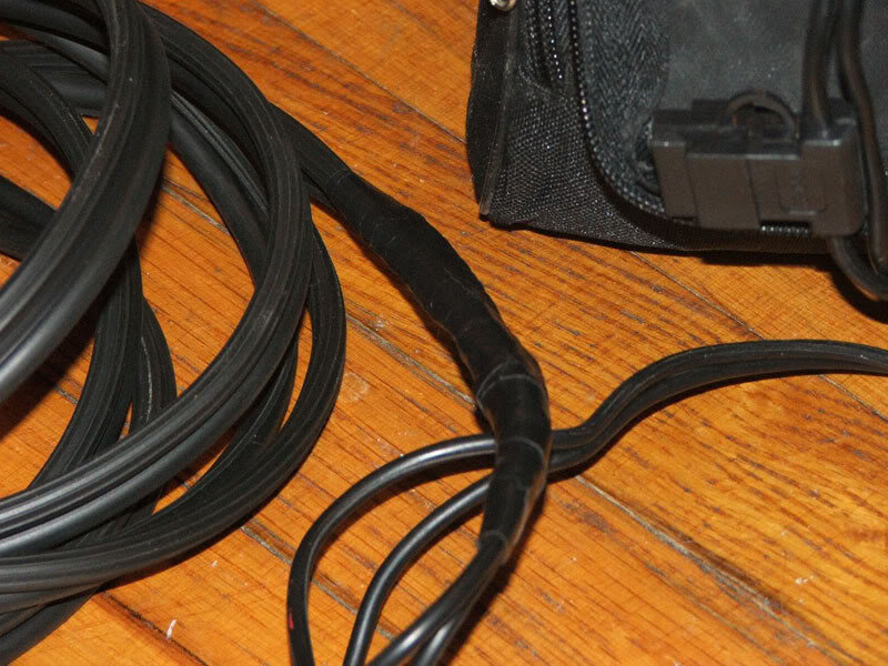

    The stock power cable isn't long enough to reach the rear tires. I bought a $10 "booster cable" set from auto zone, cut the clamps off one end, cut the clamps off the MV1050, and splice the wires together. :D Now I can reach all 4 tires with ease.
