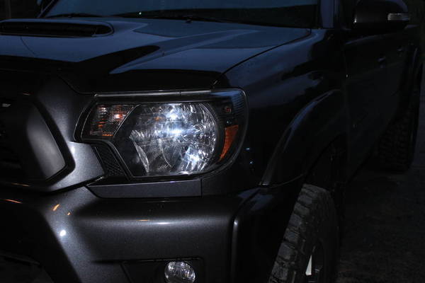

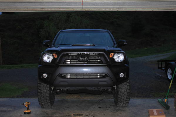

    Pretty crappy night pics. Will try to get some decent ones up tomorrow afternoon weather permitting.

    I was thinking about doing mine in the duplicolor black chrome but MGM might be sharp as well. I would love to see daytime pictures of it. I was thinking of doing the chrome grill in black chrome as well

    No daytime pics today. Nothing but clouds and rain. I'll get it inside at work tomorrow and see if I can get any better ones.

    Boone Taco, did you paint your headlights black or MGM?
    Your truck looks awesome guy
  16. Apr 28, 2013 at 11:11 AM
    #36
    Boone
    Boone [OP] Vaginas are rad.
    Jul 16, 2012
    #82731
    7,015
    Boone, NC
    Airbags deployed
    Thanks man. It's MGM. I'm pretty happy how it turned out. It does look really close to black until you get right up on it.
