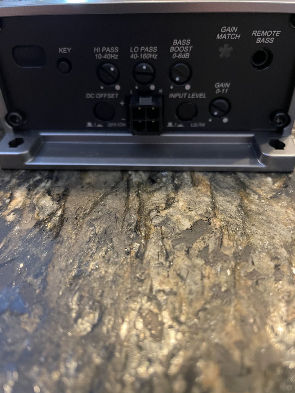

    Any suggestions for high and lo pass settings on the 500.1 and the JL Stealthbox? Kicker Key owners manual says to set it one octave below the boxes tuning frequency (i.e. if it's 40hz set it at 20hz). I don't know those specs without contacting JL, but the 10-TW3-D4 says it's range is 24-200hz.
    Crutchfield recommend 80 on Lo and 30 on High pass depending on what frequencies I wanted the sub to play. :confused:
    https://www.crutchfield.com/p_13610TW3/JL-Audio-10TW3-D4.html
    Here's where I've set it for now. DC offset on, high level input, bass boost/gain will be adjusted during initial tune.

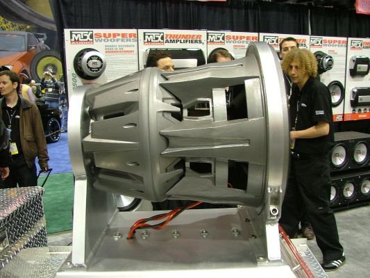

    Can't wait until it's done, To get your opinion on the sound.
    Found the perfect sub for you.

    80 and below for sub
    80 and up for the highs
    or 100/100. Whatever sounds better to you

    is there even space for a ported box?!?
    yeah, 80/80 or 100/100 and 30hz hp sounds like a good start.

    I think I've seen that before... isn't that the new thrust engine from the supersonic jet they used in the new Top Gun movie?

    Close, It's from SpaceX engine.
