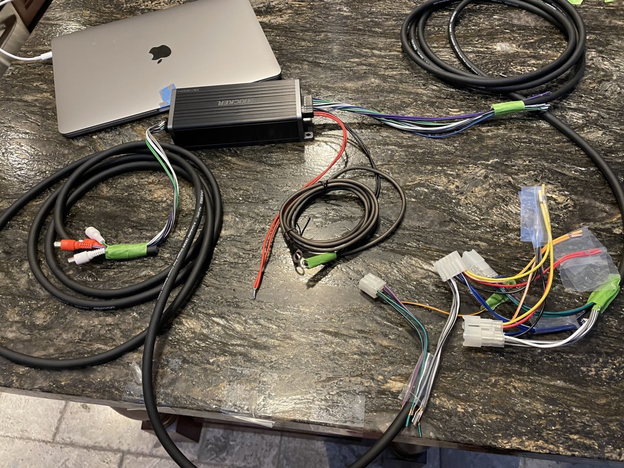

    I'm a bit hung up on my harness assembly as I'm using 9 wire (speedwire) to extend the harness and place the amp under the passenger front seat.
    I have a few questions in step 6:
    https://www.tacomaworld.com/threads...ker-key-t-harness-16-19.642415/#post-22214527
    Since I'm using an amp install kit from Crutchfield (separate power and ground), I assume we just connect the yellows together and the blacks together (far right corner of picture) as opposed to tapping those back into the separate power and ground wires of the amp install kit?
    Also, I'm adding the RCA's back in for the key 500.1 (I haven't snipped any of the RCA's in the far left of the picture here yet), so the remote wire for the 500.1 will just tap into the other 3 blue remote wires in the harness leading back into the larger key plug connector (power and ground side of key amp)? (3 blue wires on far right side of picture; connect 4th blue wire here for 500.1 amp?)

    The harness is done short of adding the extra remote wire for the 500.1. I went ahead and tied the blacks together and yellows together and ran separate power and ground. I think I'll go ahead and tap the remote wire to the others and call it good.

    @MGMDesertTaco from what I can see in the photo, everything looks good so far. Reds & blacks from the amp go to your amp install kit, and all the wires in the factory male/female harnesses attach color for color (save for the speaker lines). I don't know that I would deal with wiring up RCAs at the back of the radio... just cut off the rcas at the amp and wire up the speedwire directly, fewer connection points.
    bonus points if you solder & heatshrink everything though. its not that hard, just get a good gun and keep the tip cleaned & tinned

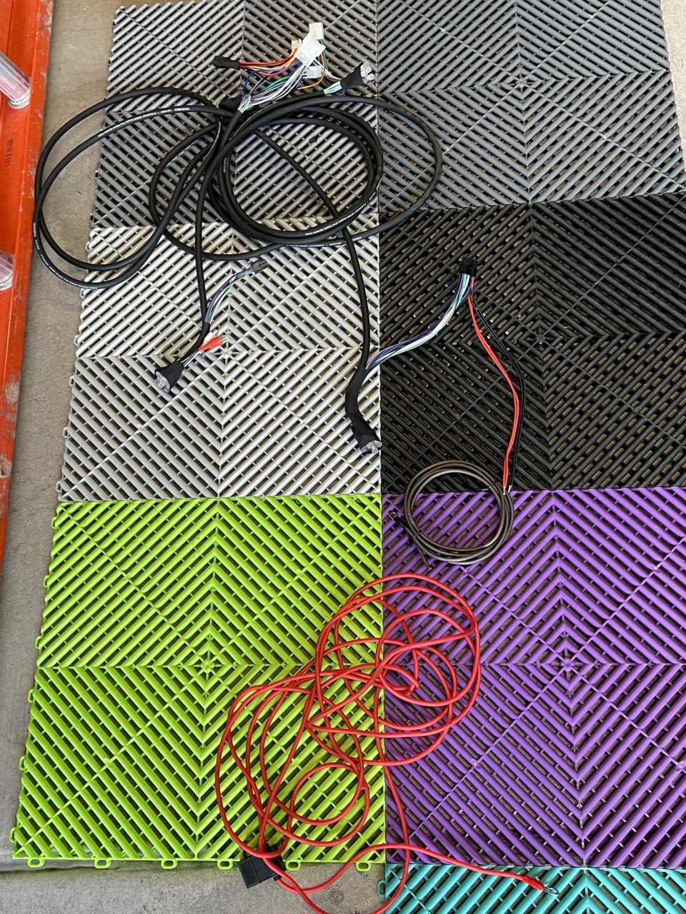

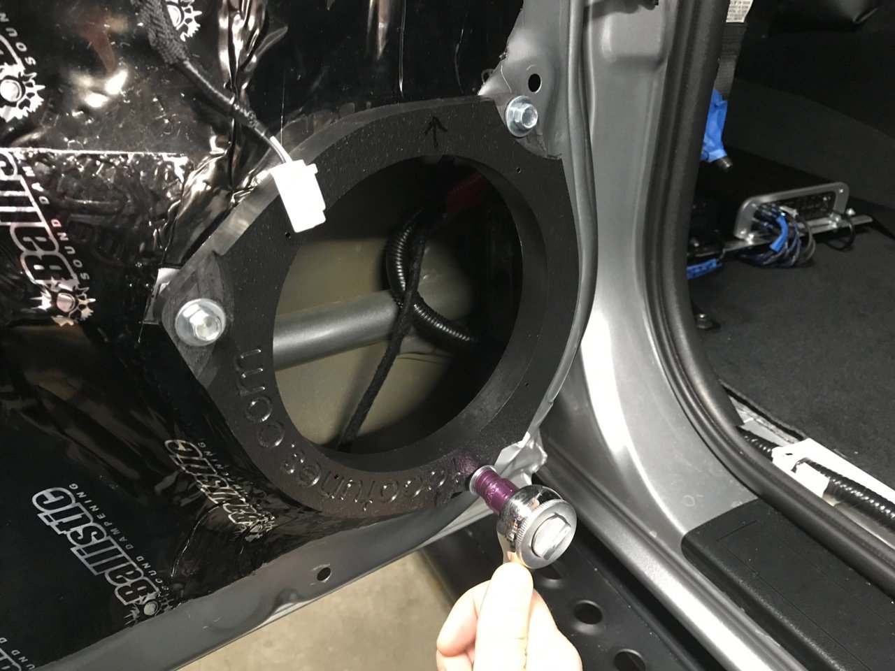

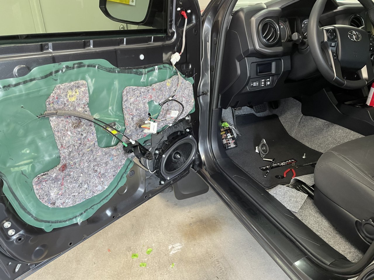

    Update,
    Grabbed some Hillman #4 x 3/8 screws for the unity 8.0 metra dash mounts and some shorter Hillman #8 x 3/8 screws for the key amps to mount on the metra abs board this morning. When I came back my extra box of SecondSkin Pro was on the front porch! :D
    All doors are deadened, all speakers and tweeters are installed and harness is complete. (I used posi twist connectors on everything and didn't solder. :crapstorm:)
    I need to do a little more research on the CDT crossover and Kicker Key settings before running the auto setup, but I will snake power through the firewall tomorrow, connect the amp, and let er rip. The truck is still in pieces. :annoyed:
    Next step will be to order the Focal RSB-250 sub and taco t****s box. The Focal RSE-165's are on closeout for $150, so I think I might just order them for sound quality comparison. :rolleyes: I'd like to upgrade the speaker mounts to the taco t****s ones as well, but this is adding up rather quickly, so I'll probably wait on those for now.
    I did have about 5-6 sheets of SecondSkin Pro left over, so that will be for the back cab wall. I really don't want to deaden the floor, but we'll see.

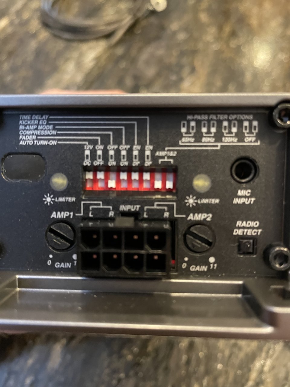

    Here's what I've got for the initial key 200.4 settings. 80hz high pass filter sound about right?
    soundman98 likes this.
  18. Jun 4, 2022 at 7:21 PM
    #98
    japjoe7
    japjoe7 Well-Known Member
    Mar 2, 2020
    #320876
    472
    Joey
    Pike County, PA
    21 Barcelona Red Sport DC AT
    looks good.
