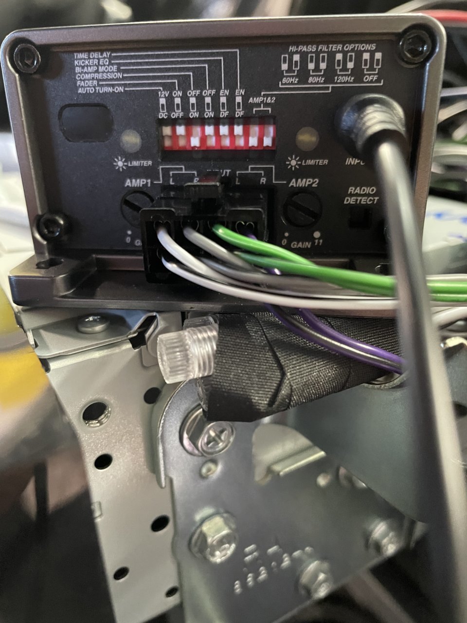

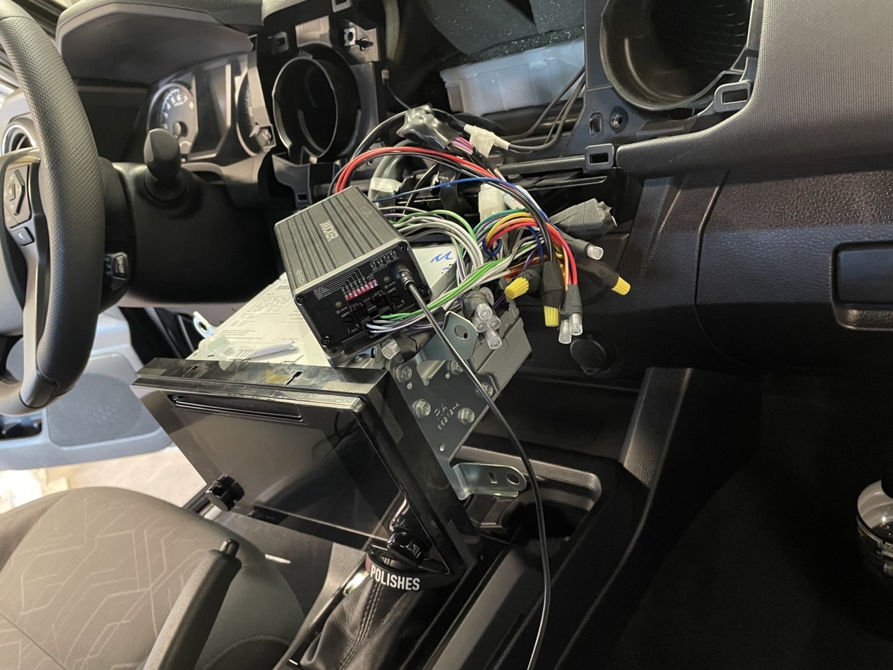

    Small setback today. The ground wire outlet was too small to accommodate the bolt for the passenger front seat and nobody had anything in stock for the 12 awg ground wire in Crutchfield's amp kit. Also, after pulling the whole truck apart I couldn't figure out how to remove the center console to route the power cable and speedwire. :facepalm:
    I ended up pulling the harness apart and temporarily wiring it up short so I could at least test it and so everything including the amp tucked in behind the radio. I ran the setup pink noise via usb drive and everything seemed to go as planned, but upon doing the gain adjustment none of the gain lights would illuminate. I left them all the way down and played around with some test music.
    It sounded like crap, like the amp wasn't putting any wattage out to the speakers and the amp was getting extremely hot (like too hot to touch). I disconnected the harness and the amp and put the interior and seats back in the truck so I can at least drive it.
    What the frack did I do wrong? Is my amp defective? :annoyed:

    my first suspicion is that the amp had a terrible temporary ground. you made the amp constipated with power.

    are you sure your wiring is good? because personally, that level of confidence is where i usually muck it all up(i have come back a day later to this exact scenario after calming down and found something really stupid more than once)!
    are your gains all the way down yet? go 1/4-turn up, and re-do the pink noise testing. many amps are set so all the way down is nearly off/zero amplification. triple check your high level/low level input setting as well
    the cdt's are 80wrms. there's no way that an additional 30wrms from any other amp is the difference between "80's boombox" and "totally worth all this hassle". way too many successful key amp installs for me to believe that. yes, it's possible the amp is bad, but still feel like that's a long shot..
    looking at the cdt site now, the 6x9's are 3-ohm drivers. usually the nominal rated resistance is somewhat optimistic, maybe they're closer to 2ohm, and it's an issue with the 4-ohm minimum key amp?
    oh, and in the pic, i see you're running a 80hz high pass--set the key crossover to bypass temporarily during this testing.

    I've got a multimeter, but haven't been inclined to pull the door panels off. It was 104 today (108 in the garage) and will be 111 or so this weekend, so motivation to go outside isn't there right now. I'm ready to move to a nice lake somewhere and buy a wake boat. :rofl:AZ Summers suck. :bananadead:
    John from CDT stated "These 6x9" are nominal impedance 4ohm with a voice coil DC resistance 2-3 ohms." I think this might be part of the problem. Maybe someone can explain that better to me?
    Wiring is still jerry rigged behind the dash (power and ground) for now. I've ordered a new set of metra 71-1761/70-1761 and will redo the harness. I've also ordered an amp wiring kit for the key 500.1 and the Focal RSE-165's for the front doors/dash.
