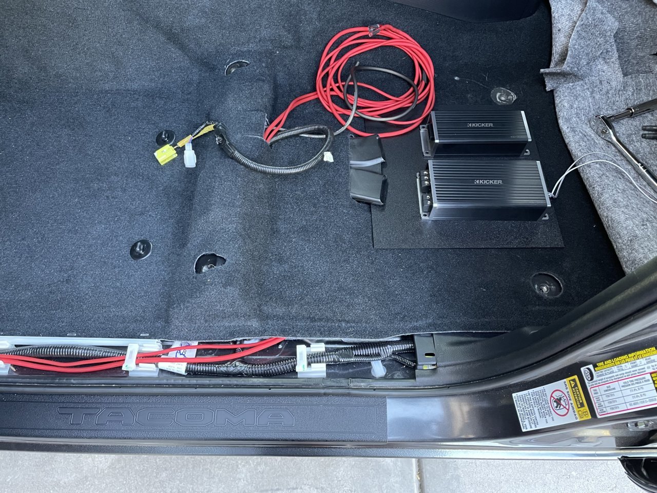

    I watched @5nahalf 's android run through on his build page last night. I do like ability to watch movies and YouTube. :anonymous: However, I'm not sure that's what I want. I've got a few stereo shops near me and I'm going to see what they have in stock for apple car play units and see if I can play around with a few. The Pioneers are nice, but the reviews have a lot of negativity about CarPlay dropping connections.
    The audio control 5.1300 is sweet, but I'd need to run all new wire for 100w. The DSP software looks intimidating too. I do like the JL XD700/5v2 and JL VX700/5i (DSP). Alpine's are solid choices too. I agree with @TurboGT that 75w x4 for the speakers and 300w for a sub is the sweet spot or at least for me.
    I've also been looking at Mr. Marv's sub box options on his instagram page as well as the JL Stealthbox and the JL10W1V3-2. A lot of Mr. Marv's builds are based upon the 10TW3-D4. The W1 would require a pretty deep box. 1 10" would be plenty for me. :notsure:
    https://www.jlaudio.com/products/10w1v3-2-car-audio-w1v3-subwoofers-92080
    https://www.jlaudio.com/collections...ducts/10tw3-d4-car-audio-tw3-subwoofers-92184
    For now I've mocked up my stick amps :D...
