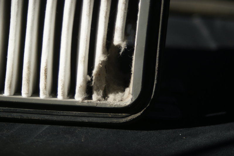

    Well, a mouse, anyway. I went out earlier for my regular Sat. morning oil level/tire pressure check and while I had the hood up I decided to take a quick look at the air filter, not something I usually check except at oil change time. Don't really know why I did it this time but I'm glad I did.
    I'll pause now while everyone goes out to check their filters... Back now? Good, here's what I did to, hopefully, keep this from happening again.

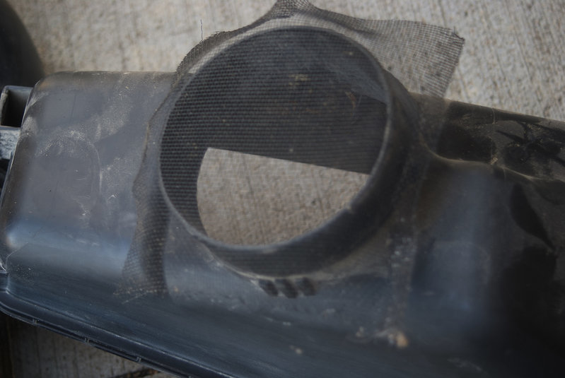

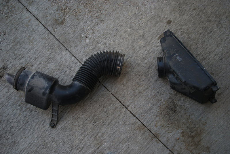

    I took some aluminum window screen material and sandwiched it between the air filter housing and the hose feeding it. I don't know for sure this will keep the mice out since they will chew on just about anything but it will at least slow them down a bit... maybe.
    You can be sure that, at least for a little while, I'll be taking a look at the filter every time I check the oil.DSC00380.jpg

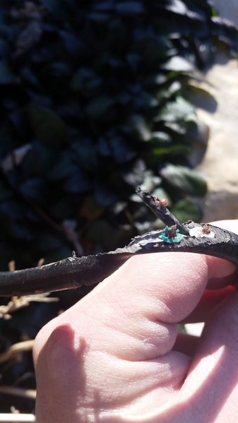

    F#cking mice. I have a pond behind my garage with a pump that feeds a small water fall. It stopped running a few days ago and started checking things out. They had completely chewed through the power cord. I have no idea how they didn't get fried when going through the hot, neutral and ground.
